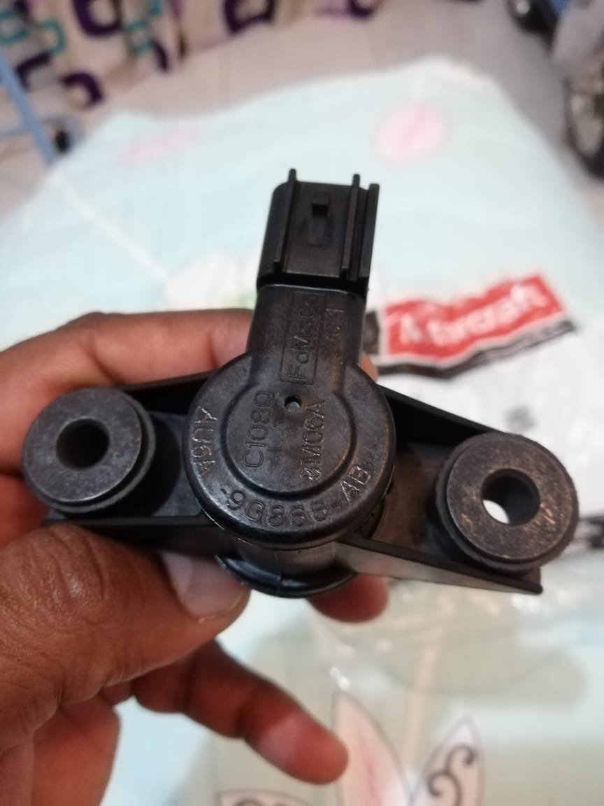

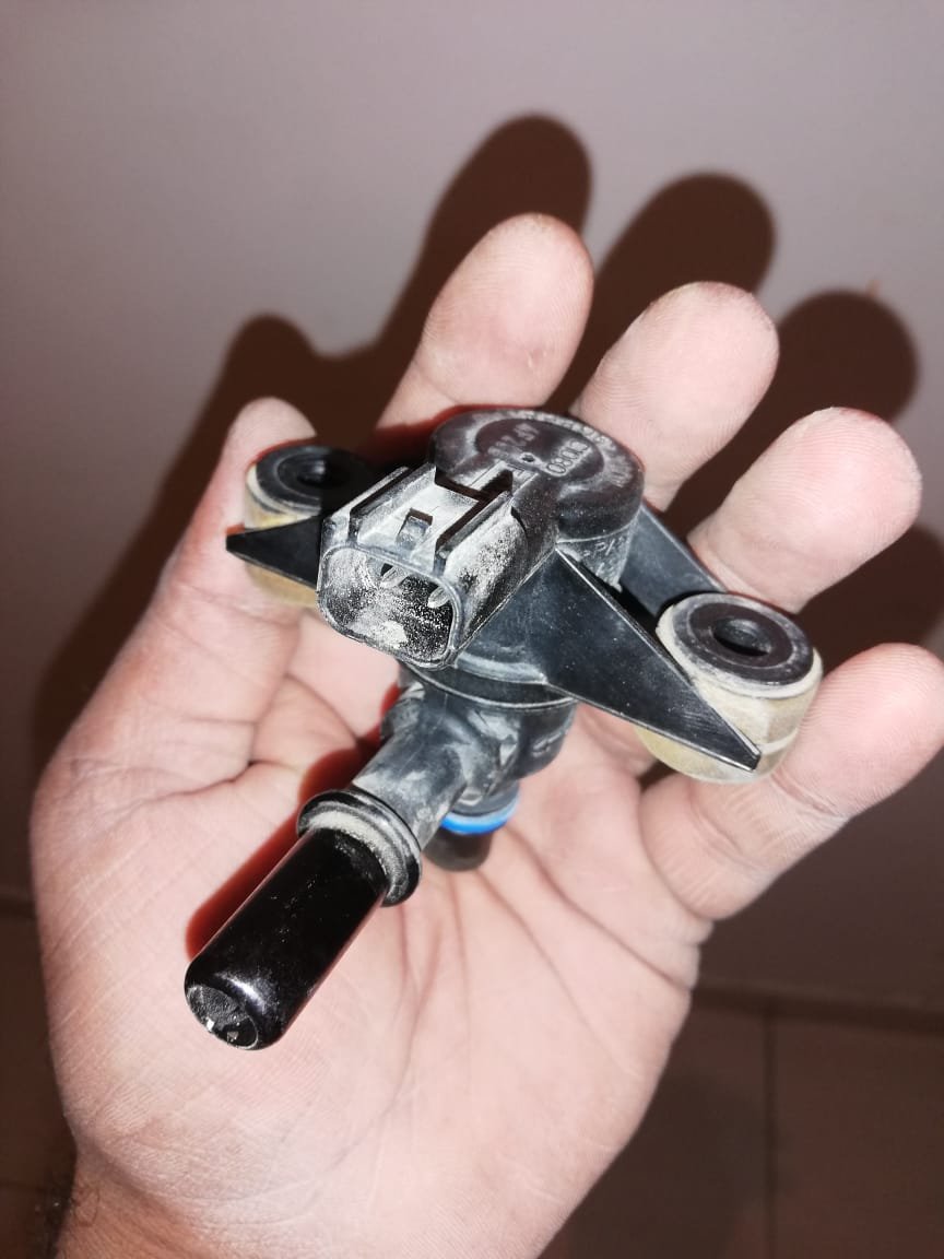

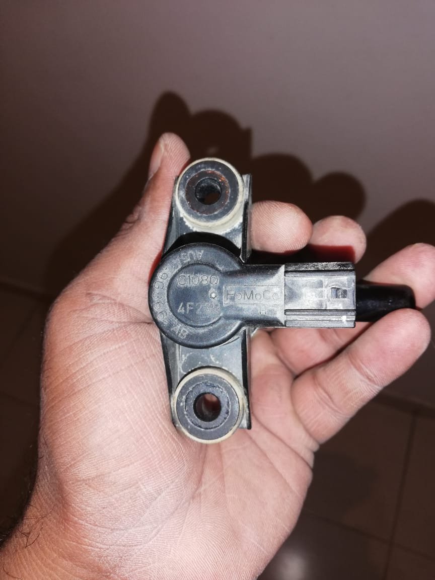

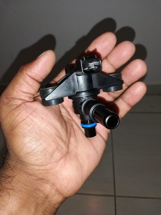

Jins Posted February 22, 2020 Report Share Posted February 22, 2020 Just went through the same issue in my 2013 SE and it was the purge valve. Initially noticed low/varied RPM and engine stall, difficult to start after refueling. I changed my EVAP purge valve and sorted the problem. Quote Link to comment Share on other sites More sharing options...
