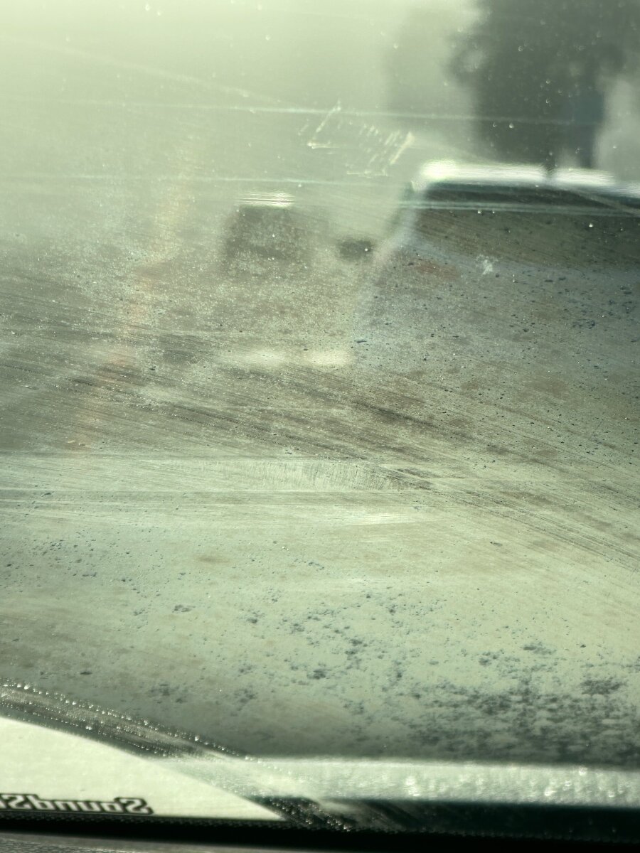

I bought a used 2011 Edge limited with 63K miles on it. I have been trying to clean the windshield of a terrible haze problem. The outside seems to have some sort of clear coat (possibly a very hard wax) on it that is wearing away. So I tried basic than more and more aggressive cleaning efforts. I finally used a razor and a film was coming off in many of the very hazy areas. Long story short, it is now perfectly clean inside and out - I mean mint. (It took many hours of work). All that is left are some tiny road pebble marks as I would expect.
But when it is dark, any light I see has a very thin haze to it that is evenly distributed around the light source. Street lights, oncoming headlights - anything. In daylight it is perfectly clear. I shine my 1000 lumen flashlight through it and I see it. It seems to be in the glass (or maybe the plasic sandwiched in there.

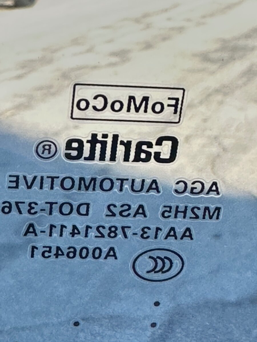

About 2 mos ago I bought pretty much the exact same car - '11 Limited AWD w/ about 65k miles. I have not noticed any haze or film on the windshield. I know there are some folks that wax the windshield when they wax the car (we used to do that as teens) so maybe that was it. Also, I Rain-X my car windshields once a year but that never leaves a haze.
The p/n printed on my windshield is AA13-7803100-A. Don't know the significance of the first position being an 'A' rather than a 'B'. My Edge had the 301a package so it has pretty much every bell and whistle available - would there be a difference in the windshield?

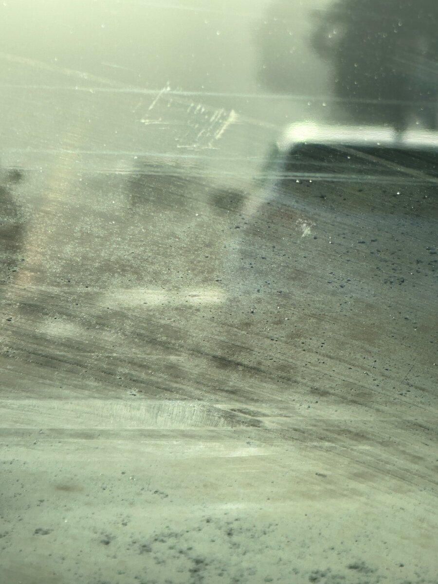

I too have the 301a package plus the vision package (which probably adds the rain sensor?) I've always used Rain-X on my windshields, but I just put in on after cleaning the coating off. I saw that the coating had worn through in some areas and that's how I realized it had a coating. I literally scraped it off and the surface is nice again. The Rain-X application came out great yet the haze that I see is still there. (before removing the coating, the outside was all scratched and really terrible where the wipers travel.)
The haze is extremely fine but I don't think it is on either surface (inside or out). If you do notice this phenomenon at night, please let me know.

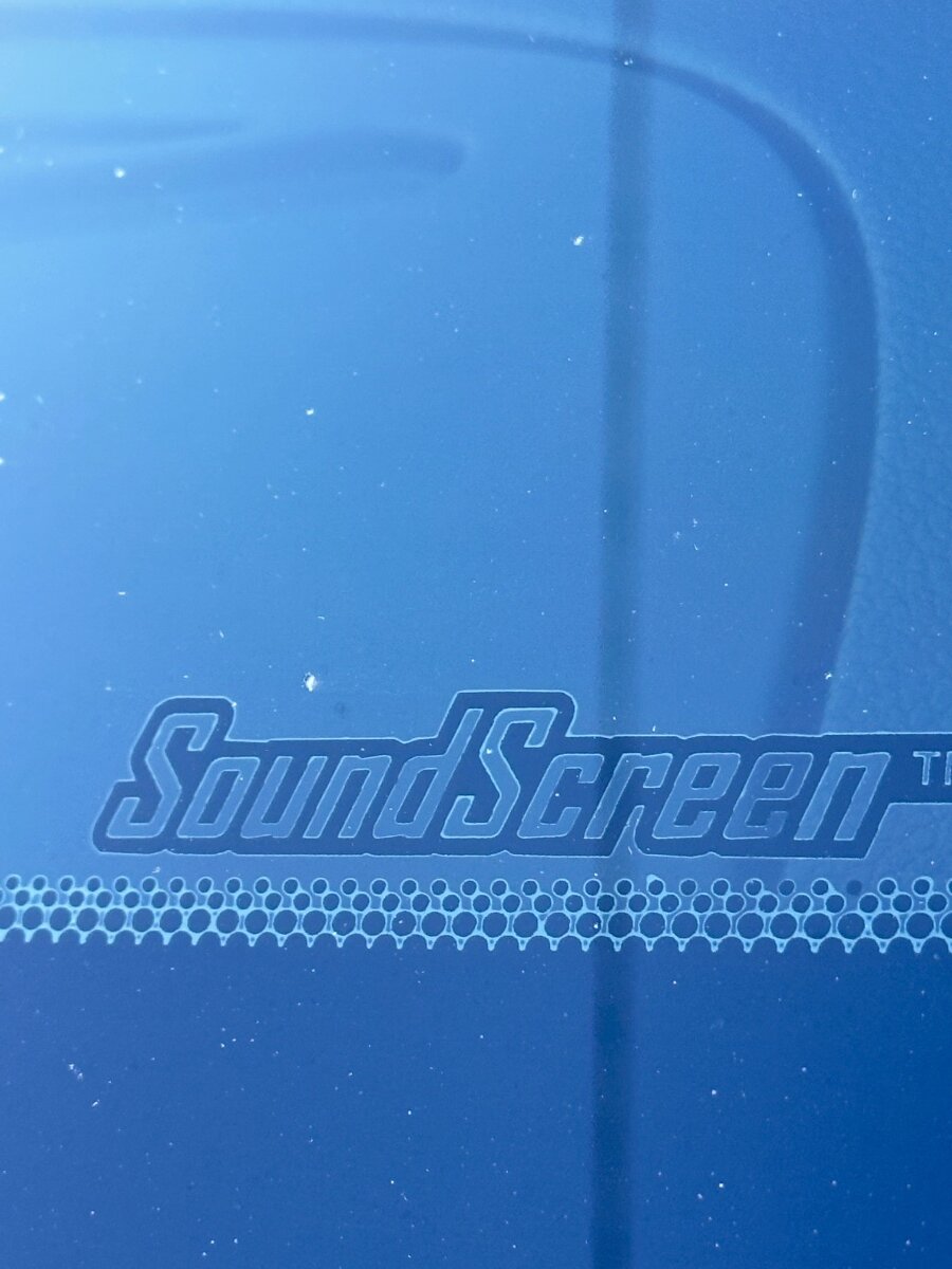

It literally says 'SoundScreen'. I've seen pictures on the web and here's one on this forum: http://www.fordedgeforum.com/topic/9081-2012-road-noise/?do=findComment&comment=73133. I notice that the part number is the same as mine: BA13-7803100-A but it says "SoundScreen" right on it. Mine looks like yours (your 'AA13' is the non-rain sensor vs. 'BA13' with the rain sensor I think) but just as you describe without the word SoundScreen. The SoundScreen version is using the same part number as mine? This is somewhat confusing.
Are there any Ford Reps on this forum that can explain these part number as Soundscreen or not?
Here is what my windshield part number looks like:

I was assured by Carlite tech support that based on my VIN number, my 2011 Edge Limited vehicle was originally built with what they call the DW01845 GTY and thus should have the special sound absorbing vinyl in the glass and the trademarked logo “Soundscreen” at the bottom. It's possible that someone replaced it with a non-OEM windshield at some point. I can't find any record of the WS being replaced however.
So I think the lesson here is, if you get your windshield replaced, be sure to tell them you want the OEM windshield that came with your car - in my case it is the Carlite DW01845 GTY part.
