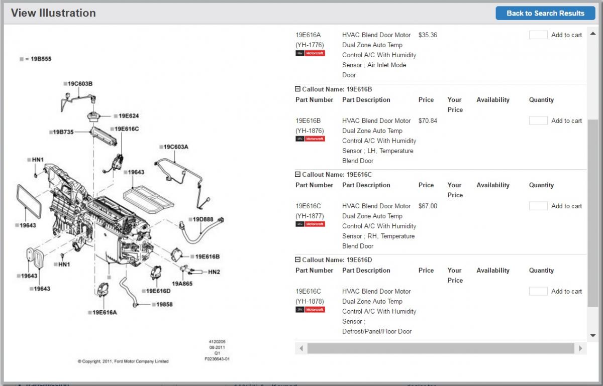

Thomas Edwin Worthy Posted November 16, 2016 Report Share Posted November 16, 2016 I have a 2014 Ford Edge with dual temperature control. As it has started to turn a bit cooler, I attempted to adjust the temperature in the car. I discovered I can only blow cold air. This is the same for both the driver and passenger side. I have read that I most likely need to replace the actuator, but there appear to be 4 of them based upon the parts list form Ford. Does anyone have an idea as to which one I need to replace? Thanks!!! Quote Link to comment Share on other sites More sharing options...
omar302 Posted November 16, 2016 Report Share Posted November 16, 2016 Is the issue on both sides, driver & passenger? If yes, it's highly unlikely to be the actuator as it would mean that both (RH & LH) failed at the same time. Being a relatively newish car, it is probably an electronic thing. Try disconnecting the car's battery for 10-15 minutes to see if it resets itself. 1 Quote Link to comment Share on other sites More sharing options...
WWWPerfA_ZN0W Posted November 16, 2016 Report Share Posted November 16, 2016 For the EATC systems, there are two temperature blend doors, one on the drivers side, one on the passenger. The remaining two are probably to direct airflow. Since the problem afflcts both sides of the cabin, it may be the climate module also. Just keep in mind. Quote Link to comment Share on other sites More sharing options...
