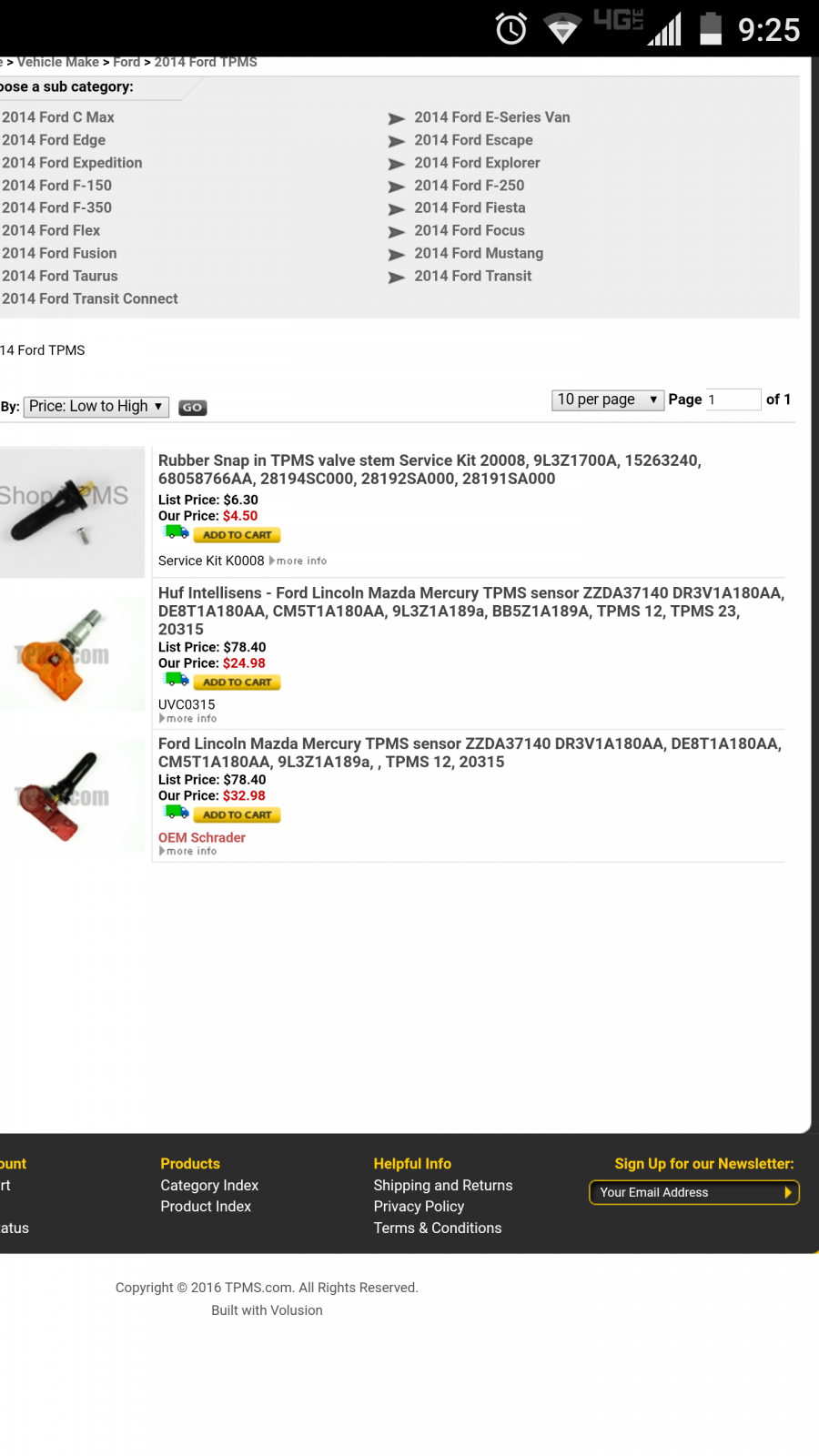

lildisco Posted November 15, 2016 Author Report Share Posted November 15, 2016 Turns out that there must be a difference between the 2015's & 2016's. Sensors replaced with different new ones & sync'd up no problem. Old TPMS part # reads DE8T-1A180-AA a quick search on TPMS.com indicates its for a 2014 http://www.tpms.com/2014_Ford_TPMS_s/6545.htm So, does anyone want to buy some genuine OEM Ford TPMS sensors? 1 Quote Link to comment Share on other sites More sharing options...
