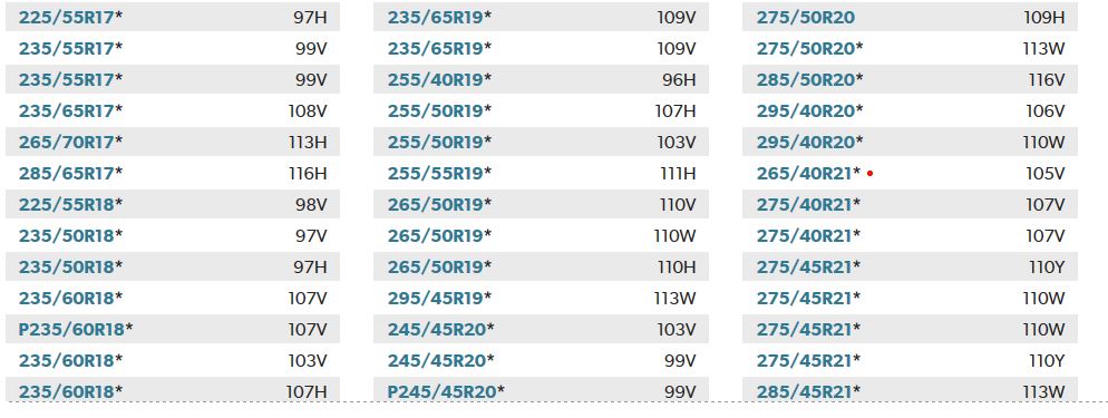

akirby Posted November 4, 2016 Report Share Posted November 4, 2016 To comment on your article from PM, yes the manufacturer can specify slight compound changes but they can't change the load setting of the same offering in the same make/model (it would have to be an entirely different tire!). So you don't believe you can have the exact same mfr and model of tire in the same size with different load ratings? Quote Link to comment Share on other sites More sharing options...
Burrcold Posted November 4, 2016 Report Share Posted November 4, 2016 Of course they can but the load rating from a "manufactured set" versus the "OEM set" you buy off the shelf is not going to be different. They might have a slight compound difference like was mentioned in the article but not load. If you can show me an example of this I will STFU right now (but also be quite scared if it's even possible to having varying load ratings for the same car/tire brand/make). Quote Link to comment Share on other sites More sharing options...

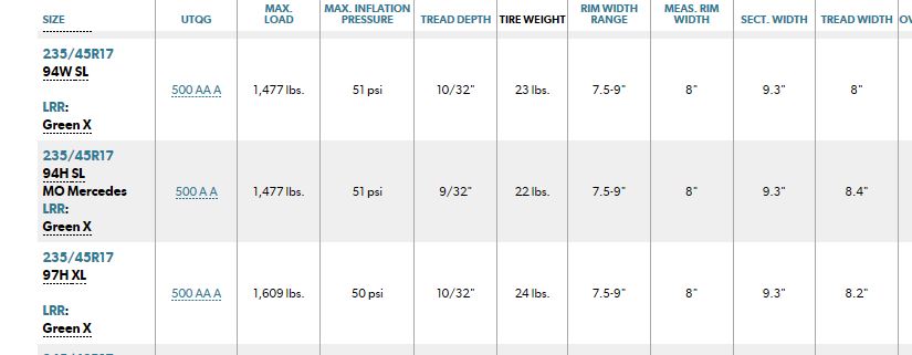

akirby Posted November 4, 2016 Report Share Posted November 4, 2016 Michelin Primacy MXM4 Pirelli Scorpion Verde All Season Quote Link to comment Share on other sites More sharing options...
Burrcold Posted November 4, 2016 Report Share Posted November 4, 2016 I'm not sure what your point is. The load is identified as being different. I'm saying that if the OEM tire had a different load versus the OEM off the shelf (purchase as a replacement) that would be scary which is why I said same "CAR/tire brand/make". If the tire is the same size but different load, the description will say "Bentley" or "Porsche" or "Tesla" beside it. Since all of these cars can have the same required tire and size but different load (obviously). Quote Link to comment Share on other sites More sharing options...
Burrcold Posted November 4, 2016 Report Share Posted November 4, 2016 (edited) Example from your sheet 295/40/R20 has two different load ratings. If you have a car that requires this size, if you used a site like Tirerack and put your vehicle details in, they wouldn't give you both as an option. It would be known which vehicle each load type was made for. Edited November 4, 2016 by Burrcold Quote Link to comment Share on other sites More sharing options...
Burrcold Posted November 4, 2016 Report Share Posted November 4, 2016 Example. Notice the notation of what vehicle it's for? Quote Link to comment Share on other sites More sharing options...

akirby Posted November 5, 2016 Report Share Posted November 5, 2016 (edited) Nobody said they designed a tire from scratch every time. It's not worth arguing over the degree to which they customize the tires. The important thing is there can be different versions of the same tire so be sure to check your OEM tire specs. Edited November 5, 2016 by akirby Quote Link to comment Share on other sites More sharing options...
