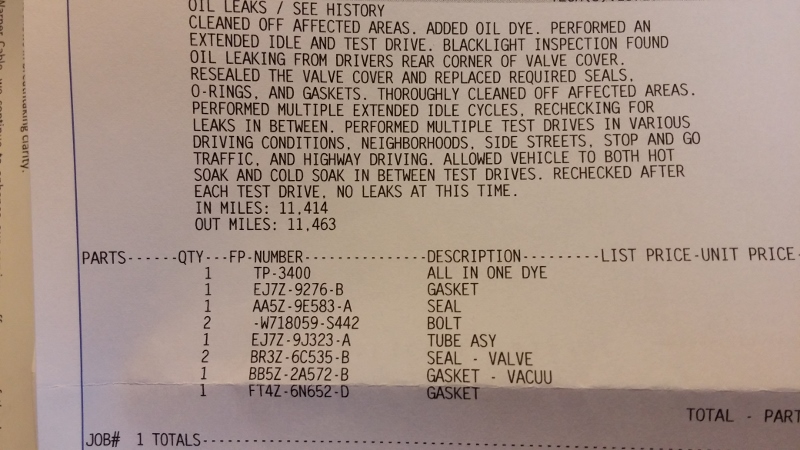

dy2016 Posted October 27, 2016 Author Report Share Posted October 27, 2016 (edited) The 2nd dealer refused to get involved. I had no choice but to return to the original selling/servicing dealer. Got the car back yesterday, from the original selling/servicing dealer. Attached is a picture of the parts list. Some of the parts listed I question (bolts?) but if it's fixed it's fixed. I'll just assume initially a random issue that was handled poorly the first time. This trip was 4 days, vs the initial visit of 11 days. Edited October 27, 2016 by dy2016 Quote Link to comment Share on other sites More sharing options...
akirby Posted October 27, 2016 Report Share Posted October 27, 2016 So it was just a simple valve cover leak that was misdiagnosed the first time. Quote Link to comment Share on other sites More sharing options...
dy2016 Posted October 28, 2016 Author Report Share Posted October 28, 2016 The valve cover was done during the 1st trip, along with timing cover and front crank seal. (there is no valve cover gasket listed on the 2nd invoice. It was on the 1st) I'll never know the source of the original leak, but the 2nd trip they say was the valve cover - that was done incorrectly the 1st time. It appears to be fixed. If any other issues come up, they will be done at a different dealer. 1 Quote Link to comment Share on other sites More sharing options...
