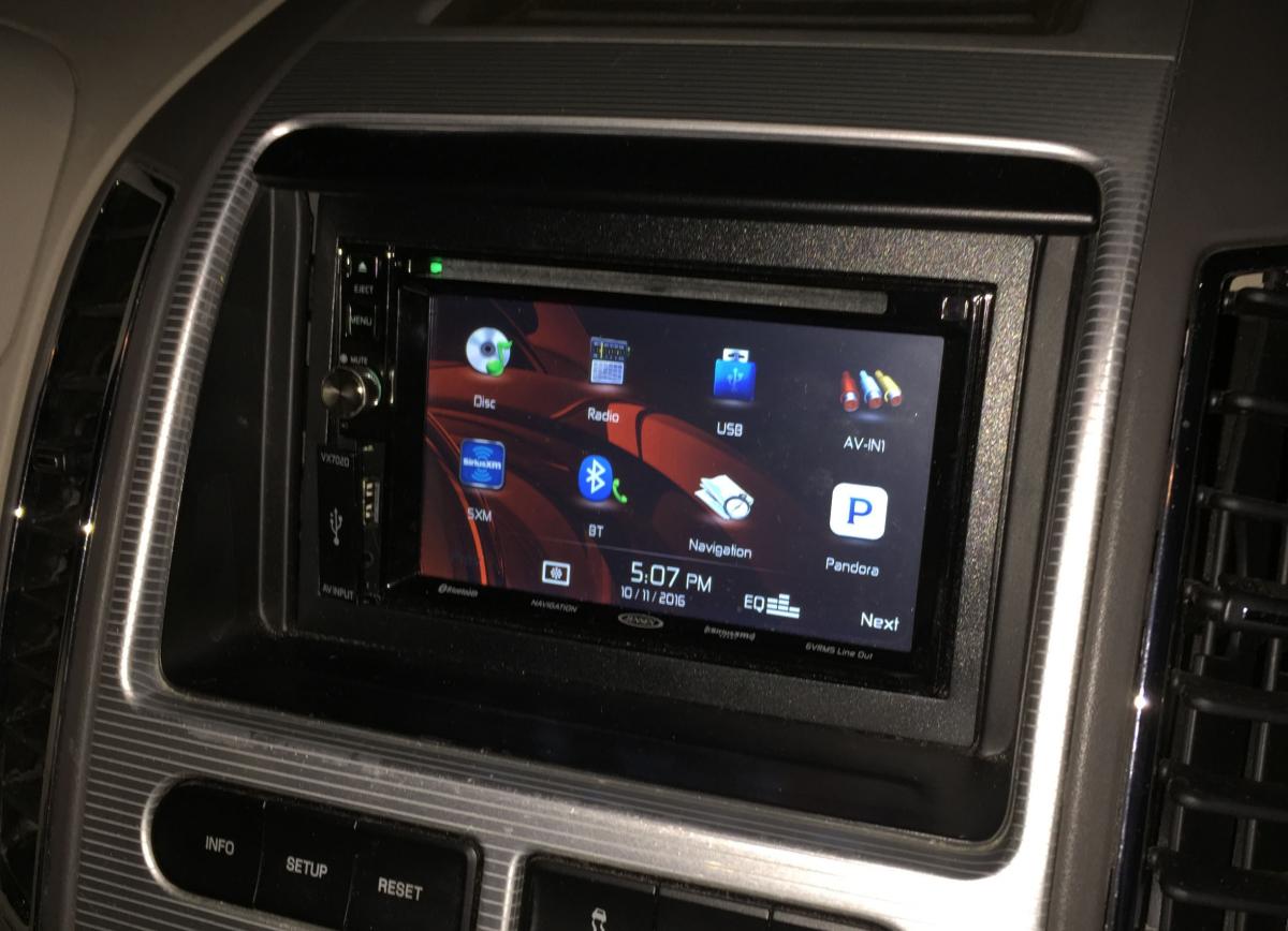

PaulSchott Posted October 11, 2016 Report Share Posted October 11, 2016 If you're worried about aftermarket looking bad you really should get your stuff from Crutchfield. They cost al little more but their support and installation accessories are first rate. I got a Jensen unit from them to replace the original 6 disk player. Great Nav, great phone blue tooth, without voice activation. the Pandora option needs to hooked up with your I phone plug which I don't really like, but I have this head unit in the car for over a year and it has been flawless. I think they have updated it since I got it. 1 Quote Link to comment Share on other sites More sharing options...
enigma-2 Posted October 12, 2016 Report Share Posted October 12, 2016 Nice looking display. Sometimes it pays to pay more for better quality. ? Quote Link to comment Share on other sites More sharing options...
