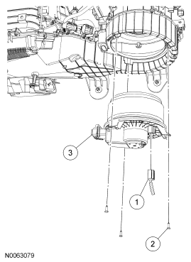

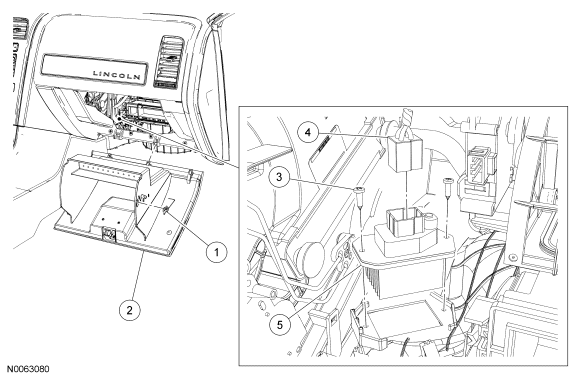

WWWPerfA_ZN0W Posted October 5, 2016 Report Share Posted October 5, 2016 Could be the motor, could be the resistor. Usually it is the motor. Just make sure you can return it in case it is not. 2008 Ford Edge BLOWER MOTOR installation.pdf 1 Quote Link to comment Share on other sites More sharing options...
