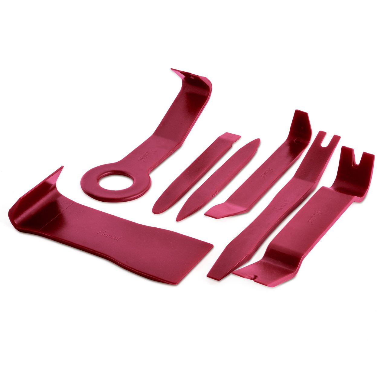

RedEdge16 Posted December 17, 2016 Report Share Posted December 17, 2016 Well THAT (replacing the USB hub in my Edge so I could have Car Play) took longer than expected. Word to the wise who plan to swap USB hubs -- it looks deceptively easy. Pop out the old one, plug in the new one and pop it back in. With new trim tools and detailed advice from this thread and from threads on other forums, I thought I was ready, but that hub is in there really, really tight. I essentially had to destroy the old hub to get it out -- it came out in two pieces. (I'm fairly handy with tools, but I even called a local dealer and set up a Monday appointment to have them do the swap, just in case.) If you don't mind destroying the old hub, it's easier I guess. LOL. Fortunately, no damage to the cubby area, except the two little round bumpers in the front corners came out. Pix attached of the old and busted hub, as well as how the new one looks. Good luck peeps! Sounds like the Edge is a royal pain just like the MKC to get to the USB hub. I think if you had these it would have worked better. I originally purchased the larger "plastic" ones from harbor freight so i got these instead: http://www.harborfreight.com/4-piece-pick-and-hook-set-66836.html What would have worked best was some kind of "puller" that, once you have the module lifted up, you could then grab each side and pull. Trying to leverage it out from underneath was tough. That said, it was worth the effort, as I had CarPlay on my last car ('16 Accord Coupe) and used it daily. Now, if I can just figure out why the CarPlay map contrast is so light.... I wish Ford gave us access to a contrast setting for the screen. Quote Link to comment Share on other sites More sharing options...

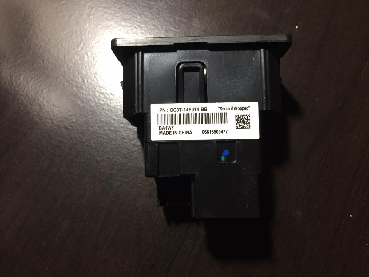

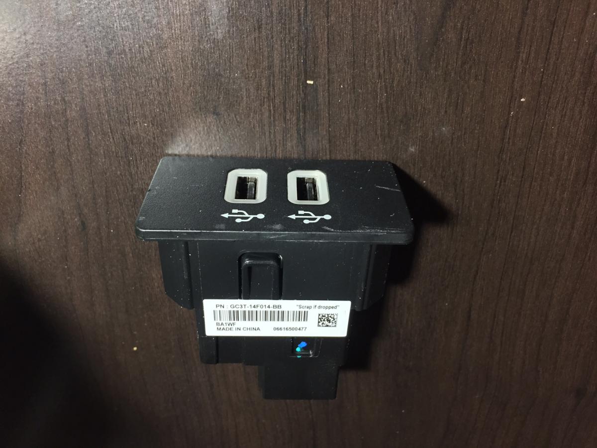

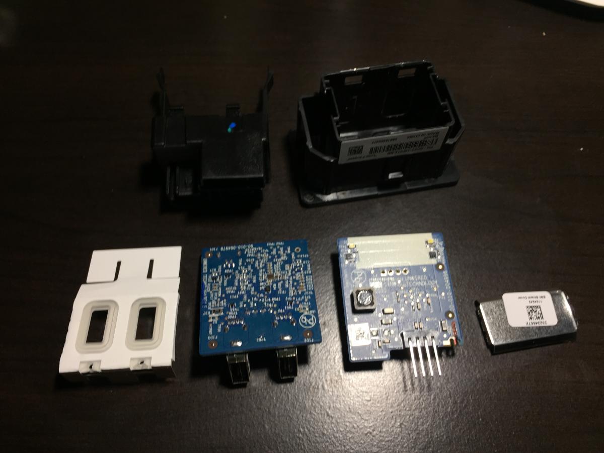

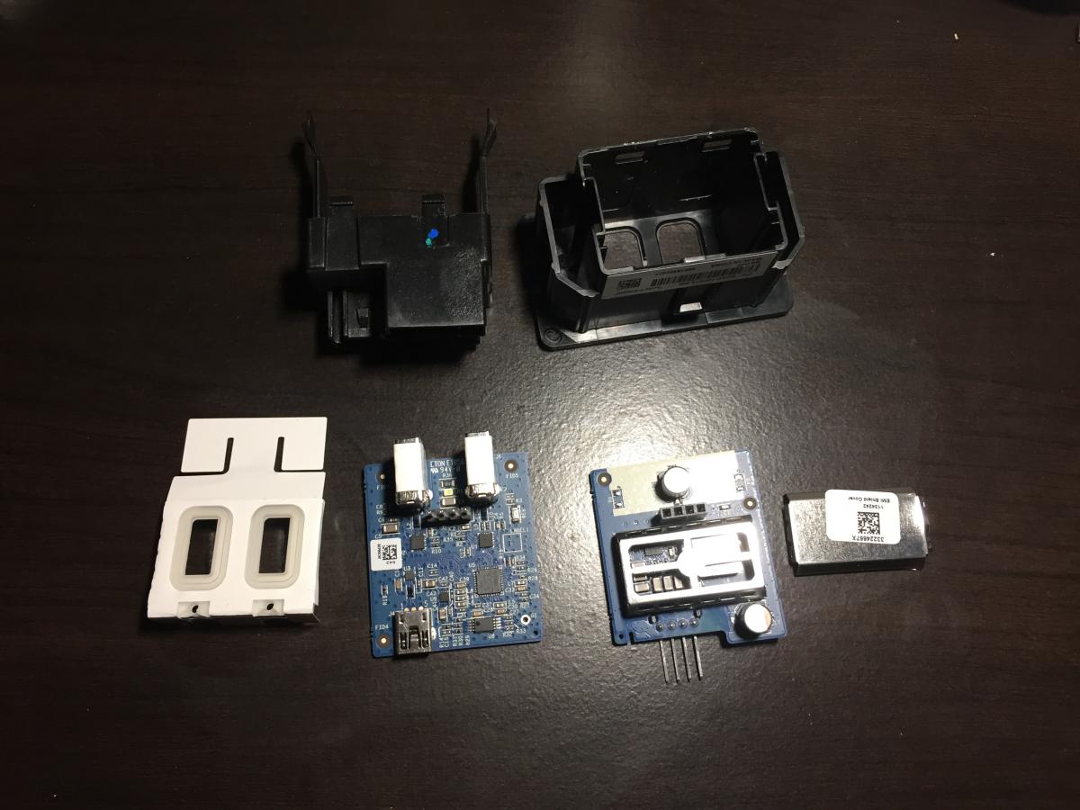

t0lkman Posted December 18, 2016 Report Share Posted December 18, 2016 (edited) It took me around 20 minutes to replace the hub. The one I have received has white light (Lincoln version of the apple certified hub).I really liked blue color, so I ended up "hacking" it a little bit, I used blue film from the red-blue glasses and put it inside the module.Now the module and the light looks authentic like the original one I used auto trim removal tools (the most right one) and the module came out with help of my fingers.Attaching some pics of the original (old) module for the records. Edited December 18, 2016 by t0lkman 2 Quote Link to comment Share on other sites More sharing options...

Vhalen50 Posted December 19, 2016 Report Share Posted December 19, 2016 Well THAT (replacing the USB hub in my Edge so I could have Car Play) took longer than expected. Word to the wise who plan to swap USB hubs -- it looks deceptively easy. Pop out the old one, plug in the new one and pop it back in. With new trim tools and detailed advice from this thread and from threads on other forums, I thought I was ready, but that hub is in there really, really tight. I essentially had to destroy the old hub to get it out -- it came out in two pieces. (I'm fairly handy with tools, but I even called a local dealer and set up a Monday appointment to have them do the swap, just in case.) If you don't mind destroying the old hub, it's easier I guess. LOL. Fortunately, no damage to the cubby area, except the two little round bumpers in the front corners came out. Pix attached of the old and busted hub, as well as how the new one looks. Good luck peeps! Went through about the same as you. Maybe i wasnt experienced enough on how to pry these things out, but it took me a good while. I initially started from the left as well and eventually got the bottom to come up but couldnt get the top. Probably spent about an hour or so before i finally gave it a good pull and it yanked out with the help of the trim tool with the circle on it. Didnt mar it up as much as yours did, but if i would have used something other than at trim tool, it would haha. Quote Link to comment Share on other sites More sharing options...
RedEdge16 Posted December 19, 2016 Report Share Posted December 19, 2016 Went through about the same as you. Maybe i wasnt experienced enough on how to pry these things out, but it took me a good while. I initially started from the left as well and eventually got the bottom to come up but couldnt get the top. Probably spent about an hour or so before i finally gave it a good pull and it yanked out with the help of the trim tool with the circle on it. Didnt mar it up as much as yours did, but if i would have used something other than at trim tool, it would haha. Glad to know I'm not alone (and I'm usually pretty good about these things). The old USB hub was in fine shape until I finally took needle-nosed pliers to the two USB ports to get a better grip to yank it out. By that point I figured I didn't need the old one and it was in rough shape already. ;-) I've seen other Ford owners on different message boards having mixed degrees of success getting these hubs out, too. I'll take it as good sign on Ford's part that the hub fits so tightly. The new one works like a charm and I'm glad I don't have to wait for Ford to roll out the update/USB hub combo sometime "soon." I'll be curious what dealers charge for this.... Quote Link to comment Share on other sites More sharing options...

Jlan Posted December 22, 2016 Report Share Posted December 22, 2016 Thank you all for the incredibly useful information. I was able to successfully install the GJ7Z-19A387-B that i ordered from Walt Sweney. Just wanted to add a tip to replacing the module. I had ordered the trim tools as well and struggled for a bit. i was able to remove the bottom portion, but could not get the top to release. then it dawned on me that the back side had the little shelf area, and is accessible from behind. Simply remove the side console trim, then pull back the trim behind the module. you can then press the release tab on top and it will pop right out. Attaching a few pictures. 2 Quote Link to comment Share on other sites More sharing options...
Ray Heath Jr Posted December 22, 2016 Report Share Posted December 22, 2016 Thank you all for the incredibly useful information. I was able to successfully install the GJ7Z-19A387-B that i ordered from Walt Sweney. Just wanted to add a tip to replacing the module. I had ordered the trim tools as well and struggled for a bit. i was able to remove the bottom portion, but could not get the top to release. then it dawned on me that the back side had the little shelf area, and is accessible from behind. Simply remove the side console trim, then pull back the trim behind the module. you can then press the release tab on top and it will pop right out. Attaching a few pictures. I did that also, allowed me to run my USB Cable out the back also. Quote Link to comment Share on other sites More sharing options...
