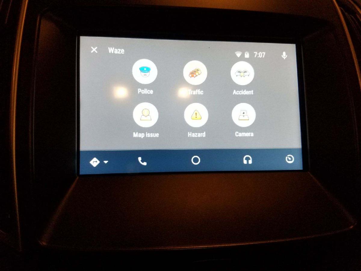

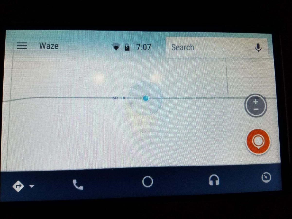

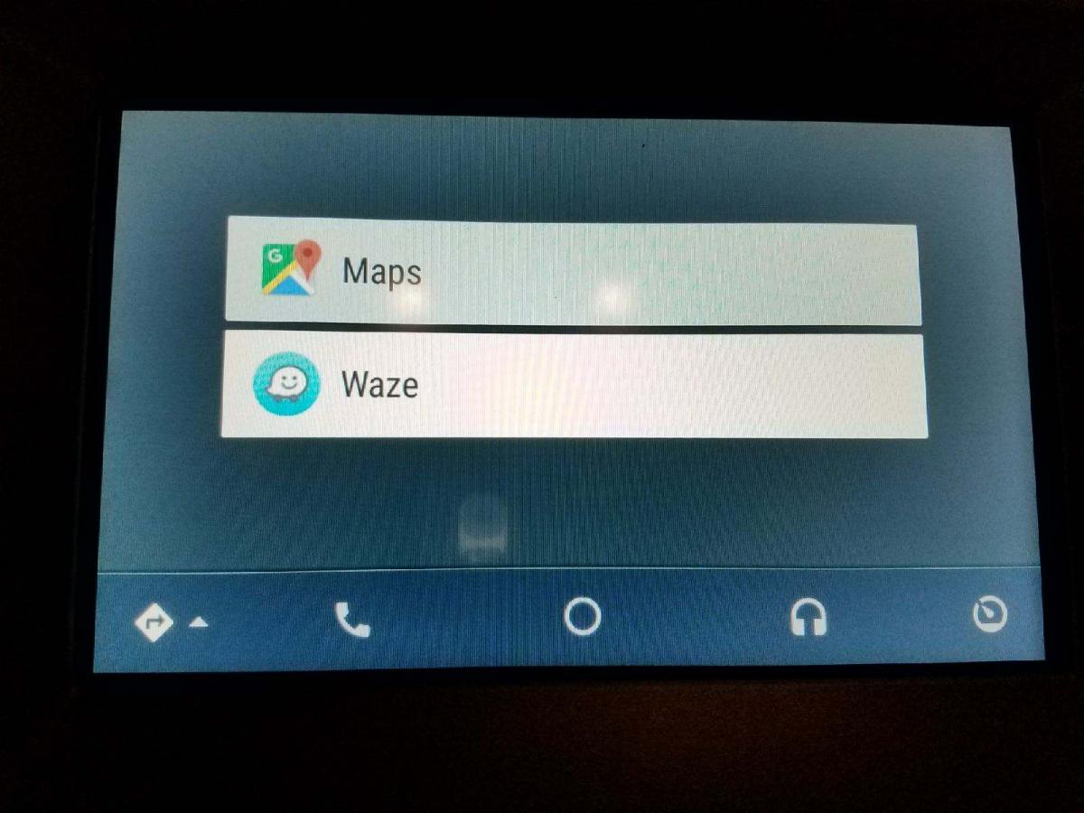

lildisco Posted July 26, 2017 Report Share Posted July 26, 2017 (edited) Finally!!! Waze is available for Android Auto! https://www.google.com/amp/s/www.engadget.com/amp/2017/07/26/waze-android-auto-hands-on/ Edited July 26, 2017 by lildisco 5 Quote Link to comment Share on other sites More sharing options...
normkol Posted July 31, 2017 Report Share Posted July 31, 2017 Thanks for the heads up about Waze. I tried it the other day and it it is great! We now have 3 options of GPS in the car, OEM Ford, Google Maps and now Waze. No need to ever upgrade the Ford GPS, Google and Waze do that all the time. As an example, a bridge, the Goethals bridge, that I take every day, has been replaced by a new one built right next to it. Ford GPS shows me driving out over the water, since it doesn't have the new bridge in its data base. Waze correctly shows me on the new bridge. 2 Quote Link to comment Share on other sites More sharing options...
onyxbfly Posted July 31, 2017 Report Share Posted July 31, 2017 (edited) One of the main reason why I'm waiting/ stalking/ saving/ drooling over a 2016 sport opposed to a 2015. Waze is the $h!T Edited July 31, 2017 by onyxbfly 1 Quote Link to comment Share on other sites More sharing options...
