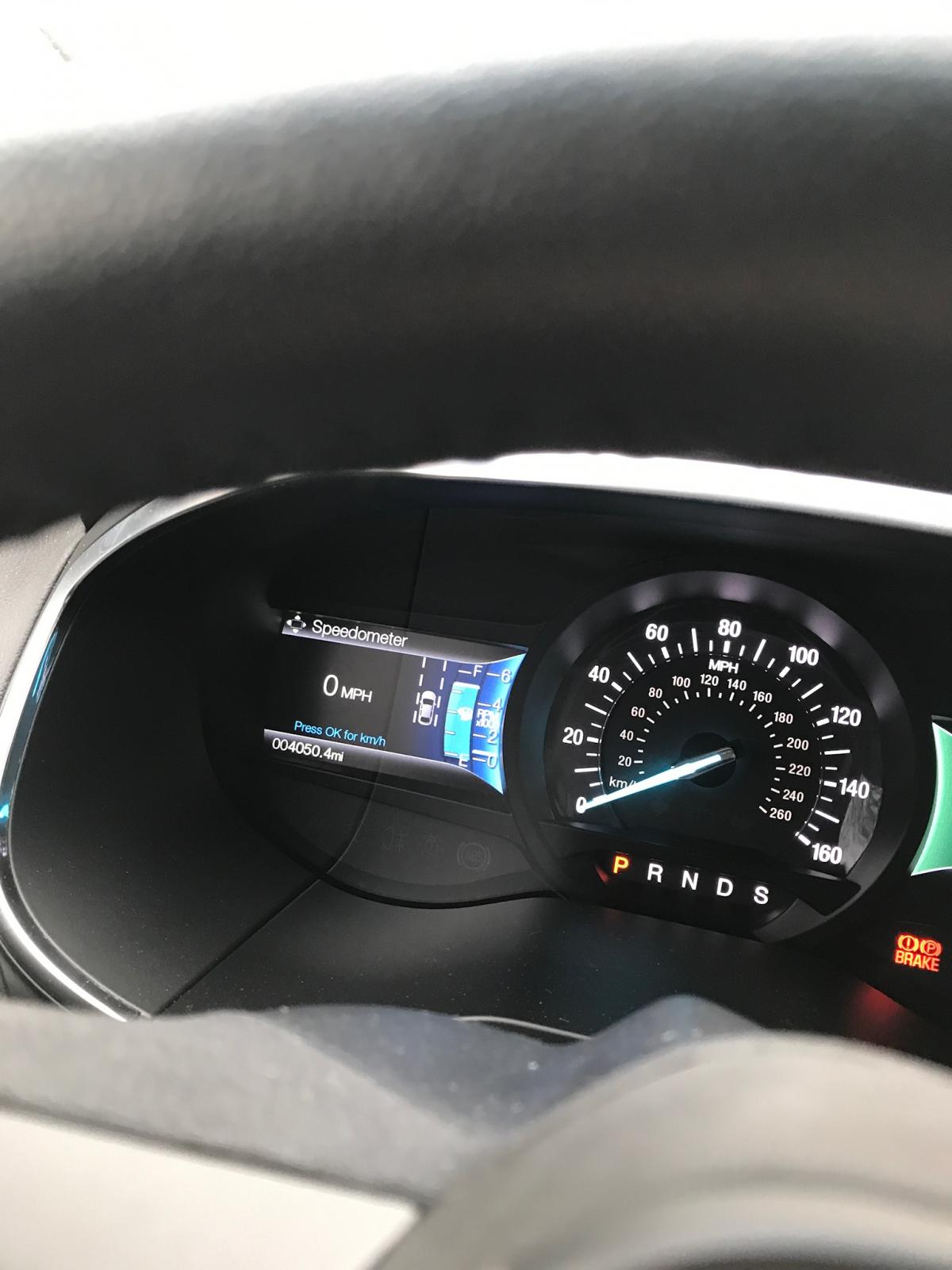

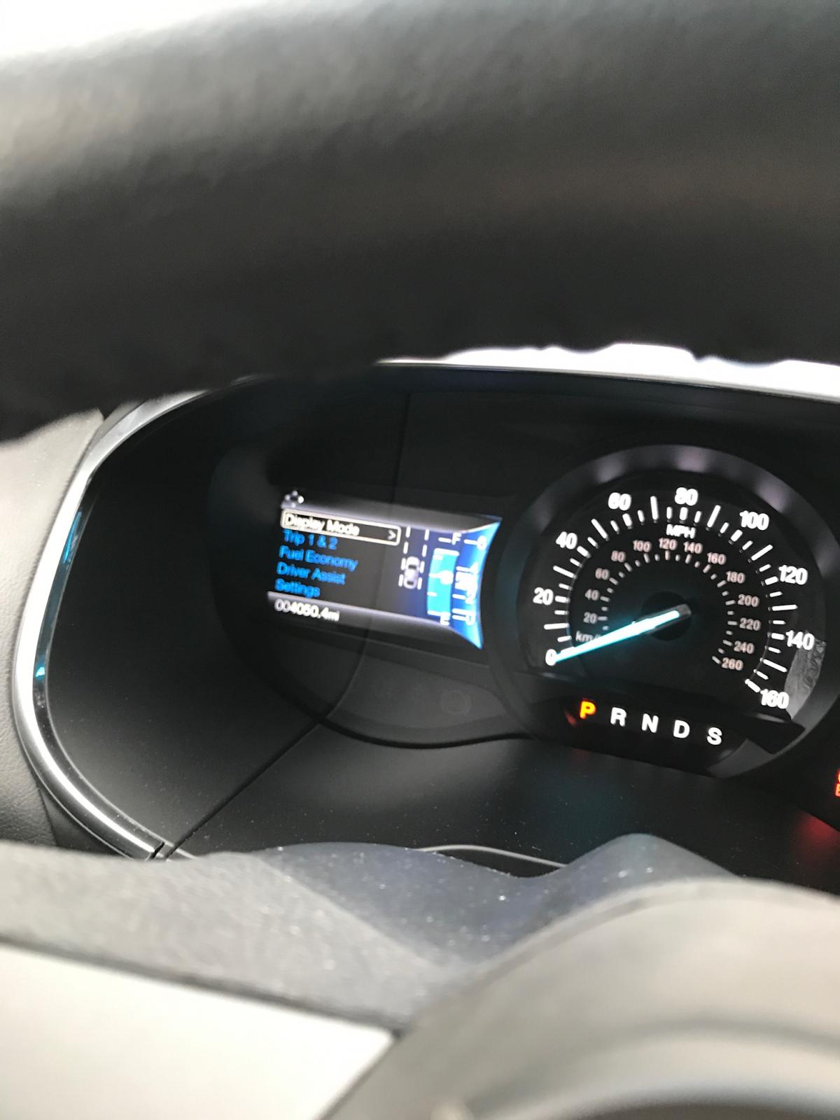

tpm419419 Posted February 7, 2017 Report Share Posted February 7, 2017 Not sure if it's Sync or CarPlay related but... Picked up my Edge after having the brake booster and USB hub replaced. I now have an issue with the left of speedo 4" screen. Under display options there was a choice of 3 or 4 different screens with one being an actual rpm gauge plus fuel and temp. That's gone and only have one option, digital speedo with fuel and vertical tach which was in a separate menu. Any ideas why it's gone? There was an AWD option as well to see where power to wheels were going but that is gone as well Quote Link to comment Share on other sites More sharing options...
tpm419419 Posted February 7, 2017 Report Share Posted February 7, 2017 Solved! I was going to just delete it but I will own up to it. In " Display " mode I was going with the side to side arrows NOT the up and down arrows. All is good, I did a quick read of the owners manual to see what I was doing wrong. 4 Edges and 3 with these 4" screens. By my 5th Edge I'll have it down pat 1 Quote Link to comment Share on other sites More sharing options...
lildisco Posted February 7, 2017 Report Share Posted February 7, 2017 Psst, there's up & down, left & right arrow buttons in the top left corner of the screen to let you know of more options available 2 Quote Link to comment Share on other sites More sharing options...

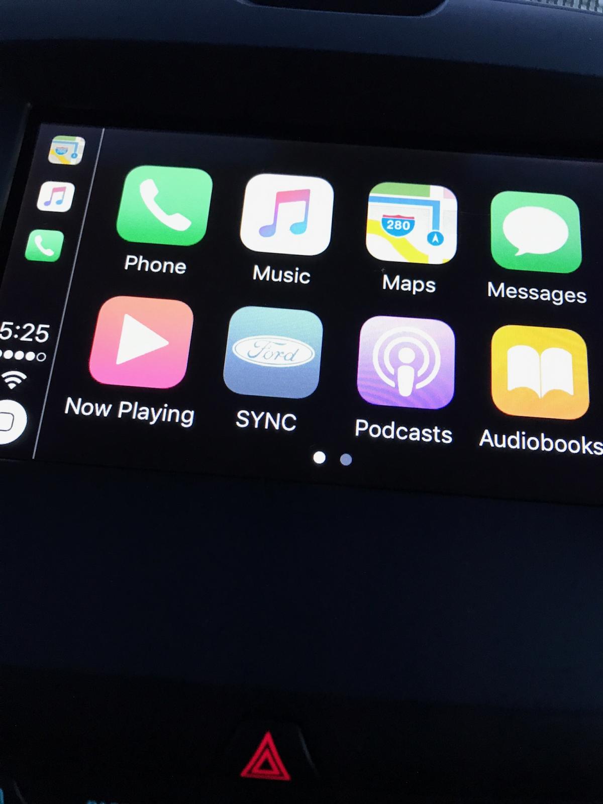

tpm419419 Posted February 7, 2017 Report Share Posted February 7, 2017 Apple CarPlay IOS 10.3.1 with sidebar 1 Quote Link to comment Share on other sites More sharing options...

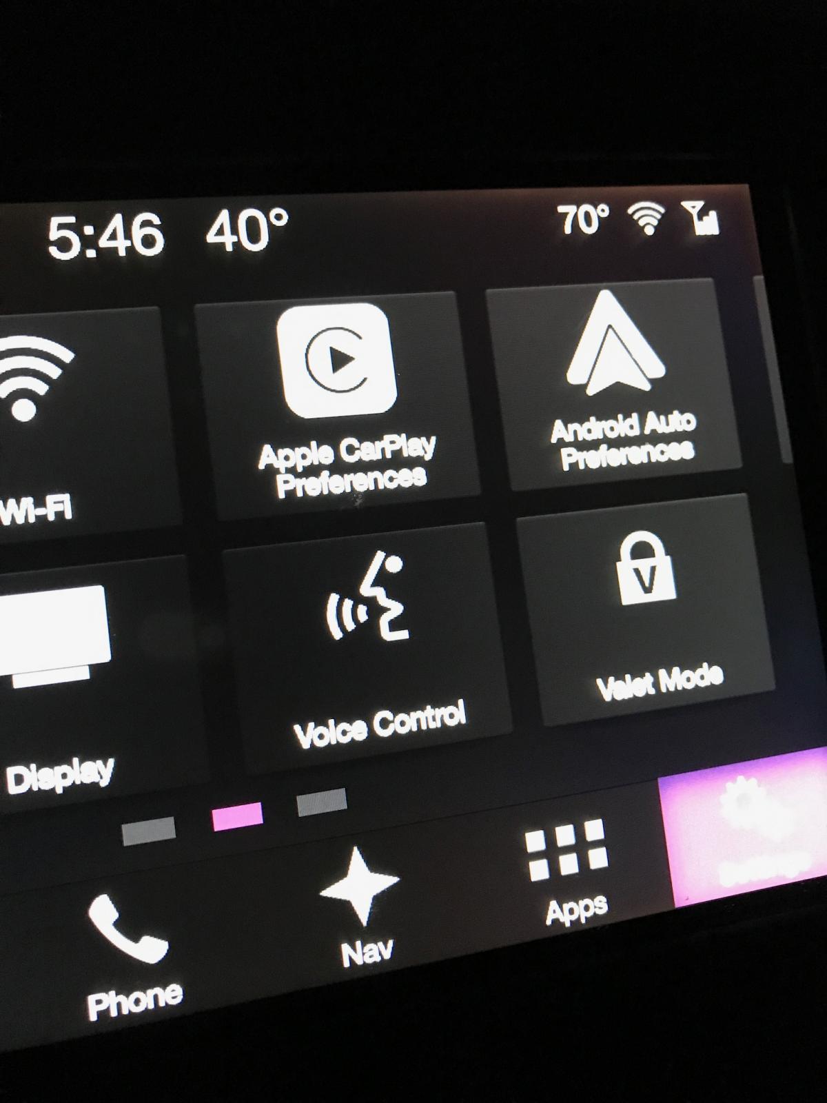

tpm419419 Posted February 7, 2017 Report Share Posted February 7, 2017 (edited) Not positive but I think an added feature to Sync 3 2.2 is Valet mode. You can set a 4 digit pin. Maybe someone can check if it's on Sync 1.0 Edited February 12, 2017 by tpm419419 Quote Link to comment Share on other sites More sharing options...
rvcjew Posted February 7, 2017 Report Share Posted February 7, 2017 Not positive but I think an added feature to Sync 2.2 is Valet mode. You can set a 4 digit pin. Maybe someone can check if it's on Sync 1.0 That was in 1.0 as well. Malcolm 1 Quote Link to comment Share on other sites More sharing options...
