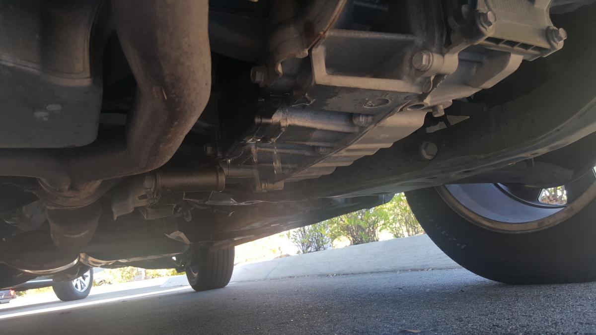

Dino615 Posted September 20, 2016 Report Share Posted September 20, 2016 So my wife text me and said her air stopped working and then called almost immediately and said it died. When I picked her up she said the display told her it overheated. I scanned it first thing and got a P1299. Then I opened the hood and the reservoir was bone dry. First thing I did was check the oil, liked fine. I ran and got a gallon of water and a gallon of anti-freeze. I poured in the gallon of water and waited, nothing. Checked the oil, seemed fine. Poured in about half a gallon of anti freeze and it was finally showing in the reservoir so I waited a minute. The engine ran smooth. After about a minute water Started running out from under the car. Checked the oil and it was slowly getting milking. Obviously an issue. I snapped a picture and a short video before I shut it off. And suggestions? Does this look like a cracked block, or could it be a head gasket? Or is it still just a guessing game?? It won't let me upload the video. Thanks Quote Link to comment Share on other sites More sharing options...

WWWPerfA_ZN0W Posted September 21, 2016 Report Share Posted September 21, 2016 The video should be uploaded to a sharing site like flickr, photobucket, etc then linked back here. How many miles on your MKX? "water" coming out, meaning coolant, right? From the location, it is likely a cracked block OR the coolant xover tube OR the thermostat housing that gave way. I hate to say this, but regardless of the cause (water pump, head gasket, cracked block), you may want to look at getting a low mileage used engine and having that put in instead of attempting repairs. At least figure out if that option is viable for you or not. 1 Quote Link to comment Share on other sites More sharing options...
Dino615 Posted September 21, 2016 Author Report Share Posted September 21, 2016 Yes, coolant/water i had just added. It has 111k miles on it, it was a cool 88 degrees today so she was running the air but just everyday driving. I am not discounting it, but I have never heard of s block cracking in the middle of summer for no reason. What would cause that? Any of the other answers sure sound better to my wallet Quote Link to comment Share on other sites More sharing options...
WWWPerfA_ZN0W Posted September 21, 2016 Report Share Posted September 21, 2016 (edited) I am thinking cracked tube/housing, but I dont know why the oil is turning "milky". Are you sure the oil is simply not breaking down, possibly because the oil level is low? Edited September 21, 2016 by WWWPerfA_ZN0W Quote Link to comment Share on other sites More sharing options...
Dino615 Posted September 22, 2016 Author Report Share Posted September 22, 2016 Well it was water pump and the my wife let it get too hot and warped the heads. Thanks for all the answers and help. Quote Link to comment Share on other sites More sharing options...
