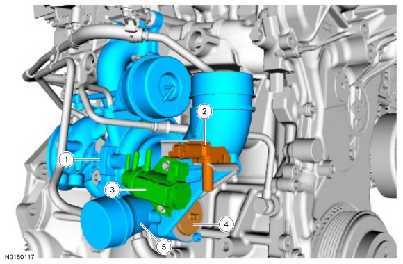

WWWPerfA_ZN0W Posted September 7, 2016 Report Share Posted September 7, 2016 (edited) I think you have to go in through the pass side wheelwell to access it, should be close to the wastegate/bypass valve. Will check. Item Description Comments 1 Turbocharger - 2 Turbocharger sensor assembly - 3 Turbocharger wastegate regulating valve solenoid - 4 Turbocharger bypass valve - 5 Pressure side of compressor - Edited May 22, 2018 by WWWPerfA_ZN0W 1 Quote Link to comment Share on other sites More sharing options...
