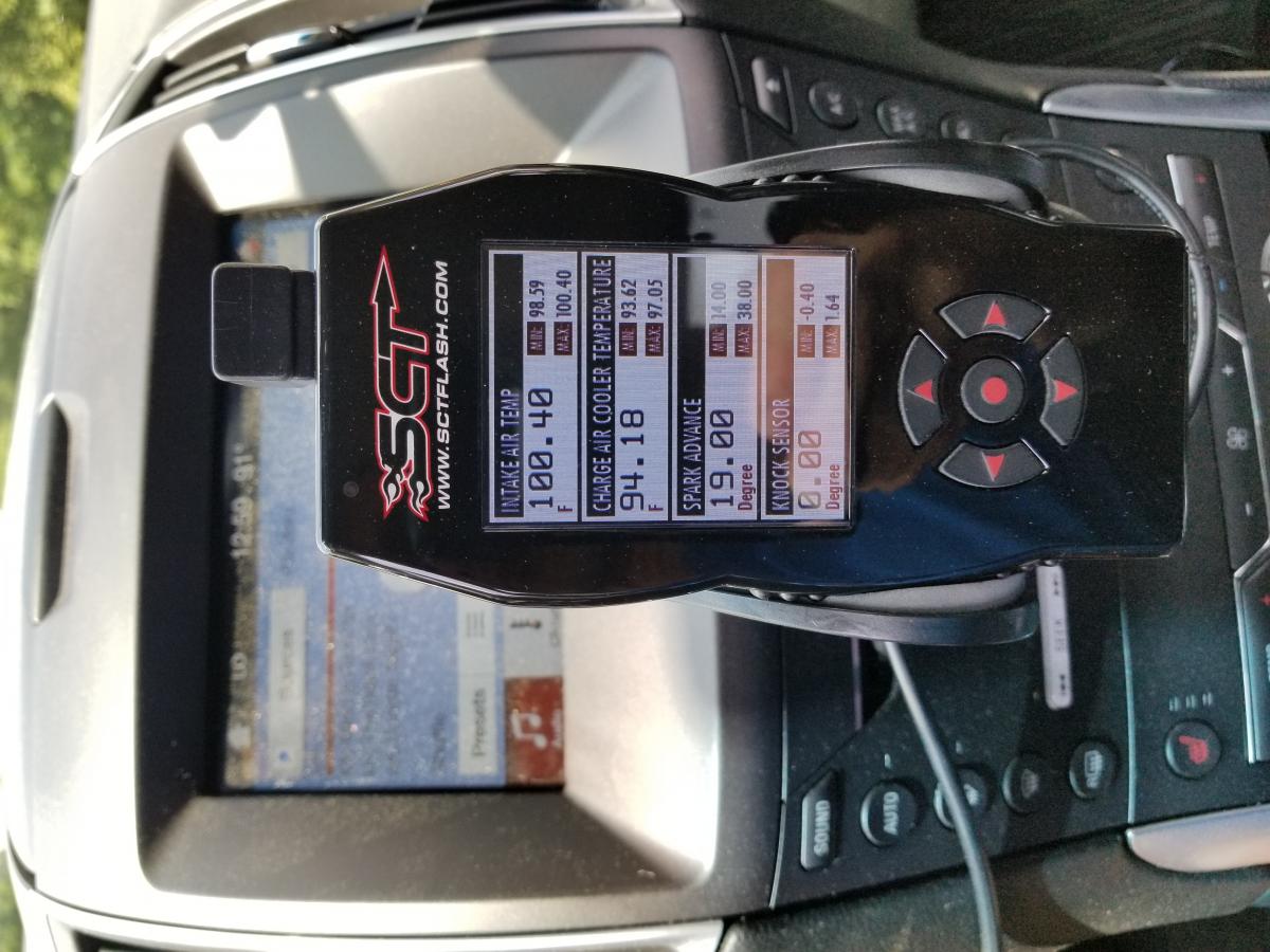

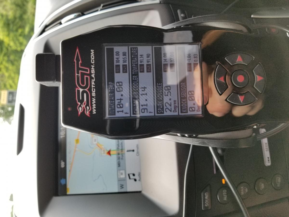

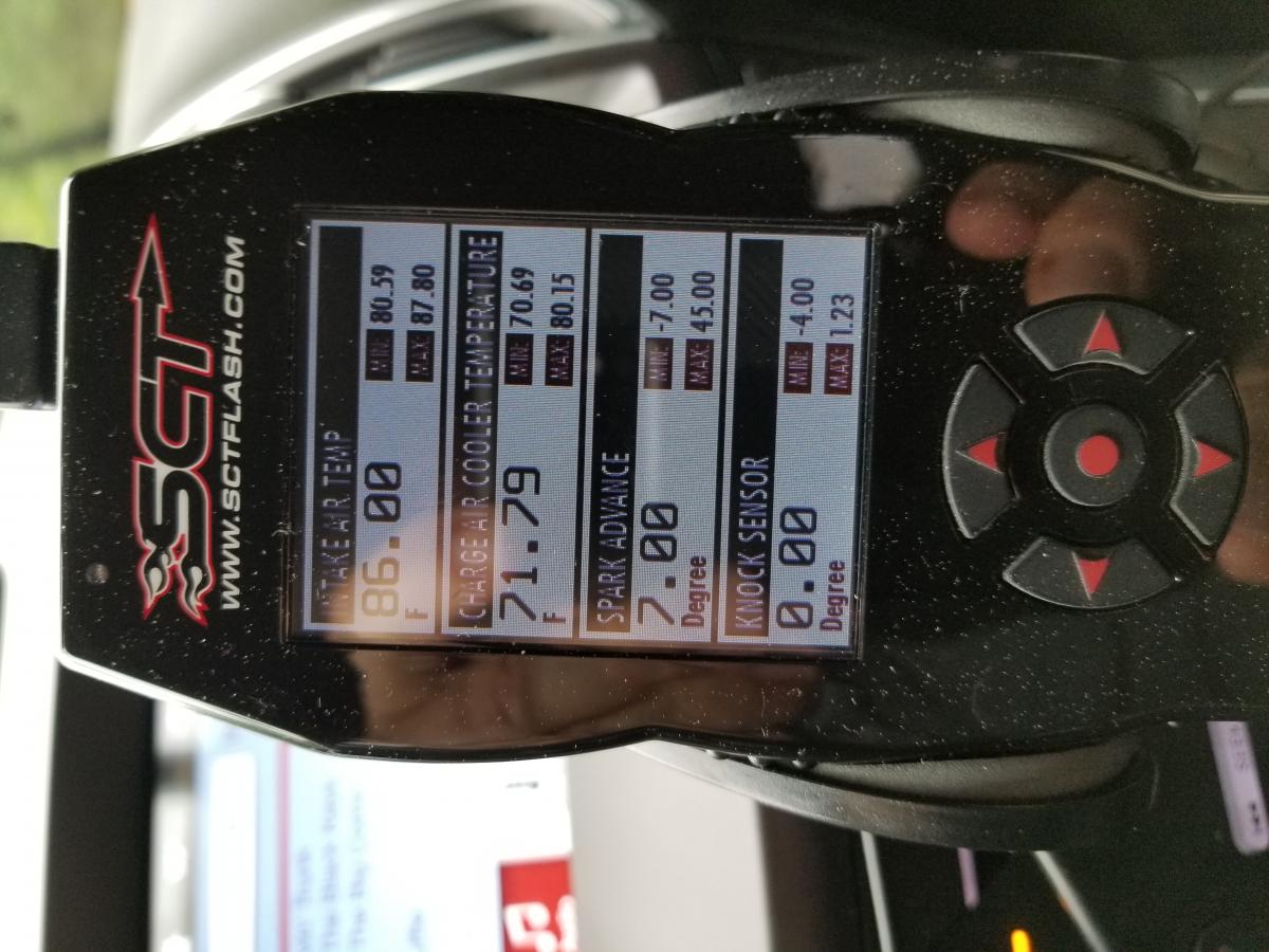

snmjim Posted May 22, 2018 Report Share Posted May 22, 2018 (edited) For those of you anxiously awaiting raw data as a result for the install of the Ultimate Performance IC & the Rambo IC Outlet Pipe along with custom Tune refinement on 93 octane the following applies... While we're waiting for SpecialK & I to locate an accurate Dyno within reasonable driving distance and schedule track time we'll periodically post Pics of the onboard tune computer/monitor at specific speeds & temperatures. Note: We still intend to provide the Dyno & track time data analysis in typical SpecialK fashion once we have it, however be patient it's going to be a while... As the weather warms we'll do our best to provide incremental updates. Pic specifics: #1 Date: 05/22/2018 Conditions: Highway cruise to work with overcast Location: MD Time: 0730 Temp 60 degrees Speed: Sustained 15 min at 70 Comments: No clue why the Forums App turns the Pic sideways #2 Date: 05/23/2018 Conditions: Highway cruise from work with clear skies Location: MD Time: 1700 Temp 70 degrees Speed: 70 mph sustained 15 min Comments: No clue why the Forums App turns the Pic sideways #3 Date: 05/26/2018 Conditions: Highway cruise, clear skies Location: MD Time: 1430 Temp 80 degrees Speed: 70 mph sustained 15 min Comments: No clue why the Forums App turns the Pic sideways #4 Date: 06/01/2018 Conditions: Highway cruise, clear skies Location: MD Time: 1615 Temp 90 degrees Speed: 70 mph sustained 15 min Comments: No clue why the Forums App turns the Pic sideways Edited June 2, 2018 by snmjim 2 Quote Link to comment Share on other sites More sharing options...

WWWPerfA_ZN0W Posted May 22, 2018 Report Share Posted May 22, 2018 And this is without methanol! Quote Link to comment Share on other sites More sharing options...
Special_K Posted May 22, 2018 Report Share Posted May 22, 2018 And this is without methanol! Sure is!!! 2 Quote Link to comment Share on other sites More sharing options...
