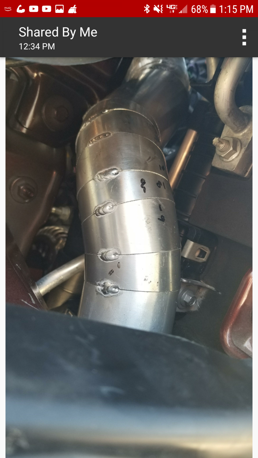

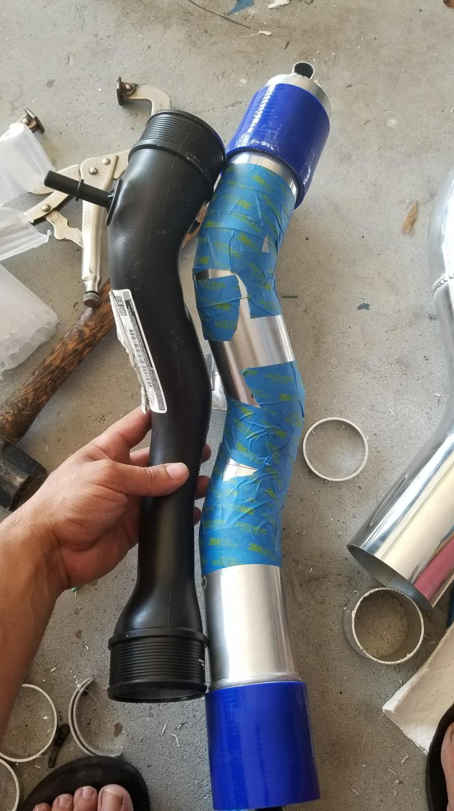

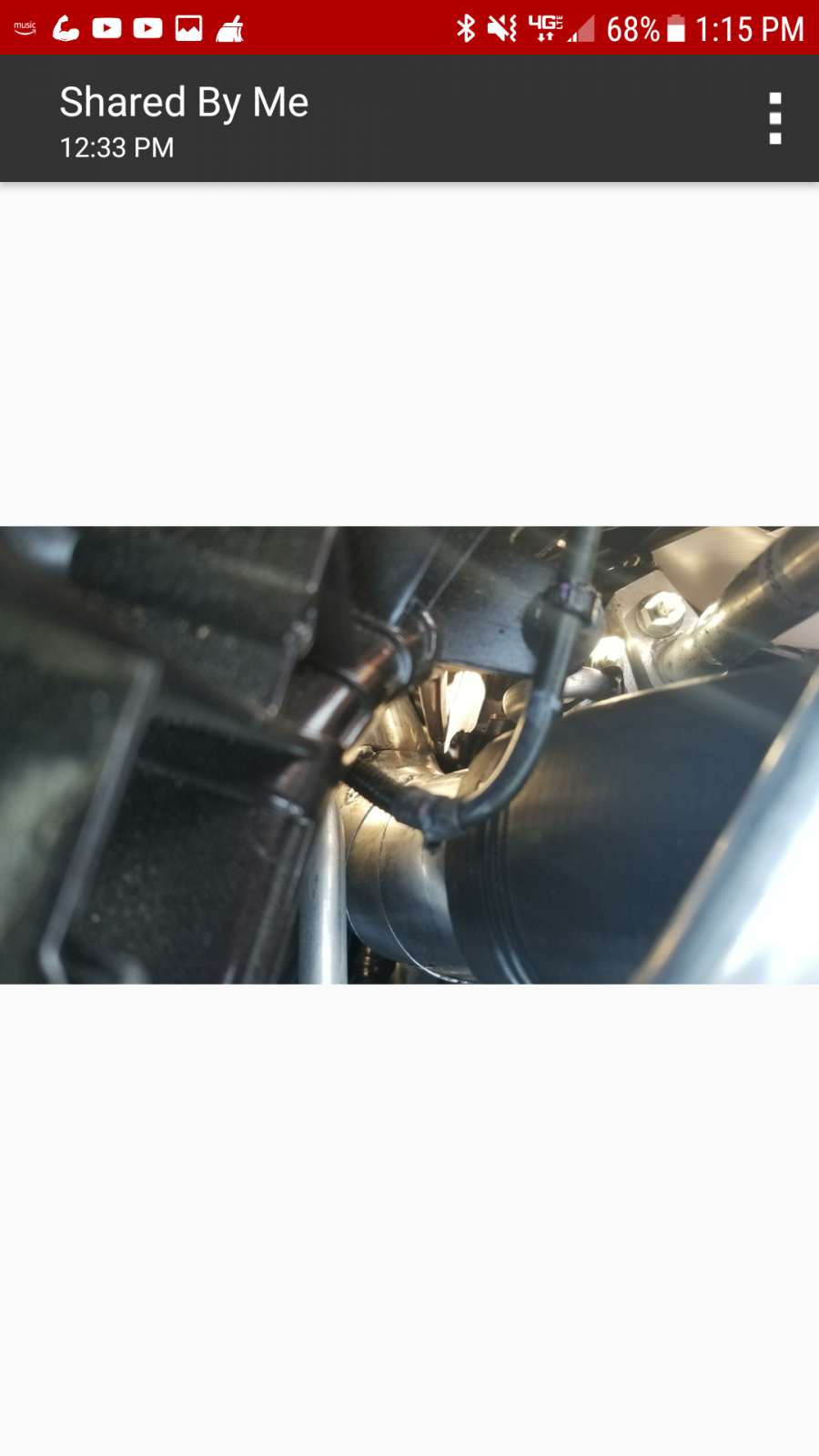

Special_K Posted March 3, 2018 Report Share Posted March 3, 2018 Update on the cold side charge pipe!!! Looking good!! We will have the prototype in our hands soon!!! Shout out to ramfab performance for the help! You can follow him on Instagram if you want! 4 Quote Link to comment Share on other sites More sharing options...
Xtra Posted March 4, 2018 Report Share Posted March 4, 2018 (edited) Tight fit, you could have not made that 1/4 inch bigger. Great job! Edited March 4, 2018 by Xtra 1 Quote Link to comment Share on other sites More sharing options...

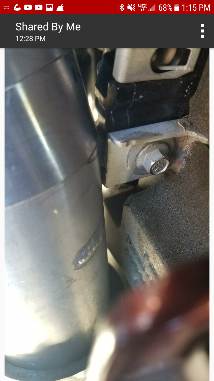

STB130 Posted March 13, 2018 Report Share Posted March 13, 2018 Update on the cold side charge pipe!!! Looking good!! We will have the prototype in our hands soon!!! Shout out to ramfab performance for the help! You can follow him on Instagram if you want! Guys this is the biggest perfect fitting cold inlet pipe that will fit our Sports, the pictures of the prototype are from my car, Special K will get the first, I hope to get the second. 5 Quote Link to comment Share on other sites More sharing options...
Special_K Posted March 13, 2018 Report Share Posted March 13, 2018 Guys this is the biggest perfect fitting cold inlet pipe that will fit our Sports, the pictures of the prototype are from my car, Special K will get the first, I hope to get the second. Thanks again for being willing to go out and test fit for us! It really help push the platform in the right direction!!! 3 Quote Link to comment Share on other sites More sharing options...

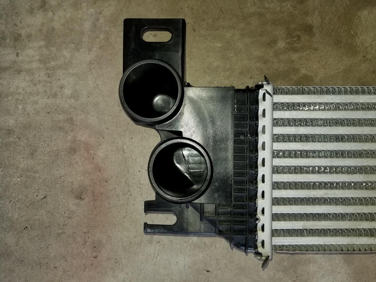

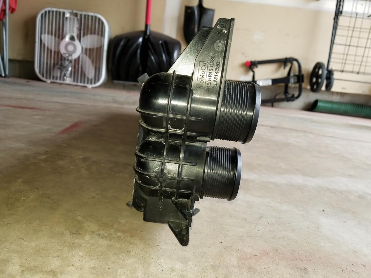

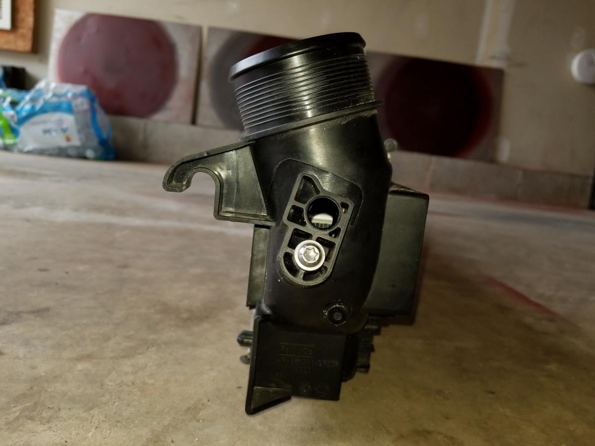

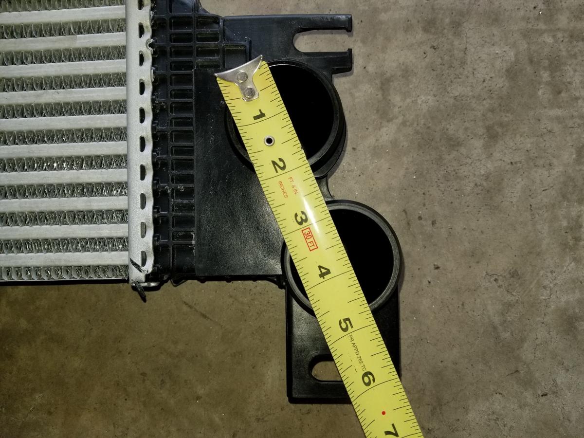

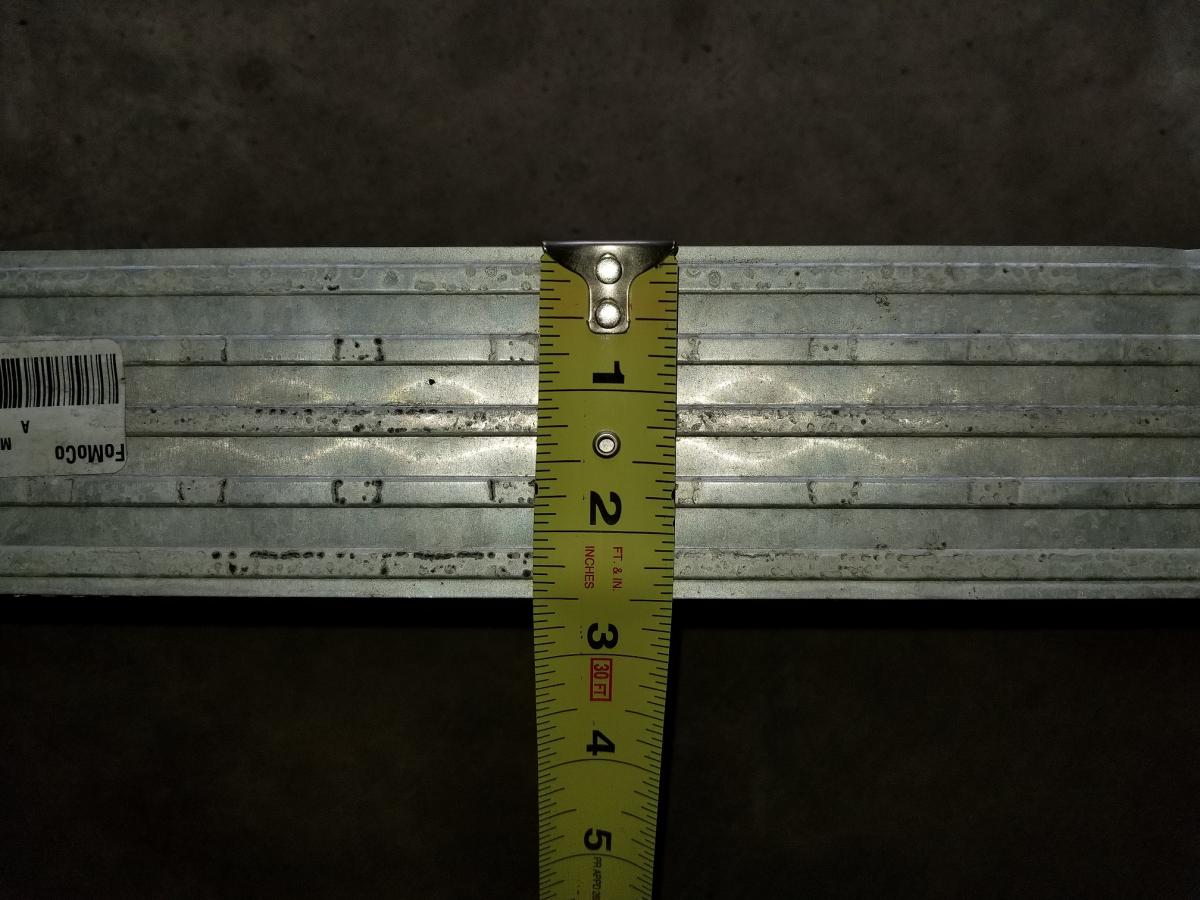

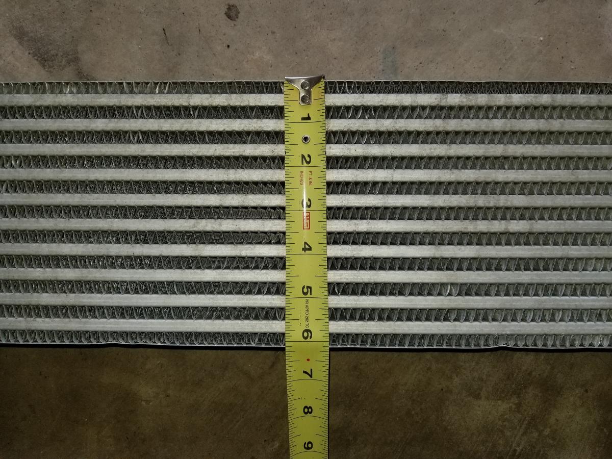

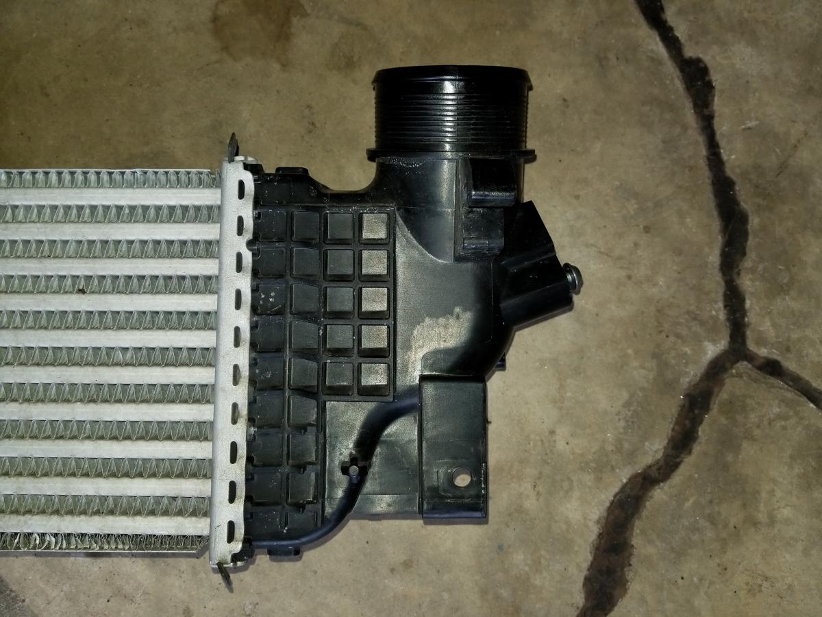

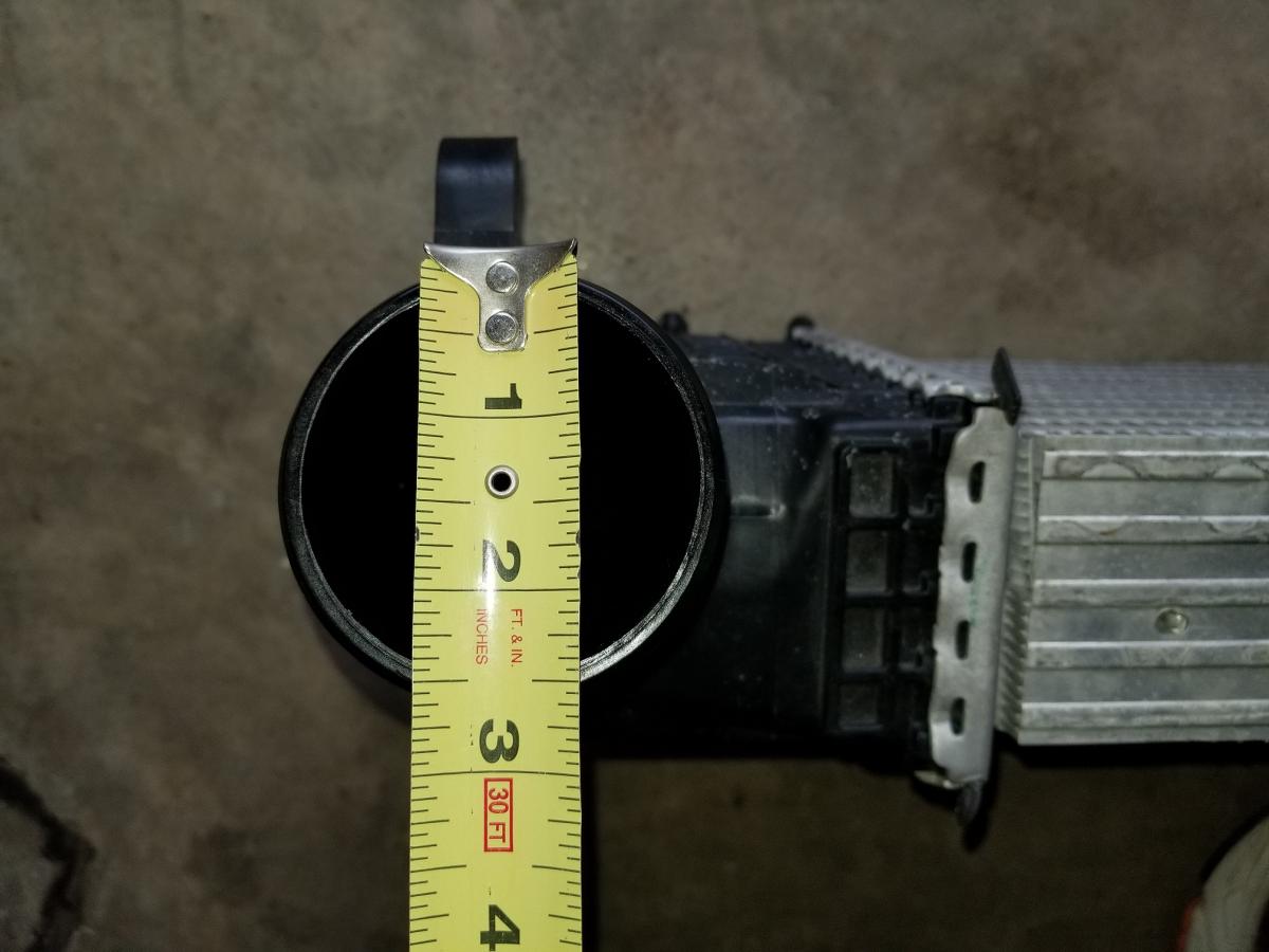

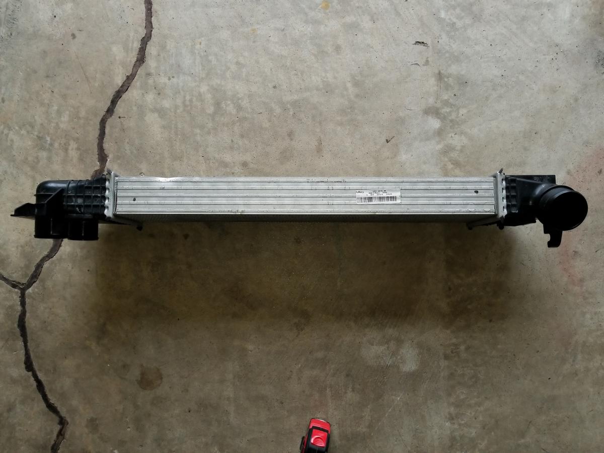

snmjim Posted March 17, 2018 Report Share Posted March 17, 2018 (edited) As we're pacing back & forth waiting on CPe to call us in once their first batch of Fusion Sport ICs are mass produced so we can proceed with Edge Sport fitment we had to do something to silence those voices of apprehension... Therefore, we decided to take Pics & measurements in the same manner that we did in this topic string for the 2016 Edge Sport back on 10-12 Dec 2017 (page 5 of this string)......but.....wait for it......of the stock IC for the 2017 Fusion Sport... :happy feet: Ref attached Pics of the stock IC. If the stock measurements are close between the stock Edge (2016) & Fusion (2017) then the chances are very good that this should be a smooth fitment.....now compare the Pics & measurements of the stock IC for the 2016 Edge Sport posted 10-12 Dec 2017 and you tell us what you see http://www.fordedgeforum.com/topic/21117-intercooler-sport/page-5 ..... At this point, in conjunction with CPe, we're going to convert the Edge Sport intake charge pipes from the 2- n-1 to the dual charge pipe system that the Fusion Sport uses. This along with our modified outlet charge pipe we should see significant increases in performance... Until the celebration party...Ciao Baby!!! Edited March 17, 2018 by snmjim 5 Quote Link to comment Share on other sites More sharing options...
WWWPerfA_ZN0W Posted March 17, 2018 Report Share Posted March 17, 2018 Great info, as usual! Anybody going through these threads can now see realistic timelines for development of custom products like this. Ain't easy! 3 Quote Link to comment Share on other sites More sharing options...
macbwt Posted March 18, 2018 Report Share Posted March 18, 2018 As we're pacing back & forth waiting on CPe to call us in once their first batch of Fusion Sport ICs are mass produced so we can proceed with Edge Sport fitment we had to do something to silence those voices of apprehension... Therefore, we decided to take Pics & measurements in the same manner that we did in this topic string for the 2016 Edge Sport back on 10-12 Dec 2017 (page 5 of this string)......but.....wait for it......of the stock IC for the 2017 Fusion Sport... :happy feet: Ref attached Pics of the stock IC. If the stock measurements are close between the stock Edge (2016) & Fusion (2017) then the chances are very good that this should be a smooth fitment.....now compare the Pics & measurements of the stock IC for the 2016 Edge Sport posted 10-12 Dec 2017 and you tell us what you see http://www.fordedgeforum.com/topic/21117-intercooler-sport/page-5 ..... At this point, in conjunction with CPe, we're going to convert the Edge Sport intake charge pipes from the 2- n-1 to the dual charge pipe system that the Fusion Sport uses. This along with our modified outlet charge pipe we should see significant increases in performance... Until the celebration party...Ciao Baby!!! Will the upgrade be all aluminum or will the end caps still be plastic? Quote Link to comment Share on other sites More sharing options...
