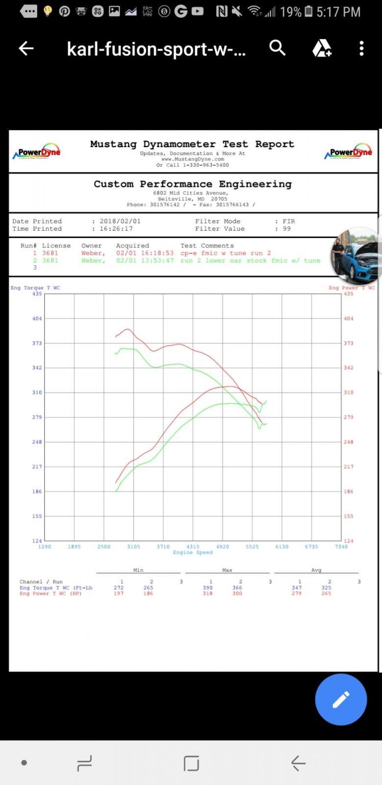

Special_K Posted February 6, 2018 Report Share Posted February 6, 2018 (edited) This is not for distribution...and I was wrong its 36hp sorry guys ;-) Edited February 6, 2018 by Special_K Quote Link to comment Share on other sites More sharing options...

Special_K Posted February 6, 2018 Report Share Posted February 6, 2018 Great numbers, awesome results . Had no idea that the stock IC was so overwhelmed . I can feel the power loss when things heat up, but 38HP at the wheels! Wow thats a lot. Put me on the list to get one when available . So lets combine this with the super restricting cold side pipe and I could easily see a 45whp gain! 2 Quote Link to comment Share on other sites More sharing options...
Xtra Posted February 6, 2018 Report Share Posted February 6, 2018 (edited) So lets combine this with the super restricting cold side pipe and I could easily see a 45whp gain! Truly amazing, a bolt in kit with hot and cold pipes will sell like hot cakes with numbers like that! And besides the huge HP gains, this is one mod that can actually help with engine life and reliability, especially if you live in a hot climate and drive hard like I do on occasion. I am saving my Ducats now in anticipation. Edited February 6, 2018 by Xtra 2 Quote Link to comment Share on other sites More sharing options...

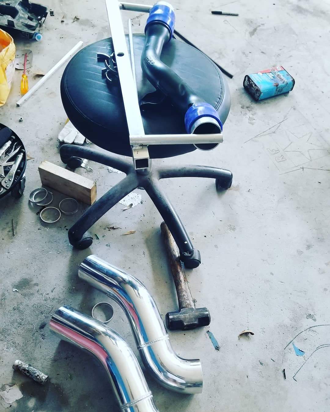

Special_K Posted February 19, 2018 Report Share Posted February 19, 2018 Update on boost tube fabrication! I'll keep everyone updated! 1 Quote Link to comment Share on other sites More sharing options...
GT500R Posted February 19, 2018 Report Share Posted February 19, 2018 Interested based on gains shown. 2 Quote Link to comment Share on other sites More sharing options...

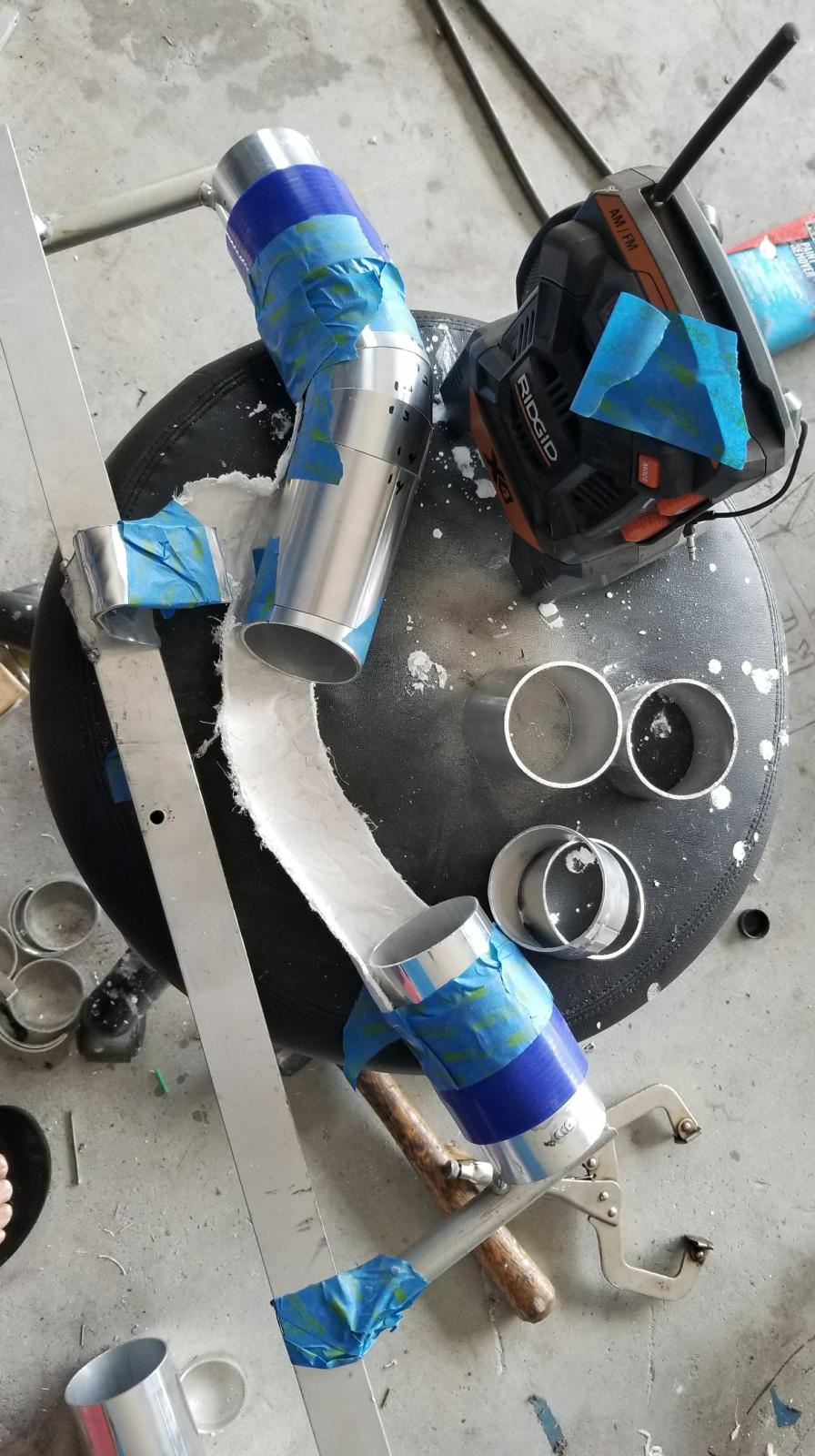

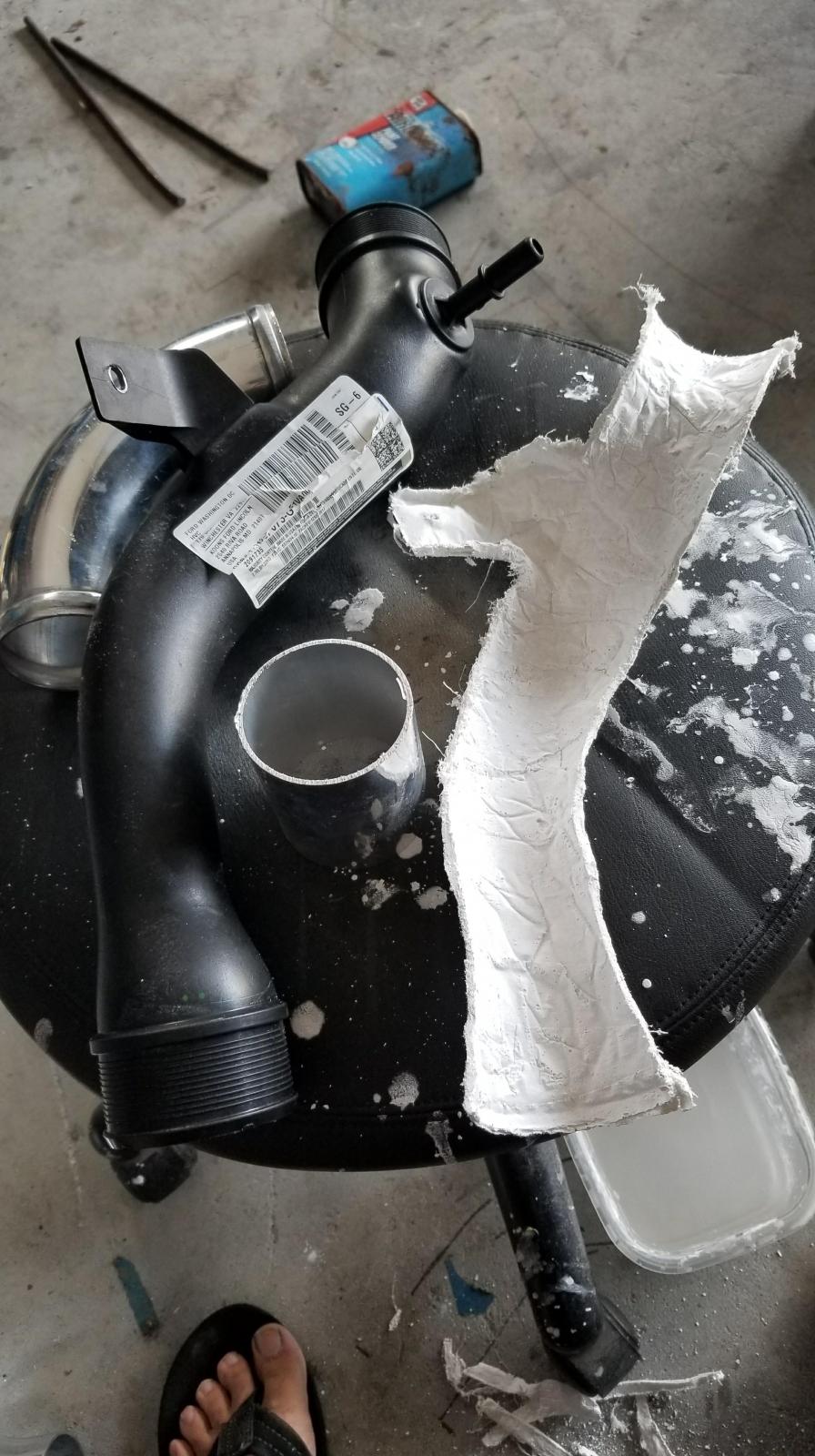

Special_K Posted February 20, 2018 Report Share Posted February 20, 2018 Update #2 2 Quote Link to comment Share on other sites More sharing options...
Mikula Posted February 20, 2018 Report Share Posted February 20, 2018 Tell that guy to get his hands on a pipe bender! pie cuts are such a PITA. Sure does show off the skills of the fabricator, though. 1 Quote Link to comment Share on other sites More sharing options...
