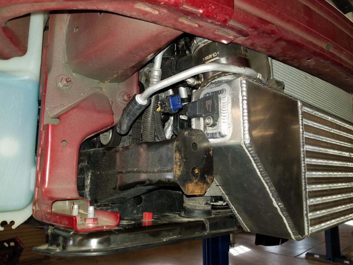

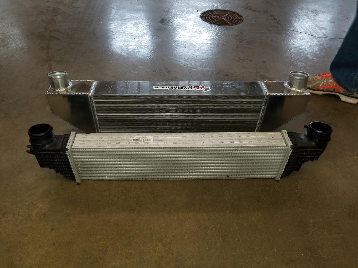

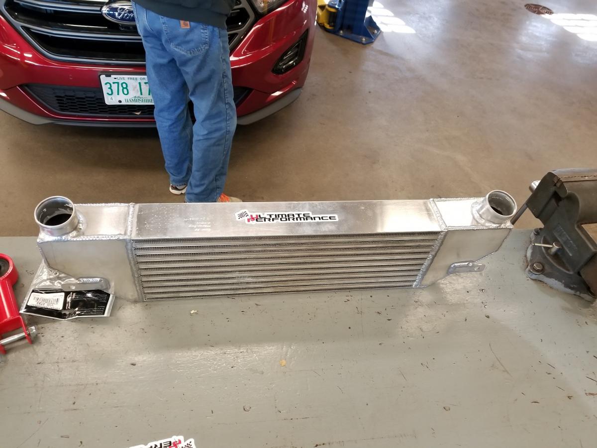

That being the case here, to spare you any further delay I'm going to at least provide the pics and highlight in red the areas of focus i.e. cutout modification.
You can blame the hatchet job on the highlighted cut on the owner... :doh:
Note: since this is going to be a large post I'll break it into three sections:
- Comparative
- Removal
- Installation

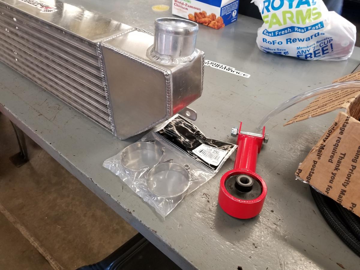

Jim if they do make more than a few of these, please let me know how to get my hands on one. most importantly a price.

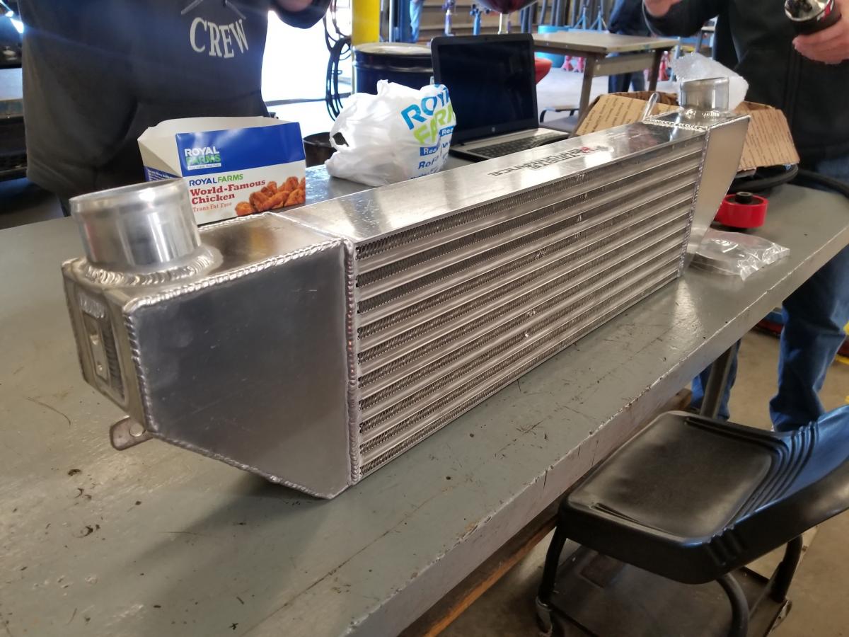

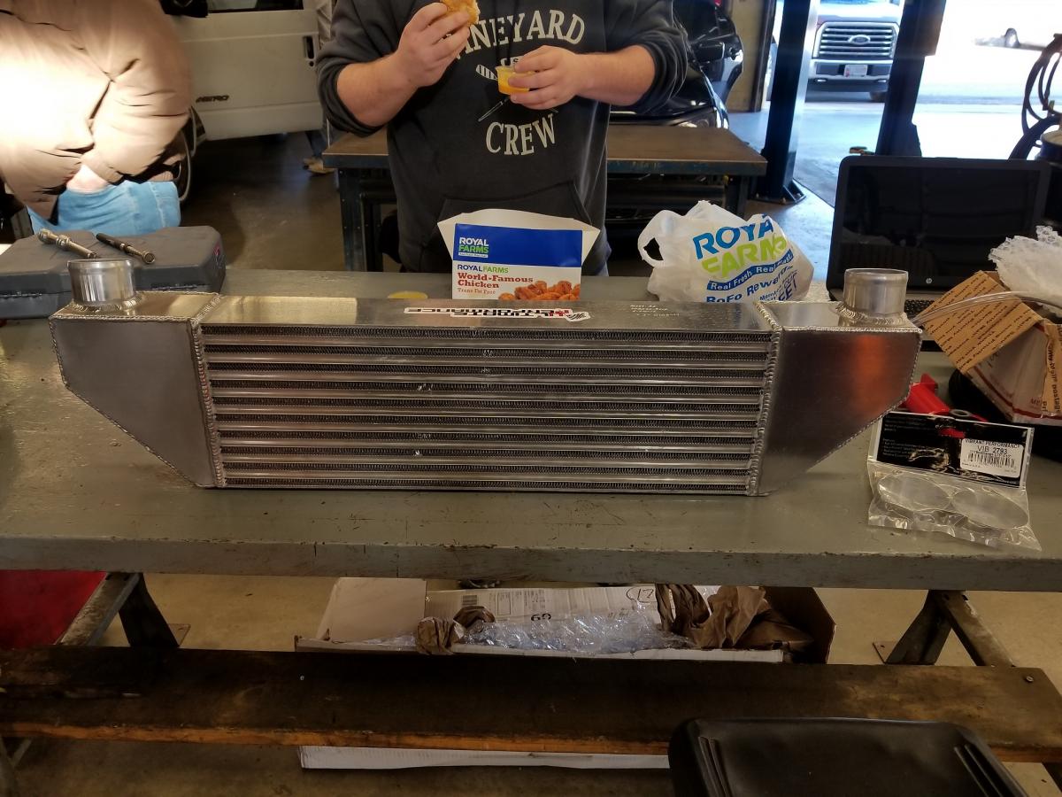

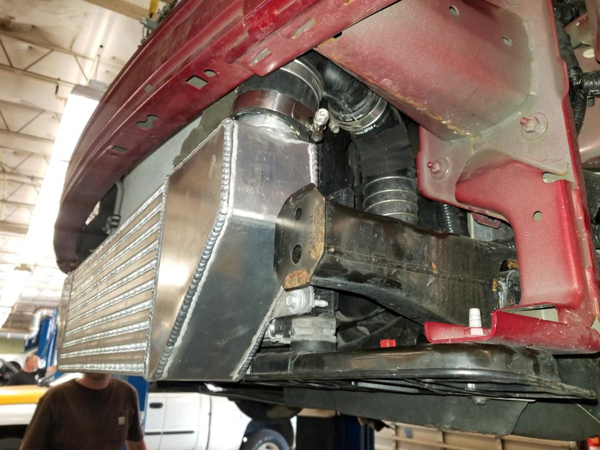

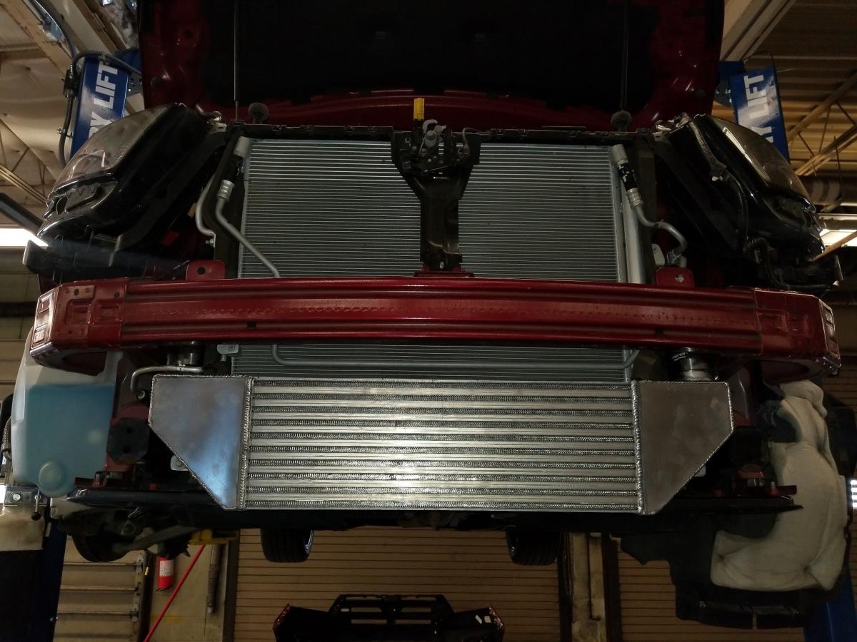

I'm taking a survey of how many are seriously interested enough to put down a $100 deposit with me so I can put in an order for the IC shown in the Pics below which were also posted in one of my previous write ups in this string.
Depending on the level of interest/hard orders I will attempt to get us a group discount and only tack on a $50 handling fee unless the manufacture is willing to direct ship each order.
Until we do some Dyno testing, which will happen some time this year, the preliminary unofficial Specs from the manufacture & Special K are:
- Bolt in application after an easy modification of the IC part of the AGS or simply removing entirely
- 25% over all increase (size & Perf)
- Based on the Fusion Sport IC results with this manufacture you can expect to see around 50-70 degrees less IATs
- Estimate 4-7 tenths off of your acceleration times
- Cost with shipping $850
Notes:
- The vendor is prepared to manufacture the first mass production batch and needs a solid Qty in the next 1-2 Wks.
- We're still scheduled to perform R&D, fitment & testing with CPe for their IC sometime in the next 1-3 months.
- It is apparent that we're looking at significantly more than 5% gains with this manufacture as opposed to others mentioned in this string and other topic threads.

The prototype cost $850, however note it's a one of a kind and significantly larger, we wouldn't have R&D this one had there only been a 5% benefit (i.e. CX IC) per another members post in this string. The intent was to find an IC with siginifncant improvement for the stock turbos & should one choose to upgrade turbos this IC will also handle the higher demands and eliminate the need to change the IC again... :hat_tip:
We're estimating an all around 25% benefit N size & Perf, that's a preliminary educated estimate based on physical measurements and an initial performance check.

You guys all need to get the numbers straight.
I'll help put it into perspective.
1. The CXRacing intercooler was <$550 shipped... contact the guy for a quote, you can also increase the size per request (height) for increased cooling.
2. The CORE was 5% bigger, what does this mean? Well the dimensions vs. stock were 5% larger but all aluminum and better designed.
3. Wait so you only get 5% better cooling? NO, dear god I would not even tell anyone about this if I got 5% better cooling...
Tests pre and post intercooler show an average of 10*C in temps from 0-90. So take your original temp increase on stock intercooler, your increase on modified intercooler, difference, division and you get % gains. Which was 23%... logs show a decrease in KR at higher RPM, which means more timing which means more power back.
4. Intercoolers like the one I run or the others out there will gain the most from higher boost tunes, which as the moment I don't run a crazy high boost at high rpm tune (like LMS).
Also take off .4 - .7 seconds sounds awesome, that would take your SUV from 12.9 to a 12.2 to 12.5 SUV at least right? :hysterical:

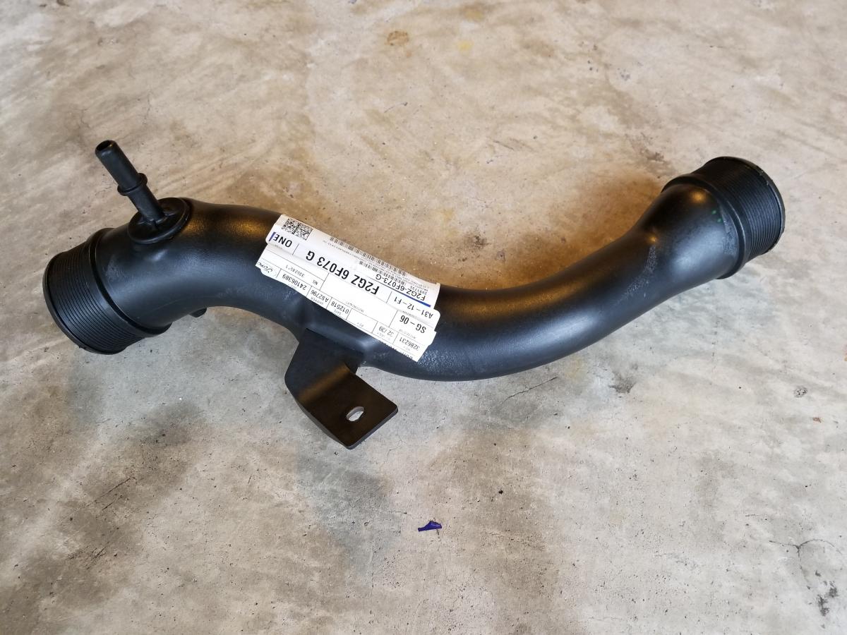

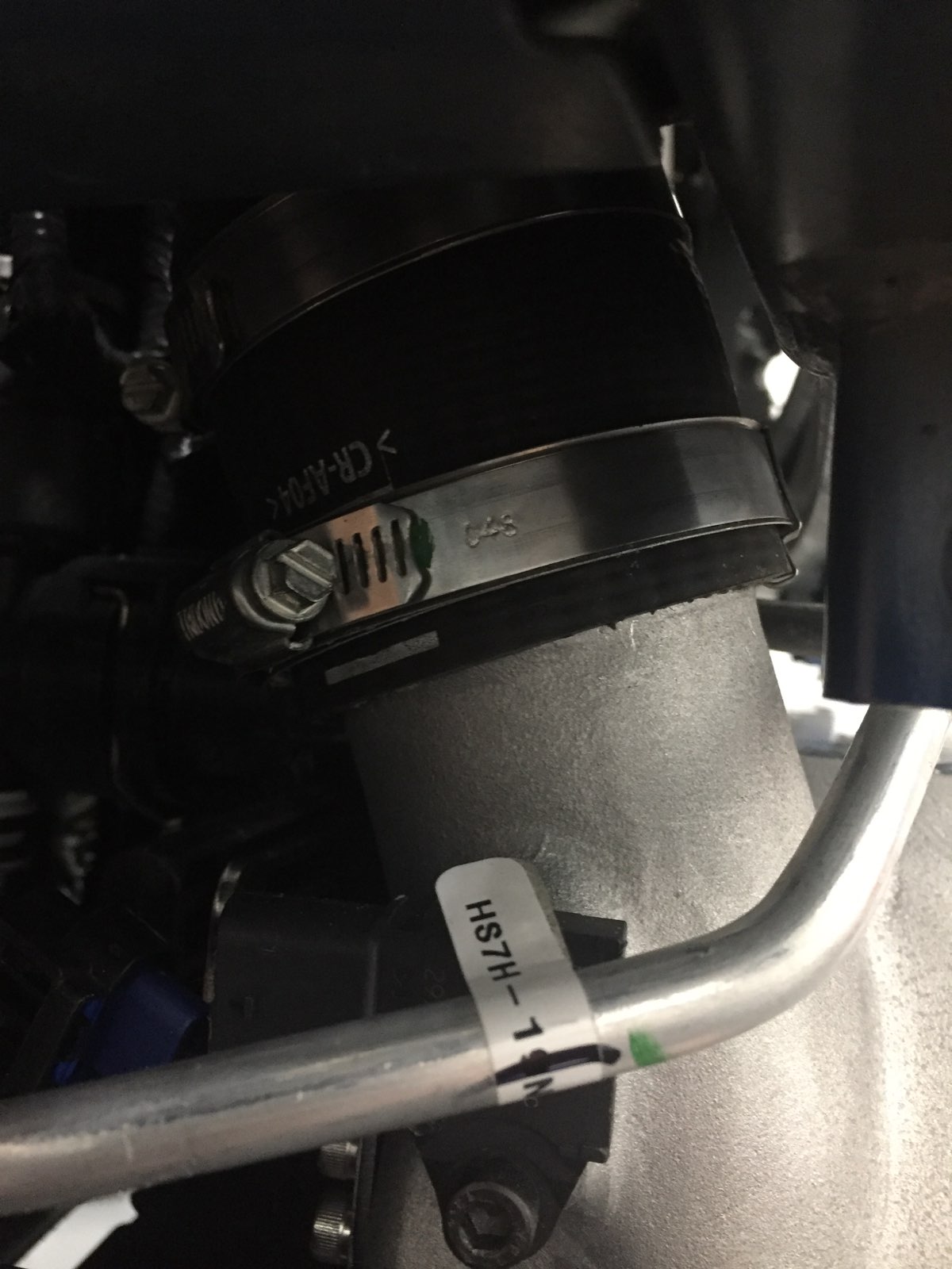

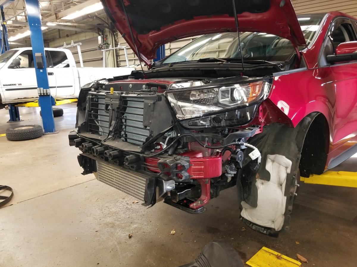

In an effort to get this topic back on track... :doh:

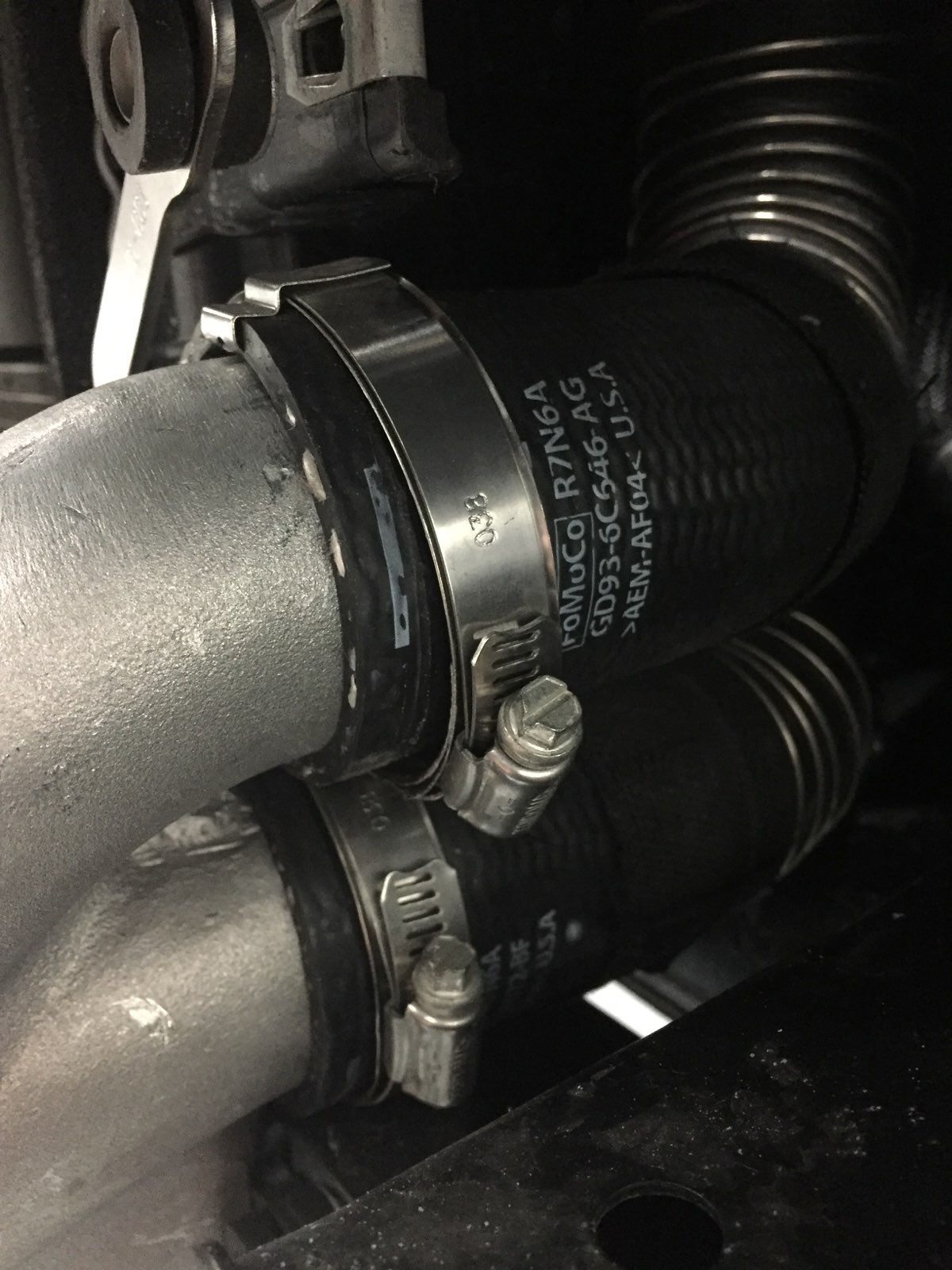

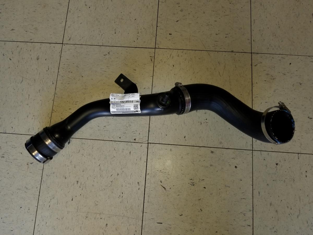

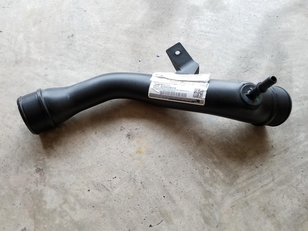

While waiting on CPe to call us in sometime this month (Feb) we decided to attack the IC piping issue.
The piping on the IC intake side we deemed as being adequate however, the outlet side is whole nother can of worms, check out the Pics, see any problem... :drop:
Therefore, thanks to my awesome Ford parts guy... :hat_tip: he was nice enough to provide a sample outlet pipe for us to ship to the piping modification fabricator in FL... :happy feet: :happy feet: :happy feet:
Edited by snmjim
