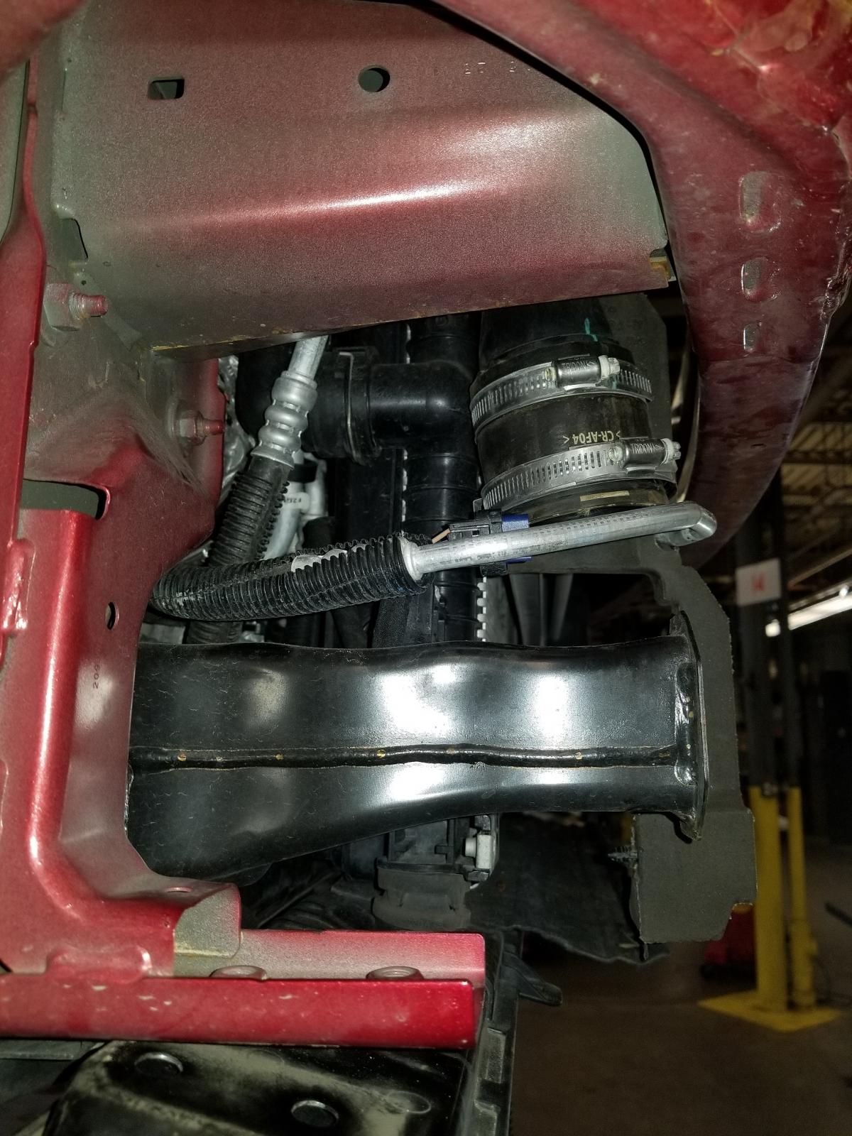

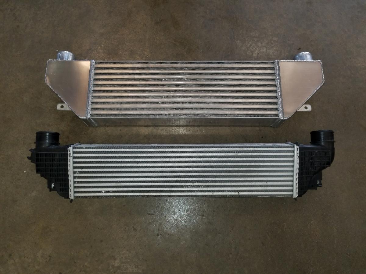

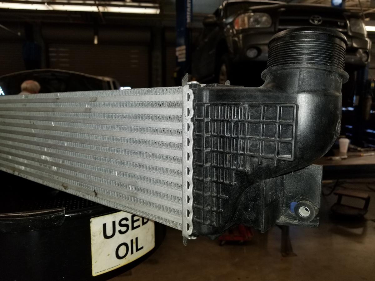

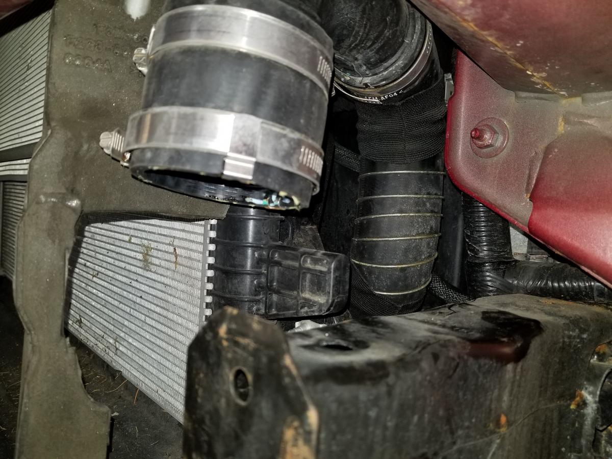

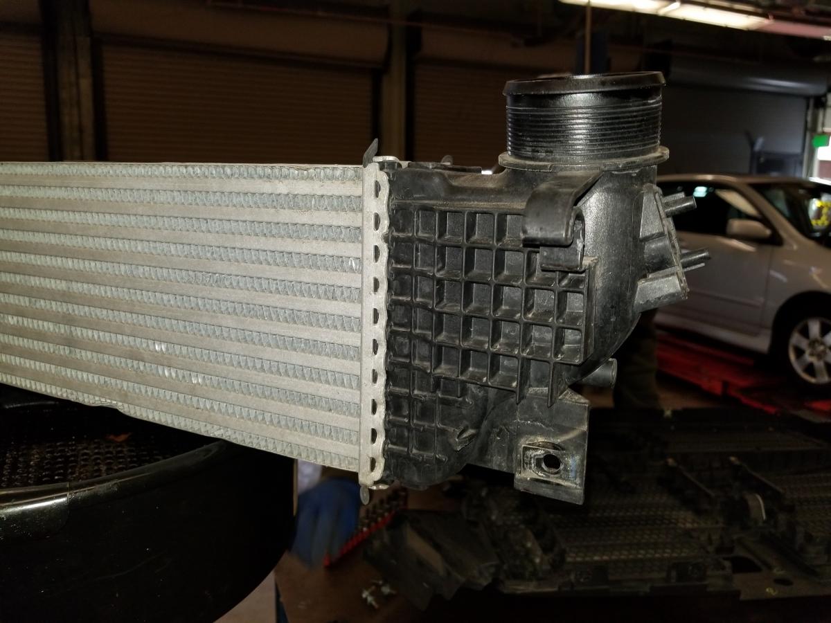

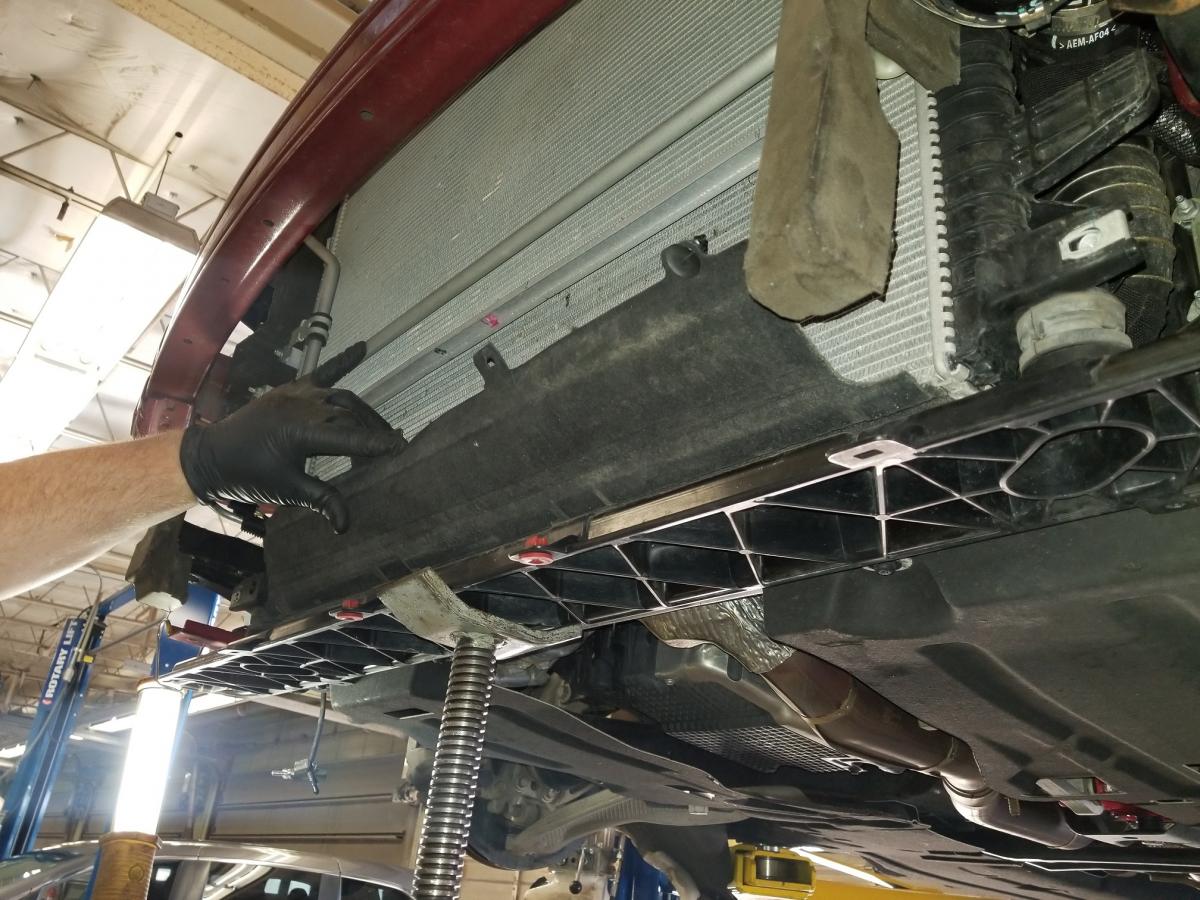

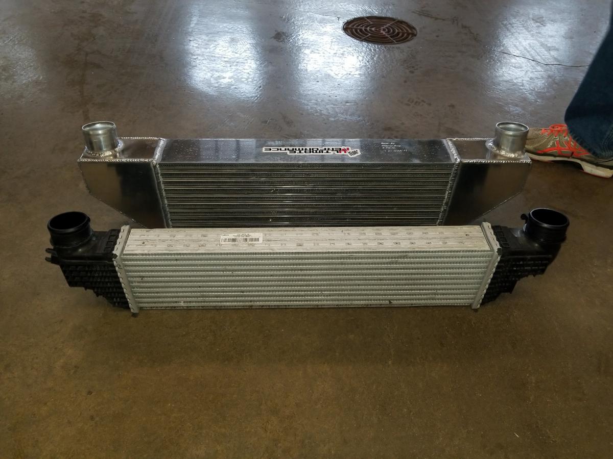

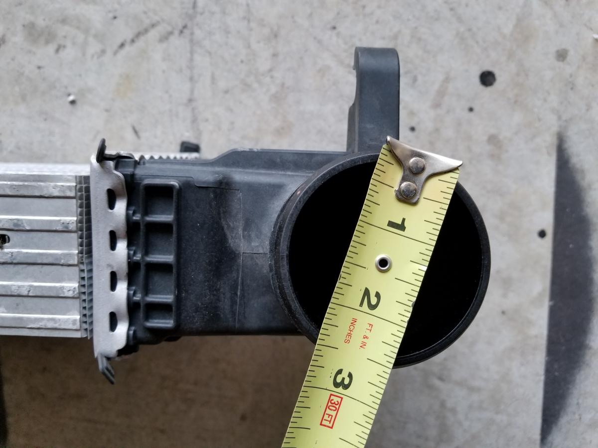

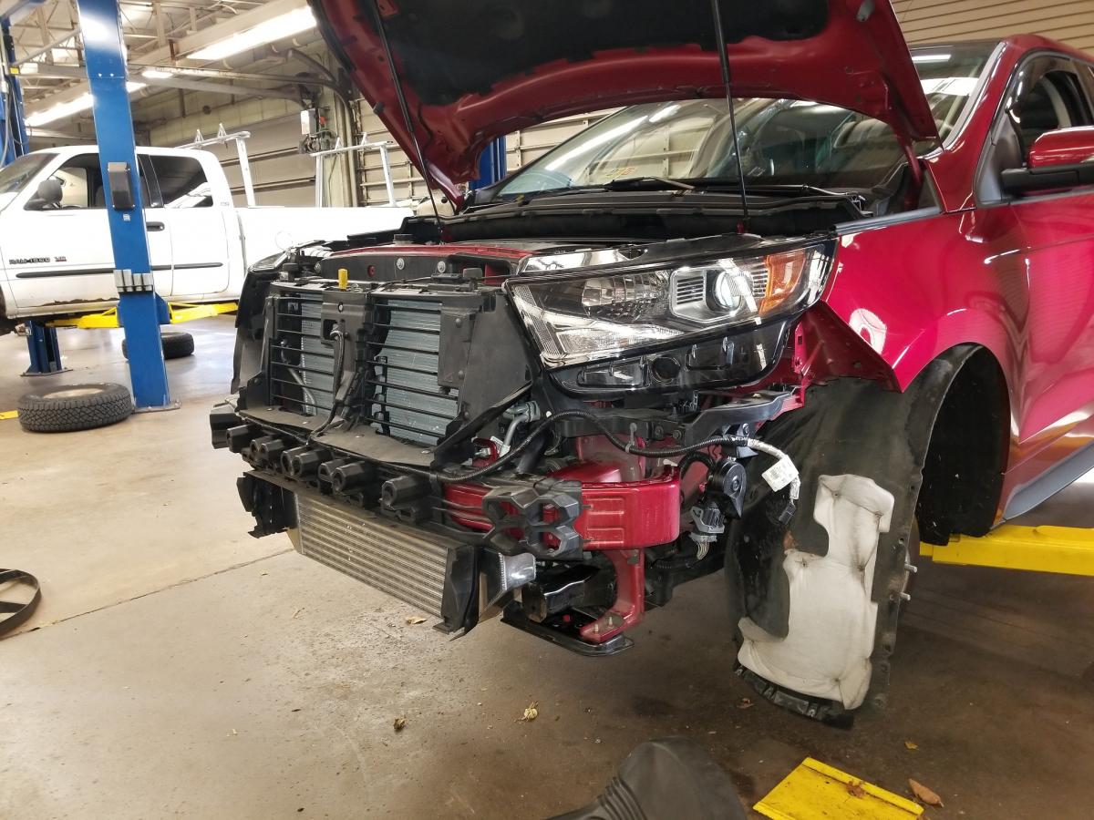

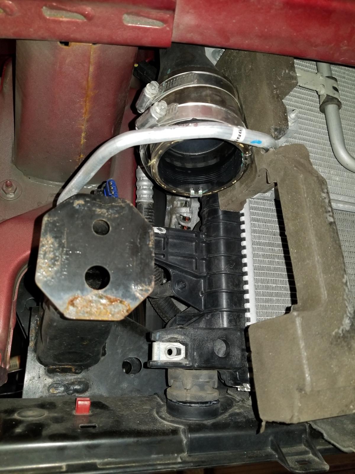

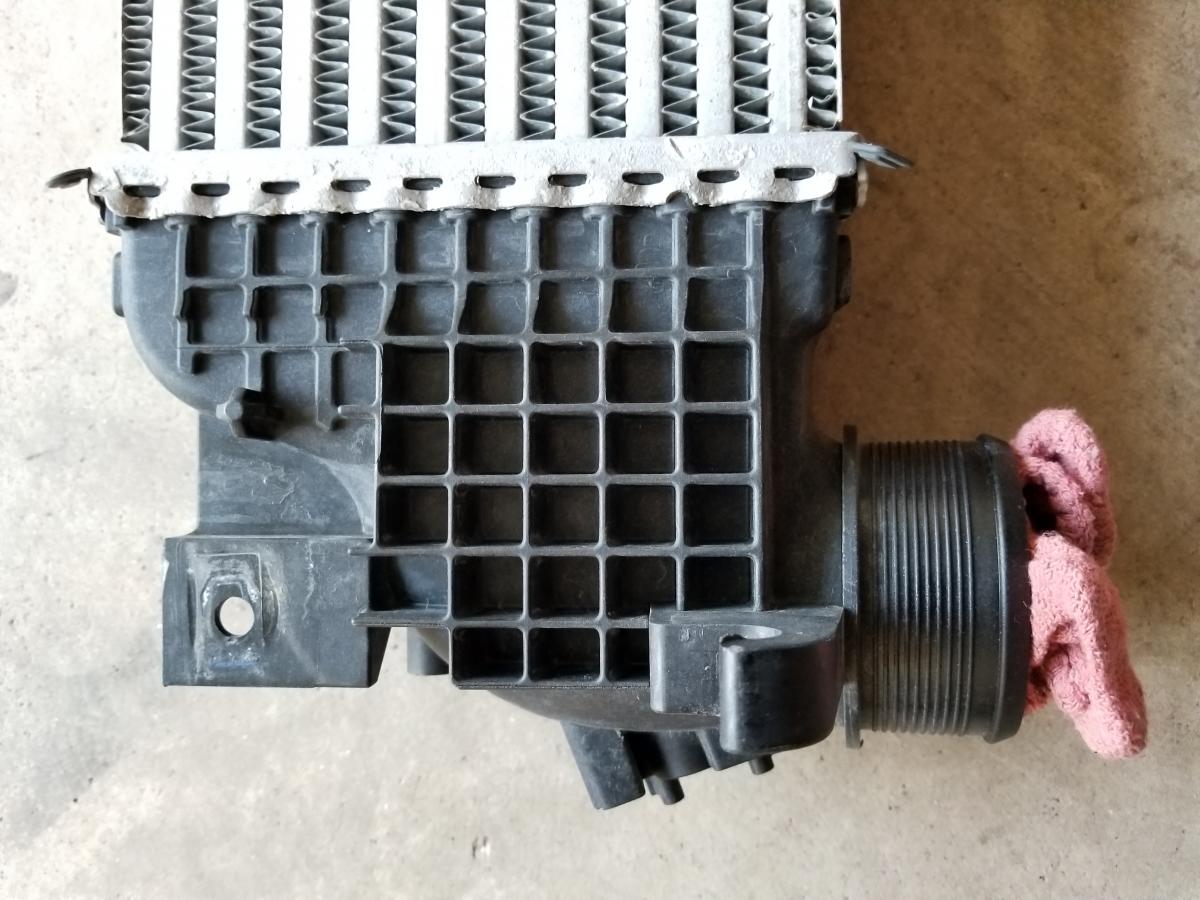

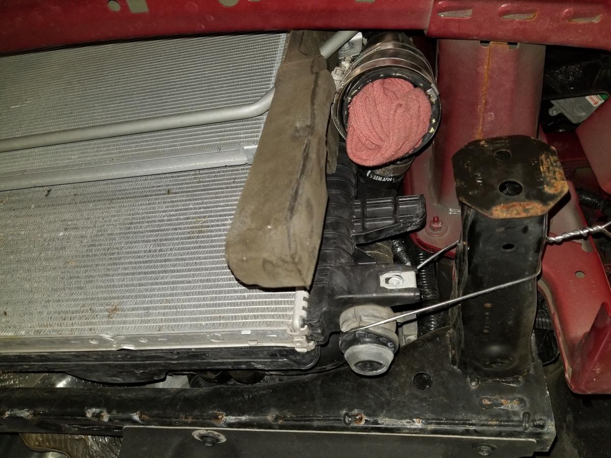

snmjim Posted December 10, 2017 Report Share Posted December 10, 2017 (edited) In an effort to keep the thread topics pure I'm responding to Mikula's IC Info request that he posted on the RMM topic thread here for the benefit of all.My Response:Ref attached Pics of the stock IC. Note: The two piping schematics are of the 2016-2017 Edge Sport & the 2017 Fusion Sport.However, due to CPe's direction to keep their proprietary Info confidential for now I cannot distribute Pics nor measurements.I can say that their striving for plug & play. At this point their considering to remove the 2 into 1 pipe on the hot side and go direct into the IC with dual inlets. This will be better for performance and allow cross compatibility with the Fusion Sport. I've also suggested they replace the cold outlet pipe with a consistent circumference pipe. Edited December 12, 2017 by snmjim 3 Quote Link to comment Share on other sites More sharing options...
GT500R Posted December 12, 2017 Report Share Posted December 12, 2017 (edited) I also took measurements for the stock intercooler since I have mine upgraded to 100% aluminum/bar&plate STOCK Core Overall L 25 7/8'' 37'' W 2 1/2'' 2 1/2'' H 6 1/8'' 8 1/4'' snmjim - interested in understanding how they would keep both pipes separate in such a tight space, but would be good for standardization across the platform Edited December 12, 2017 by GT500R 1 Quote Link to comment Share on other sites More sharing options...
snmjim Posted December 12, 2017 Report Share Posted December 12, 2017 (edited) On 12/12/2017 at 7:07 PM, GT500R said: I also took measurements for the stock intercooler since I have mine upgraded to 100% aluminum/bar&plate STOCK Core Overall L 25 7/8'' 37'' W 2 1/2'' 2 1/2'' H 6 1/8'' 8 1/4'' snmjim - interested in understanding how they would keep both pipes separate in such a tight space, but would be good for standardization across the platform Not sure how I can convey the 2 into 1 pipe (aka Y pipe) concept & room any better without specific questions... When U remove the Y pipe there is a space there which might allow for the dual pipe concept direct 2 the IC.... However, piping is the least of CPe's concerns at this point N the project. The big issue 2 B ID is will there B enough room behind the hot side of the IC 2 allow 2 inlet pipes that shoot straight back instead of one big pipe going up & ever so slightly back... All questions & concerns will B addressed once we get on the rack at CPe... Edited December 12, 2017 by snmjim 1 Quote Link to comment Share on other sites More sharing options...
Mikula Posted December 12, 2017 Report Share Posted December 12, 2017 (edited) On 12/12/2017 at 8:08 PM, snmjim said: The big issue 2 B ID is will there B enough room behind the hot side of the IC 2 allow 2 inlet pipes that shoot straight back instead of one big pipe going up & ever so slightly back... All questions & concerns will B addressed once we get on the rack at CPe... I know in most cases the hot inlets normally come from the same direction. but couldn't one inlet come from the top, one come from behind, or the side, or 45* angled from either? i don't know much about IC's, or if there is a particular reason both inlets generally come from the same direction. Since i have yet to remove my bumper to get a look at it, is there any space above the IC? I'm looking at some universal ones from a lot of different companies, but some are up to 11" tall, and i don't know what it looks like as far as space back/up/forward of the stock mount Edited December 12, 2017 by Mikula Quote Link to comment Share on other sites More sharing options...
snmjim Posted December 13, 2017 Report Share Posted December 13, 2017 On 12/12/2017 at 10:50 PM, Mikula said: I know in most cases the hot inlets normally come from the same direction. but couldn't one inlet come from the top, one come from behind, or the side, or 45* angled from either? i don't know much about IC's, or if there is a particular reason both inlets generally come from the same direction. Since i have yet to remove my bumper to get a look at it, is there any space above the IC? I'm looking at some universal ones from a lot of different companies, but some are up to 11" tall, and i don't know what it looks like as far as space back/up/forward of the stock mount Go back through this entire topic & there's a lot of Info & Pics 2 bring U up 2 speed. Also use this link 2 help U with the front: http://www.fordedgeforum.com/topic/23388-2016-sport-fascia-bumper-cover-etc-removal/ 1 Quote Link to comment Share on other sites More sharing options...

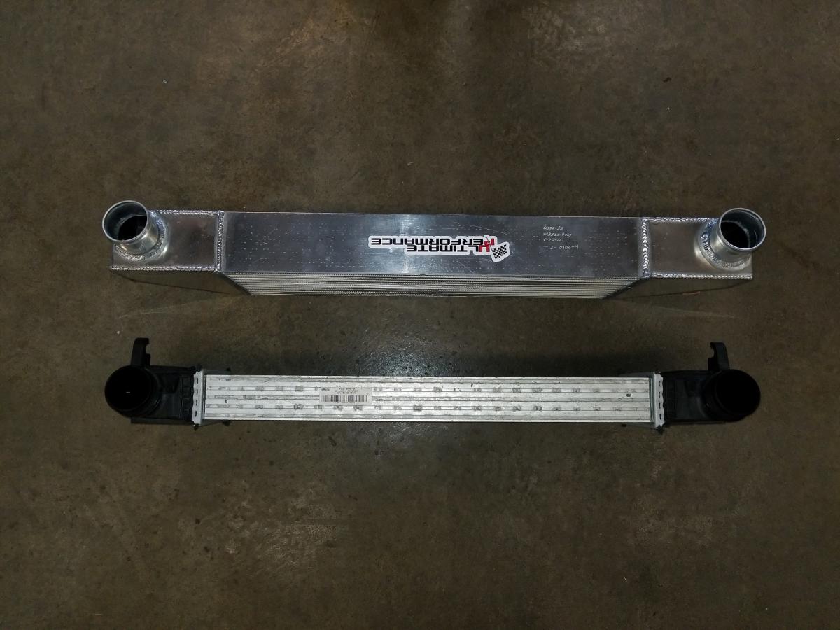

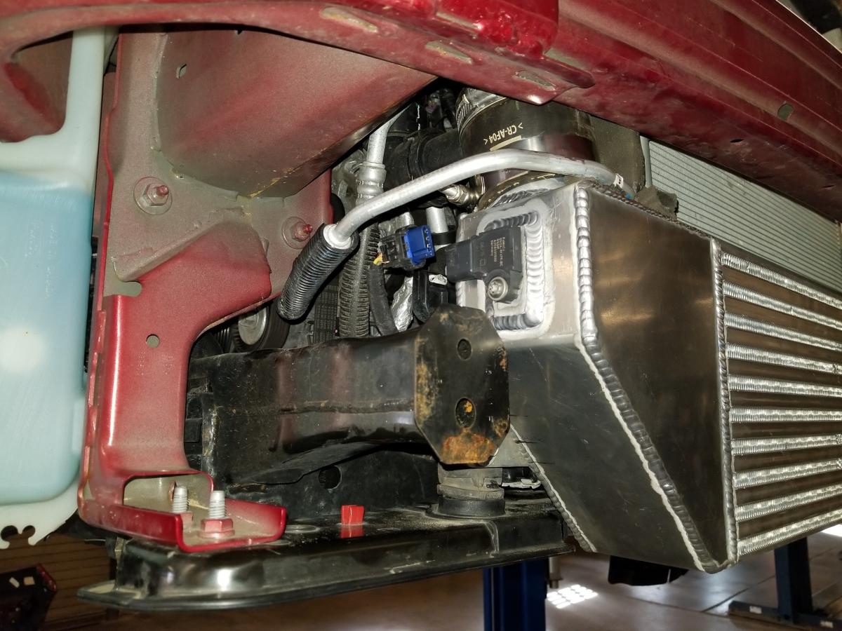

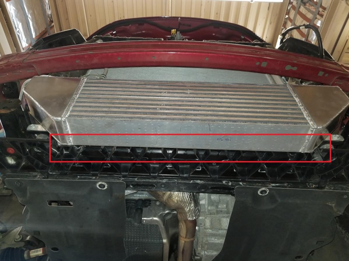

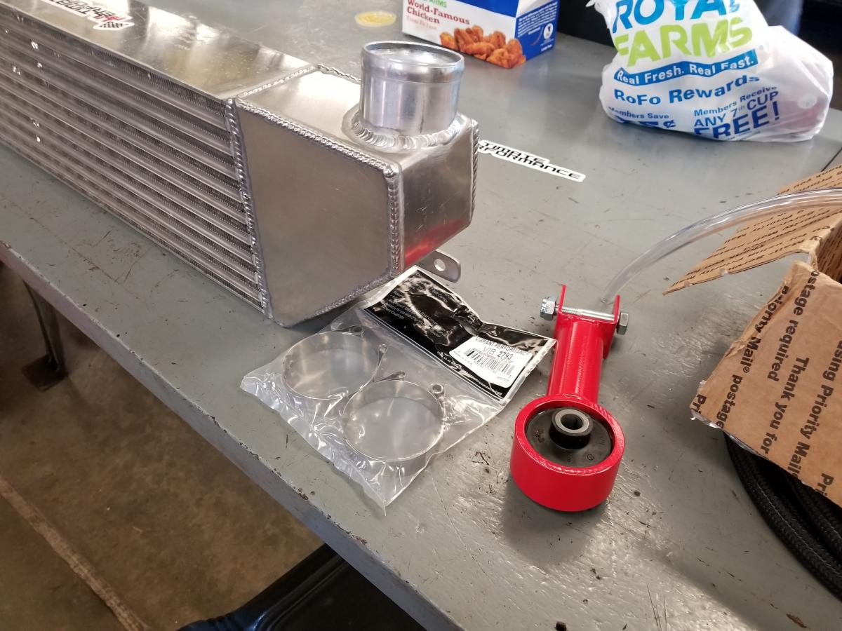

snmjim Posted January 3, 2018 Report Share Posted January 3, 2018 (edited) Lets start off with HAPPY NEW YEAR!... :happy feet: I realize that many of you have been patiently waiting for this information but unfortunately there are those who can find the time to take what we have to offer but can't find the time to give back. That being the case here, to spare you any further delay I'm going to at least provide the pics and highlight in red the areas of focus i.e. cutout modification. You can blame the hatchet job on the highlighted cut on the owner... Note: since this is going to be a large post I'll break it into three sections: - Comparative - Removal - Installation Here's the 1st of 3 posts: Comparative... Edited January 3, 2018 by snmjim 2 Quote Link to comment Share on other sites More sharing options...
snmjim Posted January 3, 2018 Report Share Posted January 3, 2018 (edited) Lets start off with HAPPY NEW YEAR!... I realize that many of you have been patiently waiting for this information but unfortunately there are those who can find the time to take what we have to offer but can't find the time to give back. That being the case here, to spare you any further delay I'm going to at least provide the pics and highlight in red the areas of focus i.e. cutout modification. You can blame the hatchet job on the highlighted cut on the owner... Note: since this is going to be a large post I'll break it into three sections: - Comparative - Removal - Installation Here's the 2nd of 3 posts: Removal... Edited January 4, 2018 by snmjim 1 Quote Link to comment Share on other sites More sharing options...
snmjim Posted January 3, 2018 Report Share Posted January 3, 2018 (edited) Lets start off with HAPPY NEW YEAR!... I realize that many of you have been patiently waiting for this information but unfortunately there are those who can find the time to take what we have to offer but can't find the time to give back. That being the case here, to spare you any further delay I'm going to at least provide the pics and highlight in red the areas of focus i.e. cutout modification. You can blame the hatchet job on the highlighted cut on the owner... Note: since this is going to be a large post I'll break it into three sections: - Comparative - Removal - Installation Here's the 3rd of 3 posts: Installation... Edited January 4, 2018 by snmjim 2 Quote Link to comment Share on other sites More sharing options...
Mikula Posted January 3, 2018 Report Share Posted January 3, 2018 looks like they did a decent job there. I wish ford would have made their design more like some of their other ecoboost engines. the air having to come down before passing through the IC then changing directions out of the other side is just a poor design. but then again, this isn't supposed to be a racecar! Quote Link to comment Share on other sites More sharing options...
