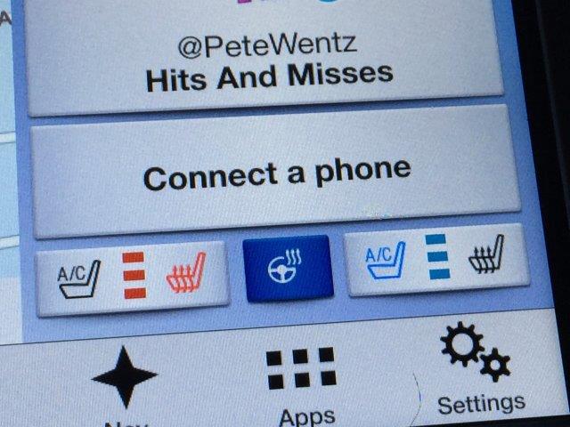

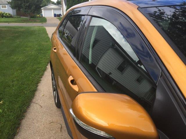

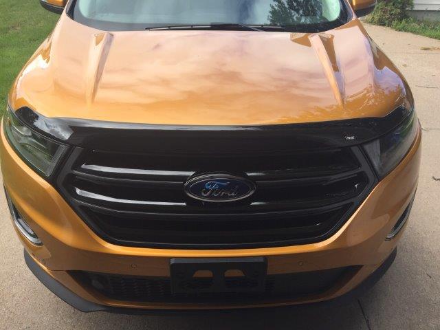

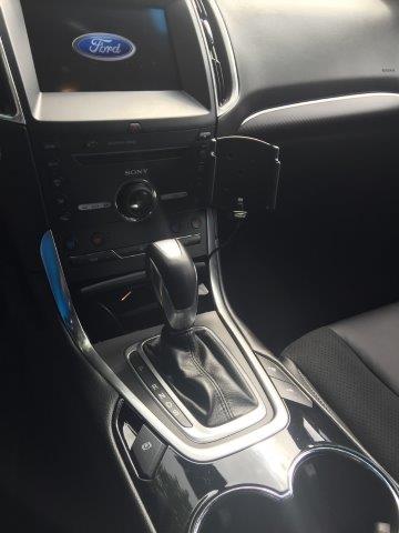

jmr061 Posted August 20, 2016 Report Share Posted August 20, 2016 (edited) At the end of July I purchased an Electric Spice 2016 Ford Edge Sport 401A with most if not all the additional options. Wanted to compile of list of things I have done to it: Hardware: Draw-Tite 75234 Class 3 Hitch with Trailer Light Wiring Kit AVS Low Profile Vent Visors #894035 AVS Aeroskin Hood Protector #322115 Wheel Lock Kit GR3Z-1A043-A Front Splash Guard Kit FT4Z-16A550-A JDM ASTAR AMBER LED FRONT PARK/TURN SIGNAL Pro-Clip USA Cell Phone Mount Remote Access Kit (Cell Phone control of remote start/lock/unlock) H15 Cree LED DRL Bulb Blackvue DR650S-2CH Dashcam System Software Modification (via IDS/Forscan) Added "Climate" to right side of Instrument Cluster Enabled and added Global CLOSE windows to Vehicle Settings in Instrument Cluster Added Heated Steering Wheel/Heated/Cooled Seat functions to HOME screen on SYNC3 Disabled Hyper-Flash for front turn signal (ie - disabled Lamp Detection Outage) Disabled Double Horn-Honk when leaving running vehicle with IA fob Current Project is to add OEM style Fog Lamps. I have the electronic side of things figured out (converted to a headlamp switch that turns on the fog lamps and enabled the fog lamp function in the instrument cluster) but having a lot of difficulty locating OEM fog lamp mounts. The kits advertised all over that have the fog lamp hole in the bezel don't have a mount for the light itself. I will add some pics when the weather clears up a bit...raining here. Edited August 28, 2016 by jmr061 2 Quote Link to comment Share on other sites More sharing options...
