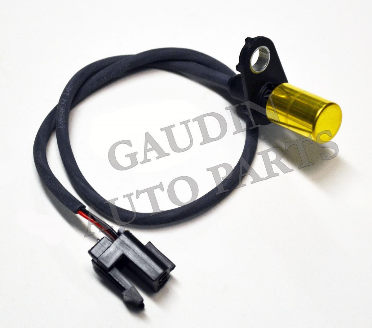

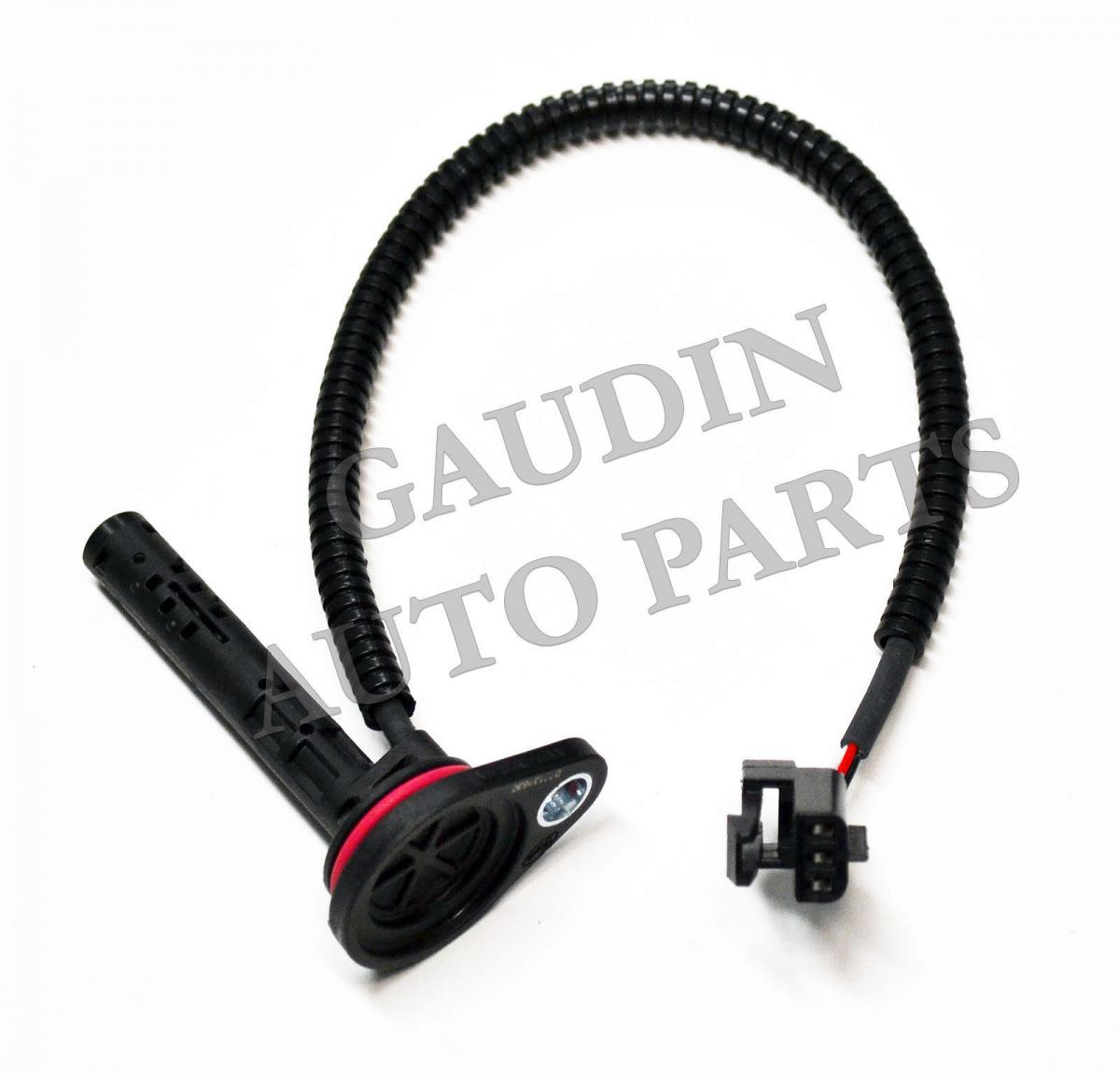

Katie Belton Posted August 14, 2016 Report Share Posted August 14, 2016 While driving down the highway today I felt a hard shift followed by the wrench warning light. I quickly pulled over and shut he car off for a few minutes. When I went to start it up again I felt a hard clunk, but no warning light. I turned it off again and when I restarted everything was fine... no light and running well. A little background: I've had the MKX for about a year and it occasionally shifts hard. I also had to have the PTU replaced about 6 months ago. Last week I had to replace the cooling fan and I used the quick replacement method. I'm wondering if I could have knocked something loose while replacing the fan. Based on other things I've read on the web, it seems like this could be an intermittent fluke that happens with Edges and MKXs. Any ideas? Also, what kind of code reader would an MKX owner buy and approximately how much do they cost? Thanks to everyone who helps on this site. It has been invaluable. 2 Quote Link to comment Share on other sites More sharing options...

WWWPerfA_ZN0W Posted August 21, 2016 Report Share Posted August 21, 2016 (edited) Any dealership should have both sensors. Also look to Autozone, they have Duralast branded sensors. NAPA should also carry both. TSS should be 8A8Z-7M101-A or very possibly AA5Z-7M101-A, Motorcraft DY1241 OSS should be AA5Z-7H103-B or Motorcraft DY1221 Edited August 21, 2016 by WWWPerfA_ZN0W 1 Quote Link to comment Share on other sites More sharing options...
Katie Belton Posted August 22, 2016 Author Report Share Posted August 22, 2016 I found the part that corresponds with the number for the TSS but partsgeek.com says it is for the 2011-2017 Edge. Is it the same part for both generations? Quote Link to comment Share on other sites More sharing options...
WWWPerfA_ZN0W Posted August 22, 2016 Report Share Posted August 22, 2016 should be same for 2007-2014 3.5's for sure (I think the 3.7's also). Not 100% on the 2015+ 3.5's 2007-10 http://www.fordpartsgiant.com/parts-list/2007-ford-edge/transmission-modules-and-sensors.html?Filter=(30393;36997) 2011-14 http://www.fordpartsgiant.com/parts-list/2011-ford-edge/transmission-modules-and-sensors.html?Filter=(30393;36997) Quote Link to comment Share on other sites More sharing options...
