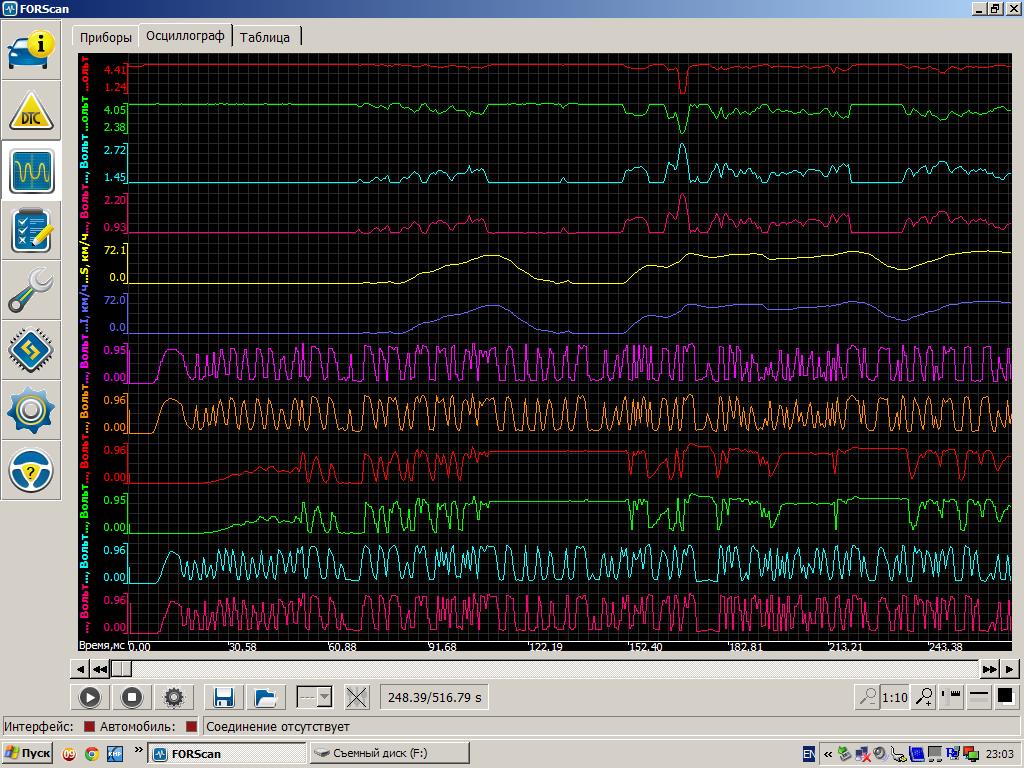

EDST777 Posted August 19, 2016 Author Report Share Posted August 19, 2016 (edited) Hi! It is Log (file 19082016.fsl ) http://my-files.ru/7f7m4y during driving, is about 15 minutes of different driving, quiet and with accelerations sharp when you presses a pedal of the accelerometer (45 km/h) and the car thinks two seconds, then sharply goes and gathers speed. I have taken all parameters correctly or something superfluous and it is possible to exclude? Edited August 19, 2016 by EDST777 Quote Link to comment Share on other sites More sharing options...

EDST777 Posted August 19, 2016 Author Report Share Posted August 19, 2016 It is csv-files 19082016.csv http://my-files.ru/m2uvet Quote Link to comment Share on other sites More sharing options...
WWWPerfA_ZN0W Posted August 20, 2016 Report Share Posted August 20, 2016 Do you normally have AC on (whether on MAX or VENT) during these datalogs? Unless you go WOT, the AC stays running and can delay throttle response. Quote Link to comment Share on other sites More sharing options...
EDST777 Posted August 20, 2016 Author Report Share Posted August 20, 2016 (edited) Yes, really the AC conditioner worked, I hoped that it will create additional loading, and it will be good for check. But today I have made check (15 min. driving) without AC (conditioner ) and I have added the output data in Forscan. Here today's Log without AC conditioner http://my-files.ru/szwsvd Edited August 20, 2016 by EDST777 Quote Link to comment Share on other sites More sharing options...
WWWPerfA_ZN0W Posted August 21, 2016 Report Share Posted August 21, 2016 The throttle response looks much better without the A/C running. Did it feel the same way to you? If so, I am not sure what can be changed for when you the A/C IS running, except maybe a tune for the PCM. At WOT, AC cuts out completely, so you don't see the throttle response delay. That is part of stock/OEM programming, probably for fuel economy/emissions reasons. Not really seeing what else could be the issue here ... 1 Quote Link to comment Share on other sites More sharing options...
EDST777 Posted August 21, 2016 Author Report Share Posted August 21, 2016 Thanks. Acceleration performance, on my feelings without AC, really better, but the engine too powerful what preciselyto feel huge distinction. I am disturbed by some delay as I specified earlier, at a sharp set of speed in the movement on the road, the car as thinks second or two and begins to go promptly. I heard, some people note such problem, it is really normal? Also I wanted to specify whether you from my check see an explicit problem with TPS? Thanks for the help. Quote Link to comment Share on other sites More sharing options...
WWWPerfA_ZN0W Posted August 21, 2016 Report Share Posted August 21, 2016 Nope, I do not see a problem with the TPS. I believe the delay to be related to the AC being in operation at the time, as determined by the PCM. I don't see anything in the TSBs either that could explain another reason for the delay, you can check yourself here: http://www.revbase.com/BBBMotor/Tsb/Results?Year=2010&Make=54&Model=5858 to check other years, simply substitute the YEAR value in the above URL. 1 Quote Link to comment Share on other sites More sharing options...

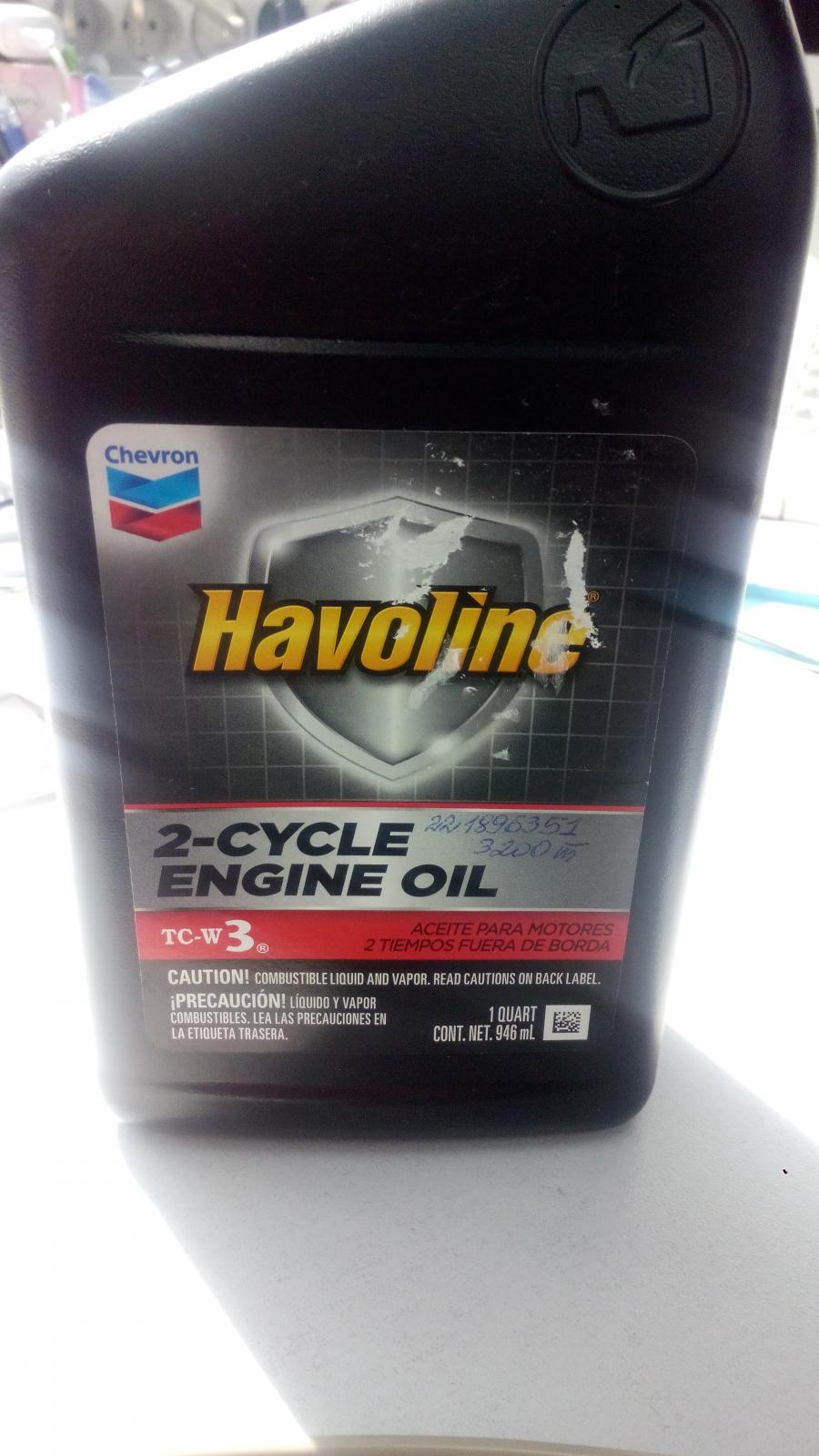

EDST777 Posted August 23, 2016 Author Report Share Posted August 23, 2016 Might be worth changing the Throttle Position Sensor on the throttle body, since you already tried cleaning the TB. If you can find some two stroke oil that meets the TC-W3 spec, try adding that 4 oz/tankful to the fuel (oil first, then fuel up). See if that helps. Made a difference on mine. I have shipped Shevron Havoline 2 - cycle engine oil Tc-W3. How you find it? Quote Link to comment Share on other sites More sharing options...
WWWPerfA_ZN0W Posted August 23, 2016 Report Share Posted August 23, 2016 Should be fine, it IS mineral oil based IIRC, but it meets the standard for TC-W3 and should work fine for what we are using it for. The ideal ratio will be somewhere between 4oz and 5oz per tankful of fuel. Put it in with every fillup. It took about 3 tankfuls to see the results on my Edge, it may work faster on yours, IDK. 1 Quote Link to comment Share on other sites More sharing options...
EDST777 Posted August 23, 2016 Author Report Share Posted August 23, 2016 Thanks, I will observe, after each full tank, however it is strange.... I read that it is synthetics?? Quote Link to comment Share on other sites More sharing options...
WWWPerfA_ZN0W Posted August 23, 2016 Report Share Posted August 23, 2016 In the USA, synthetic is not necessarily true synthetic (Europe is stricter). "True" synthetic is made from Group IV base stocks. This website (yes it could be biased in favor of Amsoil) shows the different types of oils that qualify as synthetic here: http://www.technilube.com/faqs_info/synth_diff.php An overview of the different Groups of base stocks: http://www.machinerylubrication.com/Read/29113/base-oil-groups 1 Quote Link to comment Share on other sites More sharing options...
