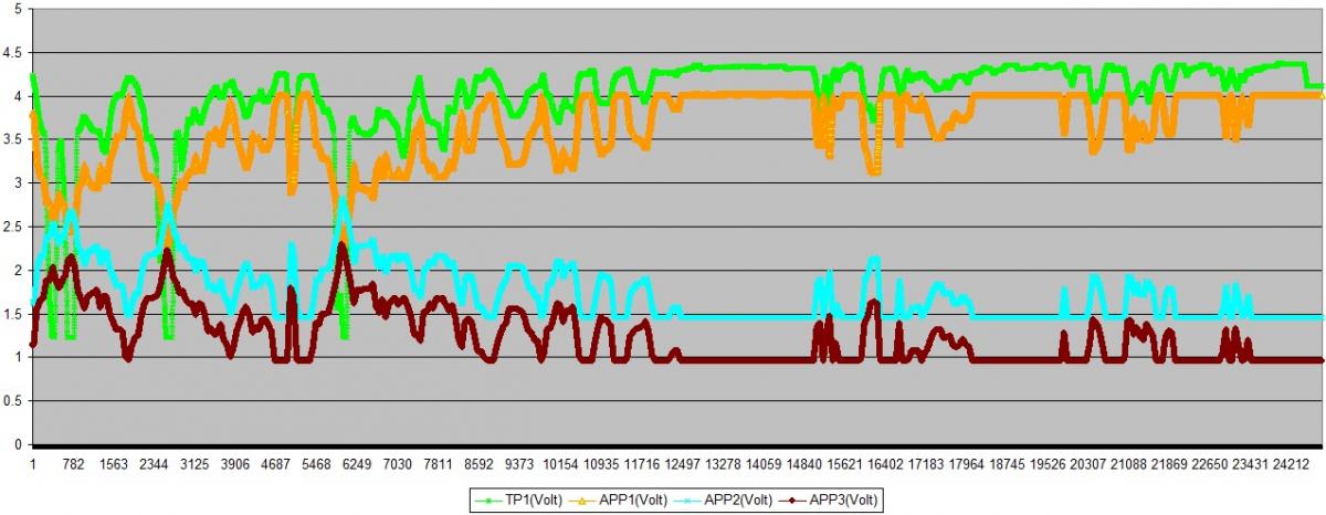

WWWPerfA_ZN0W Posted August 14, 2016 Report Share Posted August 14, 2016 With Forscan, you can track the TP1 PID, which shows you the TPS response to input. Technically speaking, the acceleration pedal position sensor is the first input to the PCM when you press the gas pedal. So you should track APP1, APP2, and APP3 also. Together they give you a better picture of the car's responsiveness to your inputs. Log the data and graph it. TP1 and APP1 should look similar; APP2 & APP3 should follow each other closely, and be the mirror image of APP1. Should look something like this: Note that this graph is drawn from driving around data, but for a real test, you should provide as few variables as possible. So map out what data points you want to capture, then log them. For example, idle with no pedal input. Idle to 2000 rpm with steadily increasing input. Idle to 2000 rpm with a throttle snap. Hold at 2000 rpm for 10 seconds. That kind of thing. Then you get an idea of the responsiveness of the TP and APP sensors. Unfortunately, on this generation of the Edge, we don't have a way to track injector performance individually through software, a digital voltmeter is required. Ecoboost engines you can. 2 Quote Link to comment Share on other sites More sharing options...
EDST777 Posted August 14, 2016 Author Report Share Posted August 14, 2016 Thanks, is very important information, I very much appreciate it, I will try to do measurements tomorrow. 1 Quote Link to comment Share on other sites More sharing options...

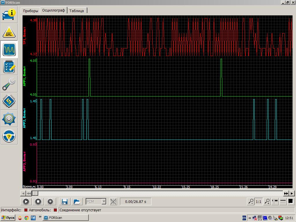

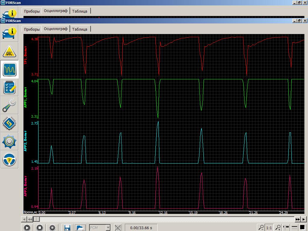

EDST777 Posted August 15, 2016 Author Report Share Posted August 15, 2016 (edited) If you can find some two stroke oil that meets the TC-W3 spec, try adding that 4 oz/tankful to the fuel (oil first, then fuel up). The oil type matters: mineral or synthetic? For example MOTUL OUTBOARD 2T corresponds to TC-W3, but it is mineral. How you will advise? Thanks. Today I did check of Forfscan, errors is not noticed. I have made measurements, according to the specified scheme, I attach images:1-without loading (just the engine idle running), 2-(gradual increase in turns till 2000 works), 3-intermittent increase (kicks) approximately to 2000,4 - deduction of turns for 2000 within 10-12 seconds. Edited August 15, 2016 by EDST777 Quote Link to comment Share on other sites More sharing options...
WWWPerfA_ZN0W Posted August 15, 2016 Report Share Posted August 15, 2016 These tests were done from a cold start? If so, can you repeat them with a hot start, i.e., after the engine is warmed up? I dont normally rev the engine when its cold, but it's been like 90F mornings here lately, so an acceptable compromise I guess. I will check for myself in cold start conditions and post later. If you have access to synthetic TC-W3, that is preferred, because the additive package will be better. Technically as along as the product meets the TC-W3 specifications, it should work. Maybe you can test to see the difference for yourself. 1 Quote Link to comment Share on other sites More sharing options...
EDST777 Posted August 15, 2016 Author Report Share Posted August 15, 2016 Yes, it is valid, the first image has been made on cold start, the engine has not been heated-up yet. I will repeat it on heated-up. Well, I understand, synthetic oil for 2T of TC-w3 will be more preferable. I have an access to it. Thanks! Quote Link to comment Share on other sites More sharing options...

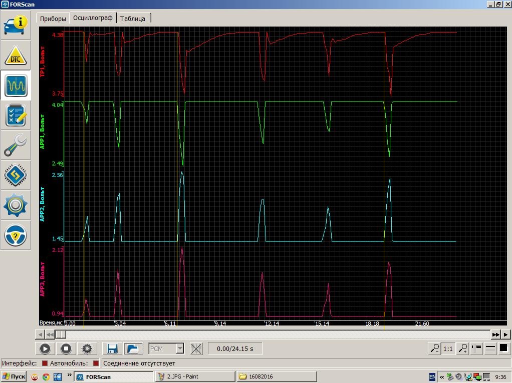

EDST777 Posted August 16, 2016 Author Report Share Posted August 16, 2016 (edited) Hi. Now my repeated checks FORScan on the hot engine in the same sequence 1,2,3,4. So: Edited August 16, 2016 by EDST777 Quote Link to comment Share on other sites More sharing options...
WWWPerfA_ZN0W Posted August 16, 2016 Report Share Posted August 16, 2016 There might be a very small possibility of an issue with a gradual input with the gas pedal. Snapping the gas pedal seems to have the expected response from the throttle. You could try taking the TPS off the throttle body, take a good look at the sensor AND the gears on the throttle body to see if there is any dirt/corrosion. Clean the sensor with electronic parts/MAF cleaner only. Let it dry out, reassemble and see if that makes a difference. Did you have the hangup at 3000 rpm happen when the Edge was running well, before the issues with the TSS/OSS started? Did you disconnect the battery while you were working on the sensors? The engine was off when you cleaned the throttle body? Might just need to pull the negative battery cable for 30 minutes or more and let the PCM reset/relearn. There is a YT video on this, if you can access it: If you DID disconnect the battery, and for long enough, how many KMs have you put on since then? The PCM relearn can take some time if you don't follow the drive cycle. 1 Quote Link to comment Share on other sites More sharing options...
