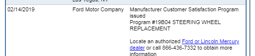

Amerikaner83 Posted February 21, 2019 Report Share Posted February 21, 2019 Looking to purchase a 2016 Sport, and the Carfax lists this as being issued, how can I tell if it's actually gotten done before I buy the thing (CPO from dealer)? I could ask them, but is there any way to VERIFY it's been done? Quote Link to comment Share on other sites More sharing options...
onyxbfly Posted February 21, 2019 Report Share Posted February 21, 2019 (edited) 25 minutes ago, Amerikaner83 said: Looking to purchase a 2016 Sport, and the Carfax lists this as being issued, how can I tell if it's actually gotten done before I buy the thing (CPO from dealer)? I could ask them, but is there any way to VERIFY it's been done? Ask the dealer for an OASIS report. The OASIS report is a detailed list of any and all service/ warranty work that has been done at any Ford Dealership. If the repair has been reported to carfax then its a pretty good chance that the work has been done. This is a list of everything that is checked under the CPO program. https://www.ford.com/certified-used/about-certified/inspection/ Edited February 21, 2019 by onyxbfly 1 Quote Link to comment Share on other sites More sharing options...
Amerikaner83 Posted February 21, 2019 Report Share Posted February 21, 2019 (edited) OASIS report? Hmm what's that? Edit - oh ok, it's basically Ford's internal "what we did" report. I figure if it's being sold as a CPO from this dealer, they will perform the work if they haven't already. edit 2 - To clarify, Carfax isn't stating the work has been done - it's simply showing the issuance of the "Customer Satisfaction Program" Edited February 21, 2019 by Amerikaner83 2 Quote Link to comment Share on other sites More sharing options...
omar302 Posted February 22, 2019 Report Share Posted February 22, 2019 @Amerikaner83 Even if it was not yet done on the, this will done under no cost to the owner, even if the warranty is over. You don't need to worry about it. 1 Quote Link to comment Share on other sites More sharing options...
