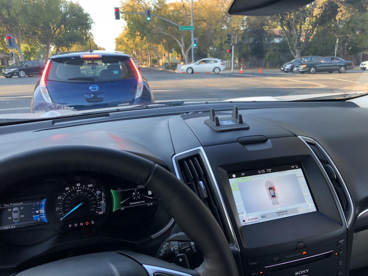

luxpow Posted August 11, 2016 Report Share Posted August 11, 2016 My 2016 Edge's left side sensors keep giving false alarms. Whenever parking, even when something is far away, it shows complete left side as red on the screen. Its random : sometimes the problem goes away completely but sometimes it starts showing red even when I am on the road stopped at red light. Maybe moisture or loose connection inside. I would like to see the wiring/fuse etc. to see if something obvious. Any idea where to look ? Dont want to visit the dealer unless absolutely required. Quote Link to comment Share on other sites More sharing options...

omar302 Posted August 11, 2016 Report Share Posted August 11, 2016 (edited) The side obstacle detection on newer Fords works by estimating the distance of an obstacle after it was detected by the front/rear side sensors. In other words, if you are parked & a stroller or a karts comes from the side at a door, the sensors will not detect it. Only if the car was moving & the front side sensors detected it, then it will estimate how close this object is to the side of the car as you move on. That's the reason why in the owners manual, "Side Sensing System", it states the following: The side sensing system may not be available until you have driven approximately the length of your vehicle in order for the system to reinitialize if: You switch the ignition on, off and back on. Your vehicle remains stationary for over two minutes. The anti-lock brake system is activated. The traction control system is activated. Ok, so what I mean, if the vehicle suddenly detects something from the side, as you explained, while stopped at the light, I'd say it is a module issue, not simple wiring and/or moisture on the sensors. Take it to the dealer. Edited August 11, 2016 by omar302 1 Quote Link to comment Share on other sites More sharing options...
t0lkman Posted October 27, 2018 Report Share Posted October 27, 2018 (edited) any idea how to fix it? Dealer couldn't do anything.. they say, they couldn't reproduce it on the traffic light, but during parking the sensors behaved correctly Edited October 27, 2018 by t0lkman Quote Link to comment Share on other sites More sharing options...
THE_BOLT Posted November 1, 2018 Report Share Posted November 1, 2018 I have this same issue happening. Mine warns that there is something on the left side big enough to have the 2 red bars light up for both driver side doors. It happens usually with the first couple stops after sitting for roughly 8 hours...but it doesn't happen all the time, not even weekly. When it happens I still look to see if anything is there but there is nothing...not even a small tree branch. I've taken it to the dealer but they couldn't reproduce the issue. Also it seems to happen only in cooler weather 1 Quote Link to comment Share on other sites More sharing options...
