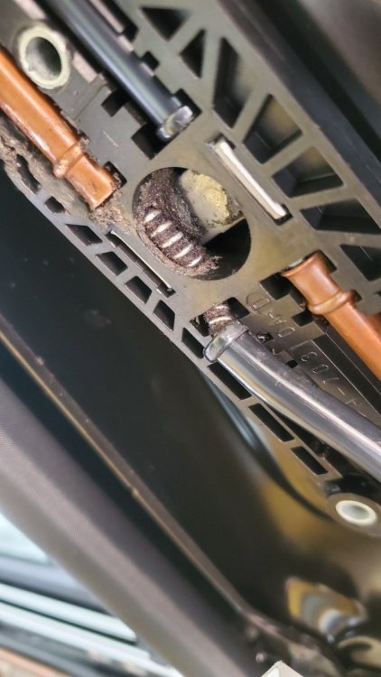

ryanlink Posted April 27, 2022 Report Share Posted April 27, 2022 (edited) Thanks - I'm familiar with the initialization sequence and have tried it several times. The problem is that the glass won't fully close because the cable won't extend that far, which is the first step in the process. I can get the shade to close under the open glass, which shouldn't happen, and tried to initialize it there, but it didn't have any effect other than maybe moving the glass a hair closer to closed. You can see in this video what's happening. The driver's-side cable guide that's getting hung up has about twice as much side-to-side play as the guide in the passenger-side track. Nothing is in the track to impede it, which is something the Sunroof Doctor suggested to check for, like a rivet or something. I'd really like to avoid paying $2800 to get this fixed. Hoping someone has experience with the cables and motors. I haven't found a video of those yet. Edited April 27, 2022 by ryanlink added "because the cable won't extend that far" Quote Link to comment Share on other sites More sharing options...

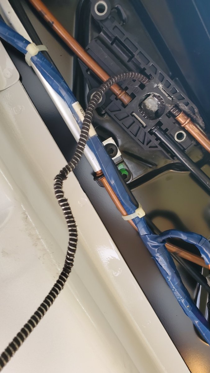

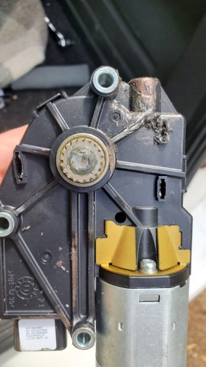

ryanlink Posted April 29, 2022 Report Share Posted April 29, 2022 @Haz thanks for the schematics. I pulled off the glass motor and discovered, as I suspected, an issue with the cable. Looks like at some point it popped out of the channel and got a pretty nasty kink/twist in it. I'll have to order a replacement, cut off the old cable at the kink to get it out, feed the new one through, and take the track off again to connect it to the guide. 2 1 Quote Link to comment Share on other sites More sharing options...
