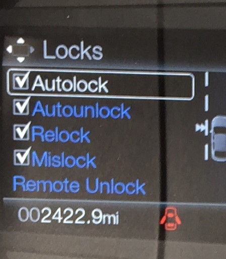

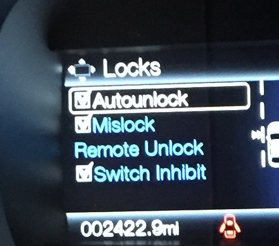

jmr061 Posted September 4, 2016 Report Share Posted September 4, 2016 It looks to be possible to add it to the cluster. 4 Quote Link to comment Share on other sites More sharing options...
lildisco Posted September 4, 2016 Report Share Posted September 4, 2016 (edited) It looks to be possible to add it to the cluster. That's awesome! How'd you manage that one in FORScan? Edited September 4, 2016 by lildisco Quote Link to comment Share on other sites More sharing options...
