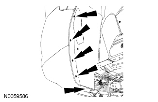

Here is the procedure to remove the rear bumper cover for the MKX. (The Edge is similar).
1. Remove the scrivets from the rear bumper cover.
2. Remove the 10 screws (5 each side) from the rear splash shield.

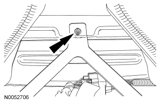

3. Remove the rear bumper cover-to-body brace screw.

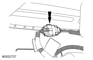

4. Disconnect the trailer hitch and parking aid system wiring harness, if equipped.

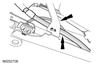

5. Disconnect the retainers from the rear bumper cover-to-body brace.

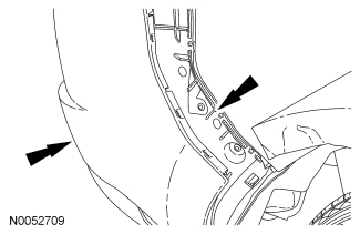

6. Remove the rear bumper cover.
7. Remove the bumper cover from the bumper cover bracket.
Remove the bumper cover.
