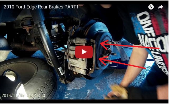

EDST777 Posted April 17, 2017 Report Share Posted April 17, 2017 Hello. There was video where it is possible to learn how to remove a rear rotor. A secret is revealed. Thanks to the author. To look about 2:53 minutes. Quote Link to comment Share on other sites More sharing options...
EDST777 Posted April 17, 2017 Report Share Posted April 17, 2017 (edited) I think that for those who want to reuse a rear rotor it is better to strike blows to the places specified by red shooters. Edited April 17, 2017 by EDST777 1 Quote Link to comment Share on other sites More sharing options...
