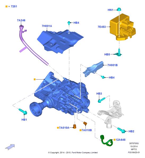

WWWPerfA_ZN0W Posted August 18, 2016 Report Share Posted August 18, 2016 Factory manual would have you remove the PTU (in 2007-14), but it is not necessary to do so, even with the lack of a proper drain plug. Not sure on the 15+, but it looks like there is a drain plug from the fordparts.com pics: http://www.fordparts.com/Commerce/RenderIllustration.ashx?id=390180942&f=3&n=F2GZ7A246C Callout Name: 7A010A Part Number Part Description Price Your Price Availability Quantity 7A010A Auto Trans Oil Drain Plug 4WD 2.7L Dual Over Head Cam 4V DI GT V6 GAS/FFV Less Hot Weather Group Hot Weather Improvement Pack 1 1 Quote Link to comment Share on other sites More sharing options...

omar302 Posted August 25, 2016 Report Share Posted August 25, 2016 Ford knows that heat kills the PTU, hence they extended the warranty on them for those in very hot countries & even provided the replacements with drain valves with ~9K or ~18K mile drain/refill intervals. http://www.fordedgeforum.com/topic/13533-13m01-middle-east-ptu-extended-warranty/ Quote REASON FOR PROVIDING ADDITIONAL COVERAGE Extended high speed vehicle operation in high ambient temperatures, in conjunction with off-road driving in sand, may result in sludging of the fluid within the PTU and/or seal leaks. PTU sludging typically produces symptoms such as a whining noise while driving or clunk/harsh engagements when shifting to drive or reverse. Continued driving in these environmental conditions may damage the PTU and result in a loss of AWD functionality. Affected vehicles can still be driven in FWD mode if the PTU function is compromised. Quote SERVICE ACTION If dealer diagnosis indicates that the PTU requires replacement, dealers are authorized to replace it with a new Middle East Service PTU that contains a drain plug, which enables convenient fluid replacement at regular intervals. Dealers are also to apply a sticker to the inside cover of the vehicle Owner Guide that details revised fluid replacement maintenance intervals of 30,000 kilometers for normal use, and 15,000 kilometers for severe duty/sand driving use. At the conclusion of the repair, dealers are to provide vehicle owners with an Owner Information Card, which details the revised fluid replacement maintenance intervals. 1 Quote Link to comment Share on other sites More sharing options...
