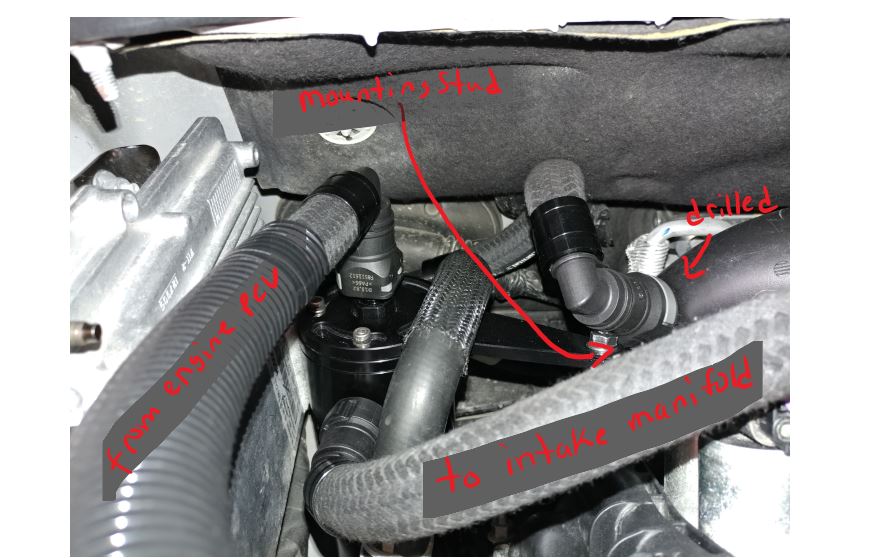

Beezz Posted May 6, 2017 Author Report Share Posted May 6, 2017 UPR Kit is installed. You can essentially buy the f150 kit and there is a few minor changes needed to make it 'fit' on the edge. The mounting for the cans is quite awkward. It'll be a pain to drain them, but since the smaller can is on the front side of the engine it'll be easy to guess when the larger one needs to be drained. LMS had the edge for 5 days to adapt the kit to it. It cost more than I had hoped. Ill post labelled pictures of the install soon. If you want to install it, it should be relatively simple considering you'll have an idea of what goes where. Also I talked with both managers at my local dealer and they both said that the warranty isn't voided as long as any issues that come up aren't a direct result of the catch can system. 2 Quote Link to comment Share on other sites More sharing options...
1004ron Posted May 6, 2017 Report Share Posted May 6, 2017 On 5/6/2017 at 5:24 AM, Beezz said: UPR Kit is installed. You can essentially buy the f150 kit and there is a few minor changes needed to make it 'fit' on the edge. The mounting for the cans is quite awkward. It'll be a pain to drain them, but since the smaller can is on the front side of the engine it'll be easy to guess when the larger one needs to be drained. LMS had the edge for 5 days to adapt the kit to it. It cost more than I had hoped. Ill post labelled pictures of the install soon. If you want to install it, it should be relatively simple considering you'll have an idea of what goes where. Also I talked with both managers at my local dealer and they both said that the warranty isn't voided as long as any issues that come up aren't a direct result of the catch can system. Looking forward to the pictures and additional detail. Quote Link to comment Share on other sites More sharing options...

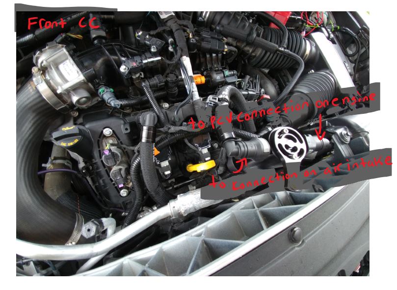

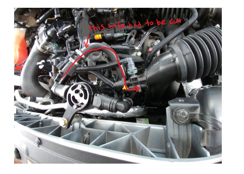

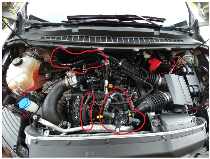

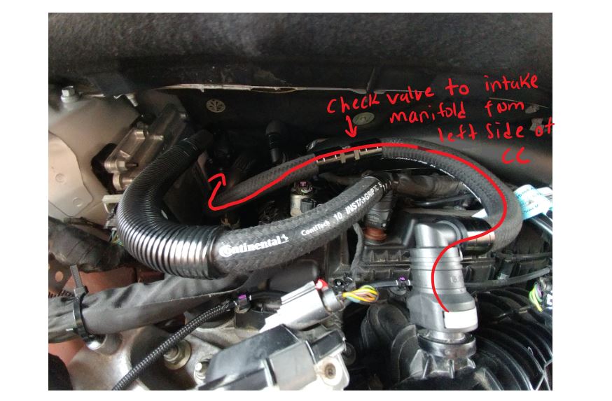

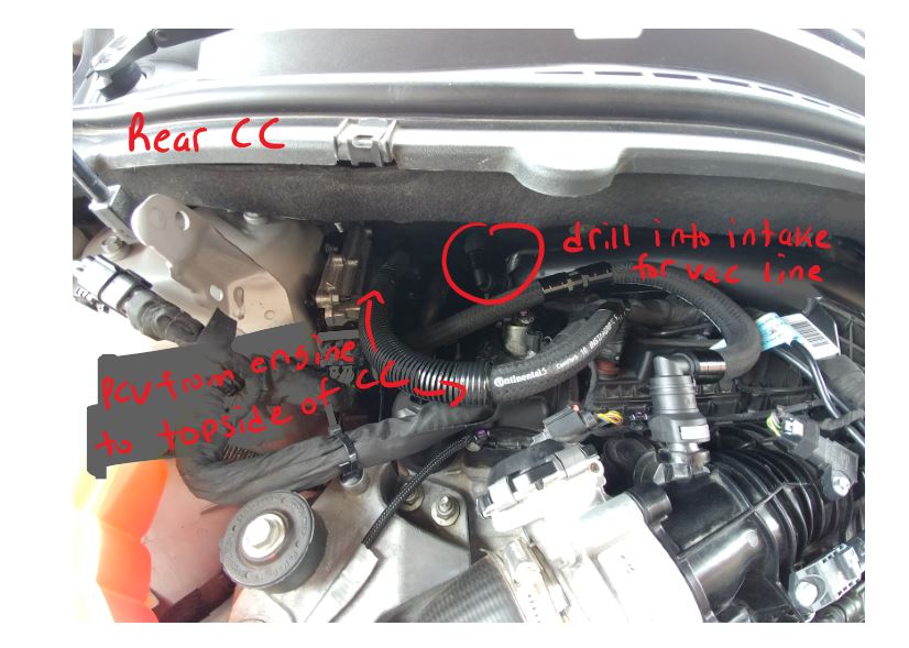

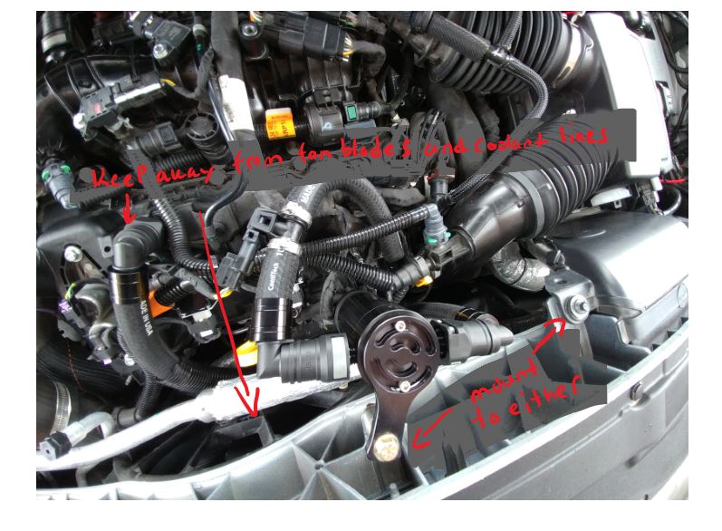

Beezz Posted May 6, 2017 Author Report Share Posted May 6, 2017 (edited) Some labelled pictures (attached). The guide from UPR should also be consulted (I dont have a copy). The engine cover probably wont fit after installing all the hoses. The mounting of the CC's is a bit awkward but thats expected with the limited space. I'll also check which direction the check-valves are in when I get a chance to, but they should be facing away from the CC's on the rear. All in all LMS did a good job. Guides: There is videos and forum posts about the UPR kit not working, or not catching anything. I will update at my next oil change in about 2000 km with pictures of what was, or wasn't captured by the kit. Edited May 8, 2017 by Beezz 2 Quote Link to comment Share on other sites More sharing options...
