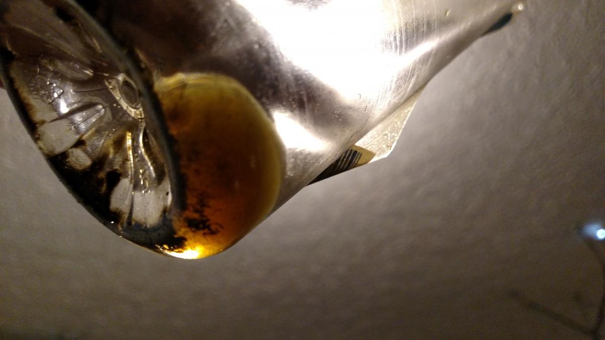

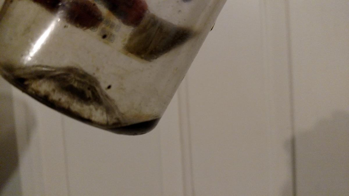

lildisco Posted March 2, 2017 Report Share Posted March 2, 2017 Here's what my Catch Can has caught in 400+ miles on my 2.0 Ecoboost. Well worth the investment to not have this being regurgitated back into the engine. We usually don't beat on the car & usually city/country roads with very little highway & full synthetic oil since around 2,000 miles. Currently around 12,500 miles. Quote Link to comment Share on other sites More sharing options...
