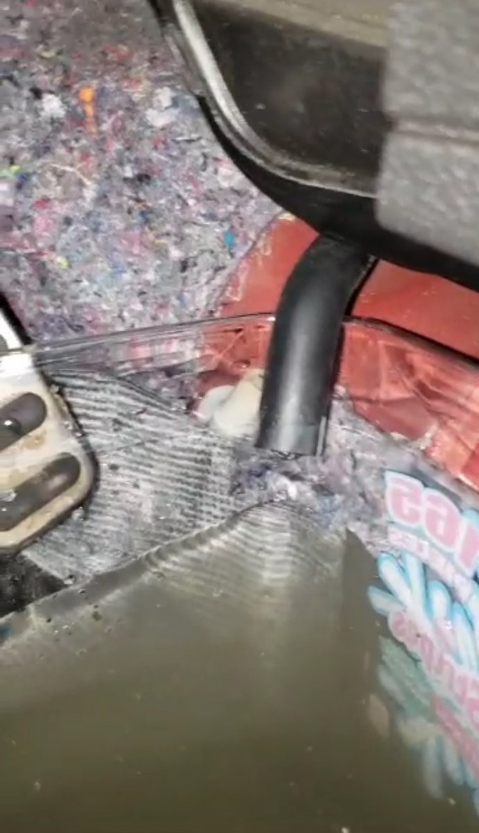

hamlett22 Posted June 3, 2023 Report Share Posted June 3, 2023 ON my Ford Edge 2013- Water was backed up somewhere and splashing out at our feet and mostly on the the passenger side floor. I disconnected the drain hose under the carpet right next to the accelerator pedal behind the center console and blew air 'downward' through the white tube. Nothing. it was open. then i grabbed a container and did a very short burst of compressed air upward into the black tube. Boom. Loads of water came out: almost 1/2 a gallon. Ran the car and air-con and water dripped down and under the car as normal through the drain tube. Thanks for the advice and pointers. Quote Link to comment Share on other sites More sharing options...
