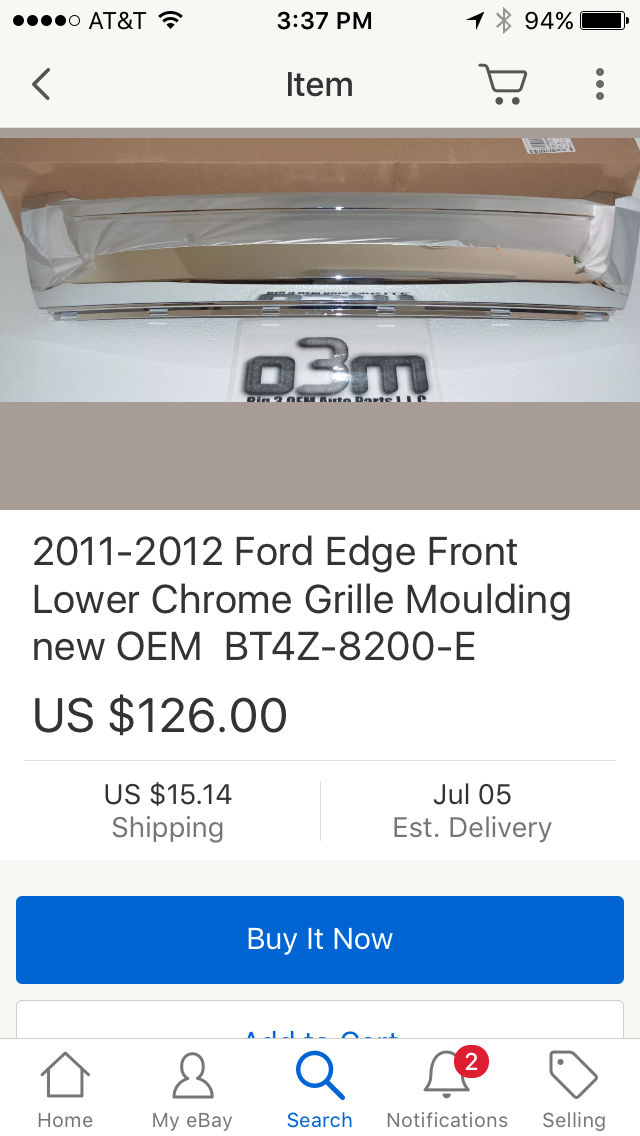

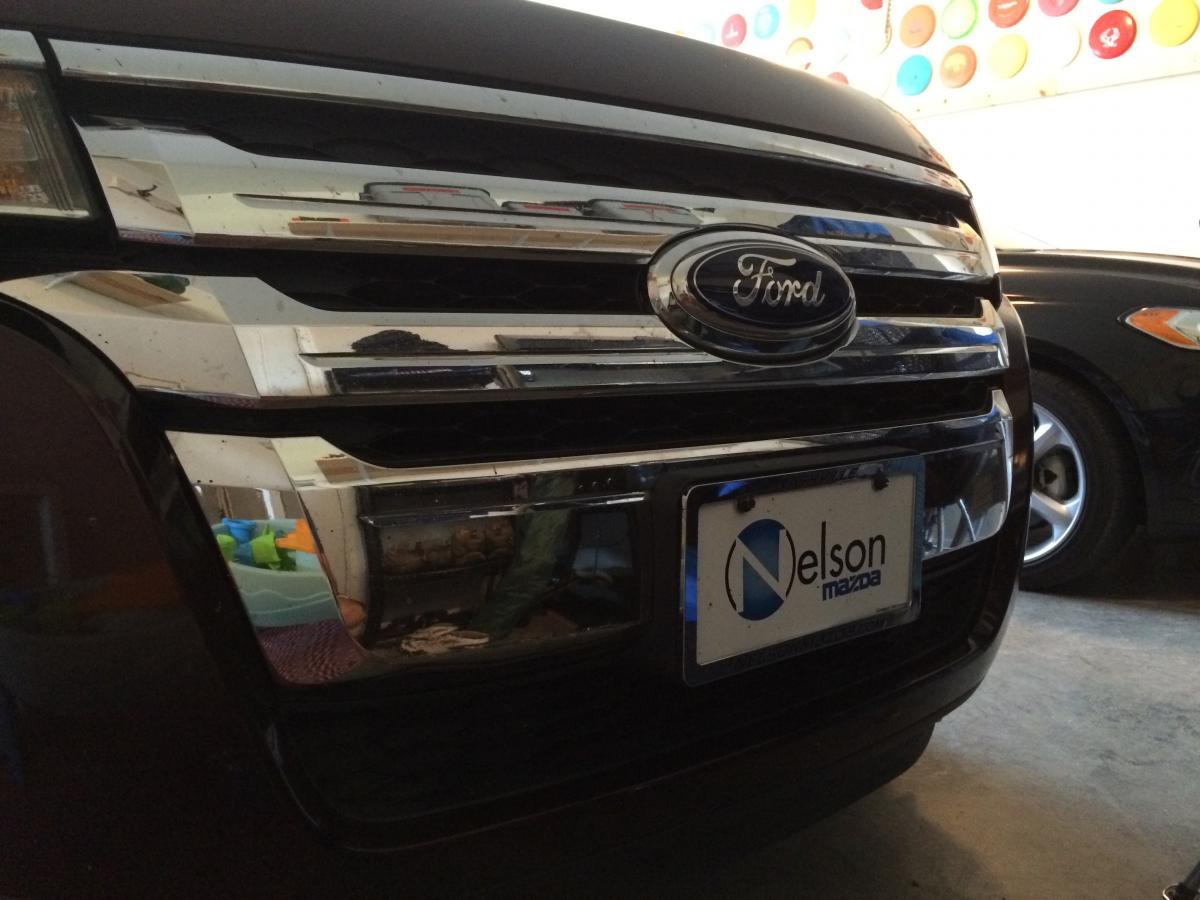

TrevDehm Posted June 28, 2016 Report Share Posted June 28, 2016 Has anyone changed out the lower chrome grille? I recently purchased a 2012 and the bottom grille had some chrome flaking and a license plate bracket (which isn't needed in TN). Am I able replace without removing the front bumper. I just replaced the Ford emblem and noticed the tabs from the rest of the grille, just not sure about the bottom. Thanks for your input. Quote Link to comment Share on other sites More sharing options...

TrevDehm Posted July 1, 2016 Author Report Share Posted July 1, 2016 Plasti dipped looks good. Just trying to keep it clean with a stock look, especially since it's the wife's. I own the 2015 fusion in the background. If I can remove the bottom chrome grille to replace that would be preferred. $140 for a brand new, non license plate front end would be great. Quote Link to comment Share on other sites More sharing options...
