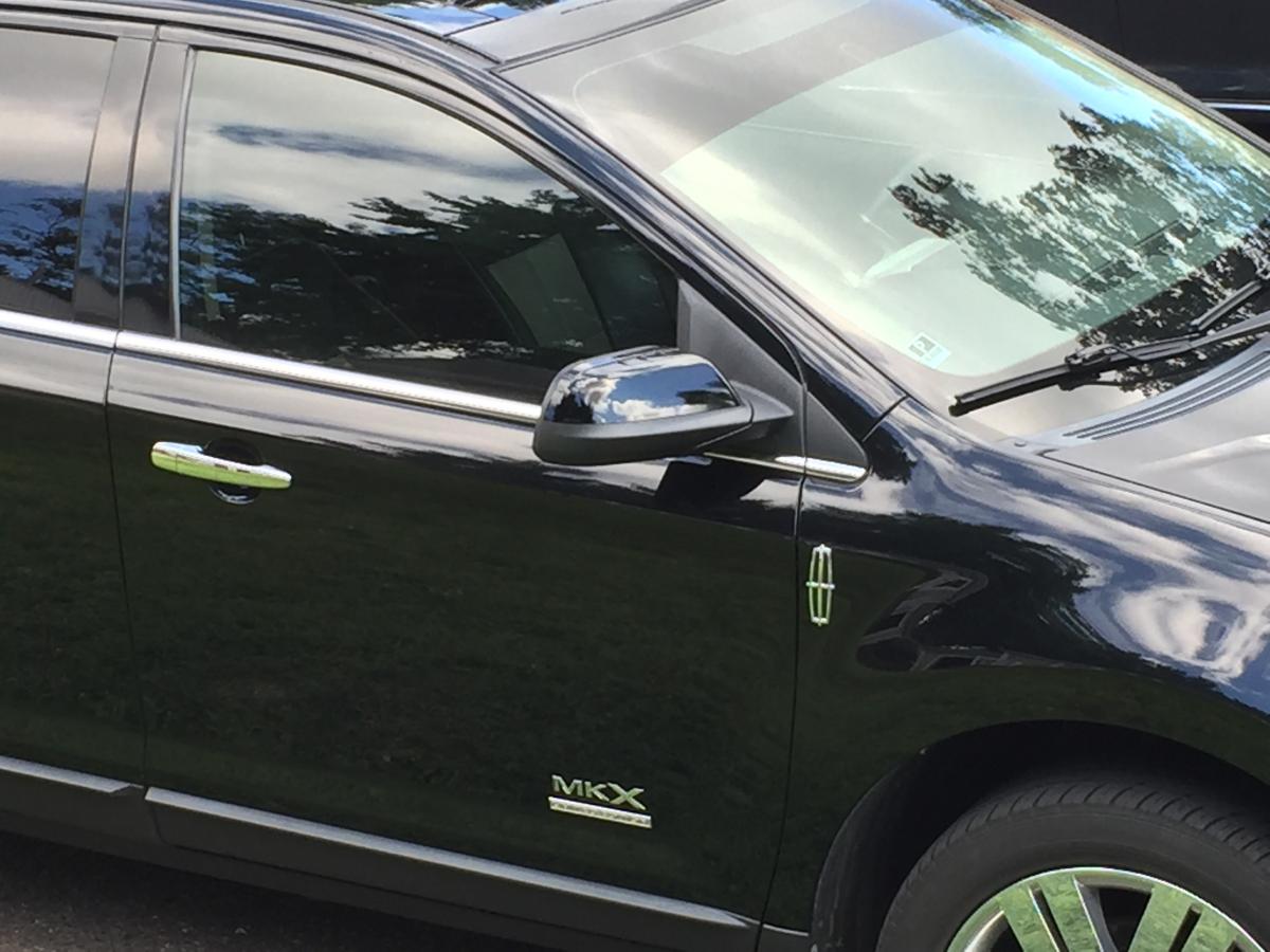

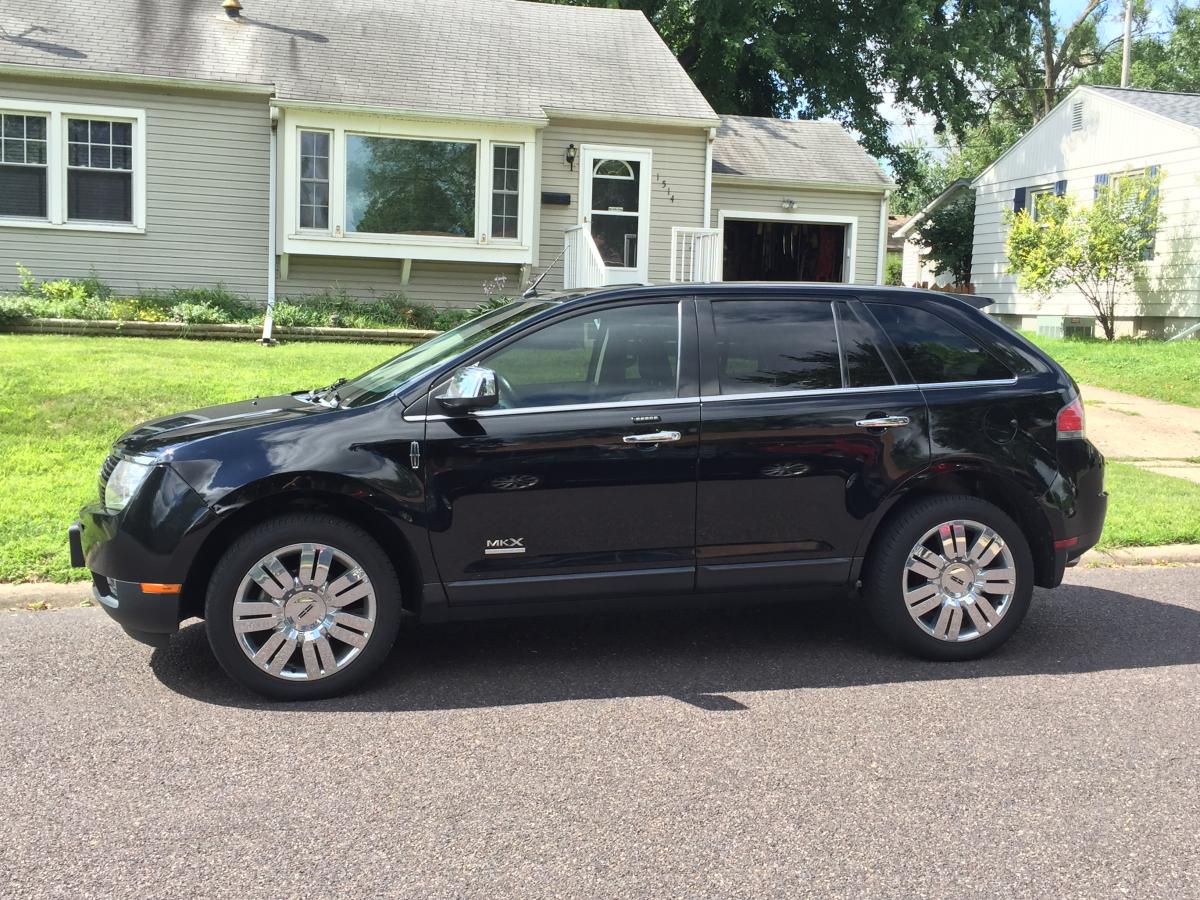

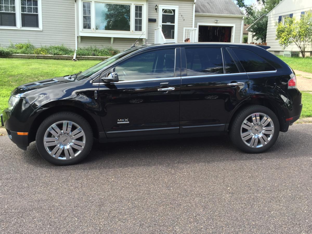

Ok folks.... Just got the new, freshly painted 11-14 Edge Mirrors installed on my 09 MKX. Looks pretty dang sharp if you ask me but I'm biased.
Before:
After:
Before:
After:
Before:
After:
Before:
After:
...and After again:
