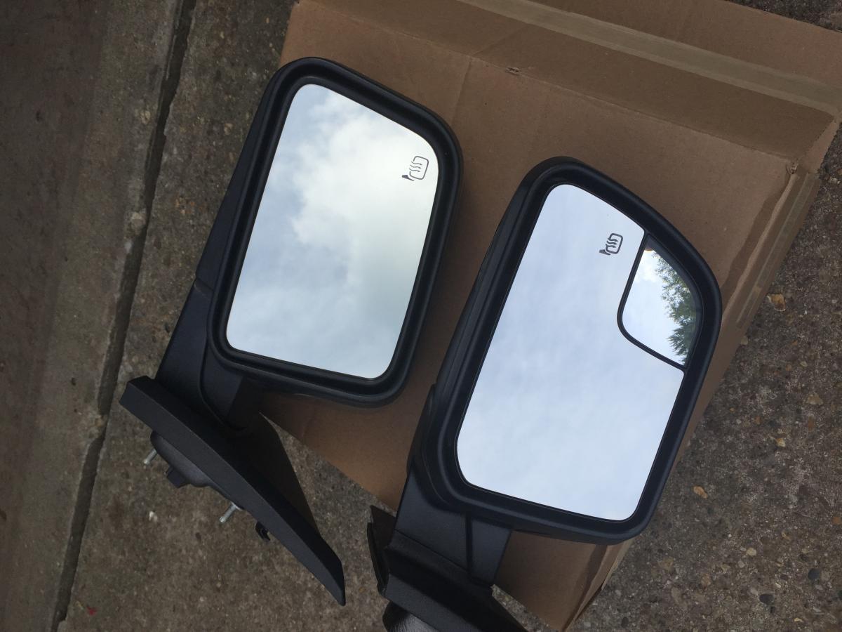

MikeKiloXrayOhNiner Posted July 7, 2016 Author Report Share Posted July 7, 2016 Success!! The new 2011-2014 mirror was delivered about 5 minutes ago. Got it bolted onto my 2009 and it plugged right in no problem. Everything works great. Ordering the passenger side mirror in a couple minutes. When that comes in, I'll get the mirror caps painted to match the car and we'll be in business. I'll post some pics of today's mock-up in a little while. Quote Link to comment Share on other sites More sharing options...
MikeKiloXrayOhNiner Posted July 7, 2016 Author Report Share Posted July 7, 2016 Size comparison... New one with blind spot mirror, old without. Original mirror... New mirror... 2 Quote Link to comment Share on other sites More sharing options...
