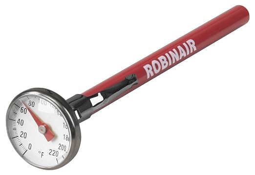

WWWPerfA_ZN0W Posted June 29, 2016 Report Share Posted June 29, 2016 I have found that it doesn't FEEL like it's cooling when the Edge has been parked in the sun for some time. Might take a couple of minutes. The practical test is to stick a thermometer into the vent and see how quickly it gets to 40F. Takes about a minute or less on mine on MAX A/C. Quote Link to comment Share on other sites More sharing options...

Bobs2015EdgeSport Posted June 29, 2016 Author Report Share Posted June 29, 2016 Yeah, I have one of those A/C thermometers; using that to test with will be next! Interestingly enough, today it was 85-degrees outside, and the car, of course, felt like an oven inside. I started it up and it blew very hot air for my first half-mile, before it started to blow even slightly-cooler air inside... and that was after I gave up using the normal setting and put it onto MAX. After a couple of miles of freeway driving, the air was icy cold again... but it still seems to me that this kind of thing shouldn't even be an issue. Maybe I'm expecting too much of the newer R134A systems. Where's that good old R12 refrigerant systems when you need them? Now, those really knew how to blow cold air! LOL! 1 Quote Link to comment Share on other sites More sharing options...
