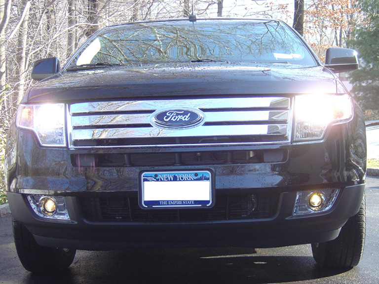

NYEdge Posted February 23, 2008 Report Share Posted February 23, 2008 did you just do simple yellow bulb swap out or an actual HID 2-3000k kit in yellow? I swapped the bulbs with MTEC MT-494 H11 12v 55W 3300K. Here's a daytime photo. Quote Link to comment Share on other sites More sharing options...
Lex Talionis Posted February 25, 2008 Report Share Posted February 25, 2008 I swapped the bulbs with MTEC MT-494 H11 12v 55W 3300K. Here's a daytime photo. have you seen some of the HID photos versus yours? I am curious... for the not as crucial fogs... is that why you went the bulb route versus HID kit route for that reason? How do you think your bulbs look versus photos of HID kit fogs? I can see on fogs doing bulbs for as little use as I get in CA. But curious your own feedback. Quote Link to comment Share on other sites More sharing options...
NYEdge Posted February 25, 2008 Report Share Posted February 25, 2008 To tell you the truth, a daytime photo (which I happened to have on file in my computer) of my fogs or other photos of HID fogs, or other photos of stock v. HID headlights don't really show too much difference. I think that you will only see the real difference in person. That being said, I'm totally satisfied with the results that the bulb swap gave me. I've put a lot of money into my Edge and various other vehicles that I own and will always make my decision on parts or upgrades based on the best end result and not the monetary cost. Here's my 2 cents: buy a set of replacement bulbs on ebay or the local auto parts store, install them and see what you think. You'll spend a couple of bucks to see in person how they perform and if you don't like it you only spent a couple of dollars compared to a HID kit, which you could always install later. Good luck. Quote Link to comment Share on other sites More sharing options...
