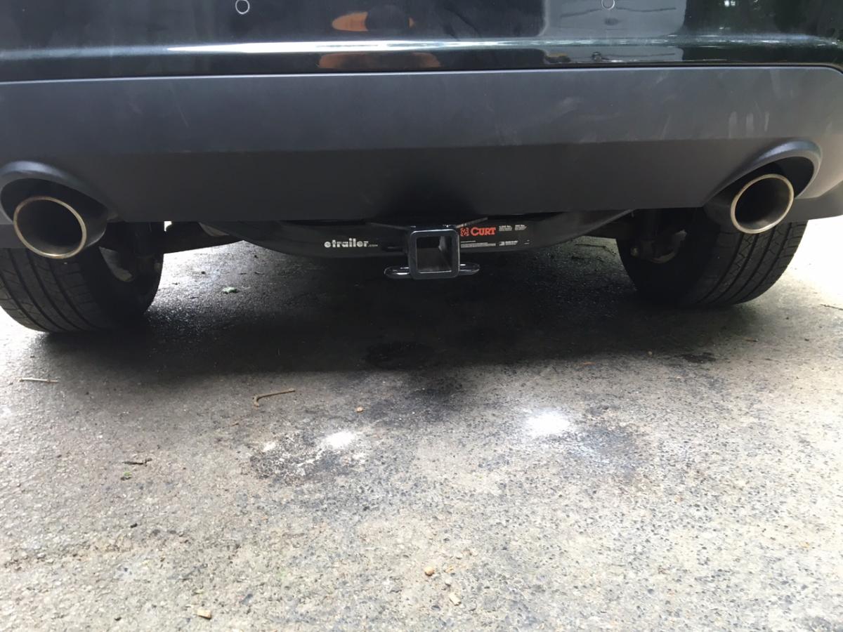

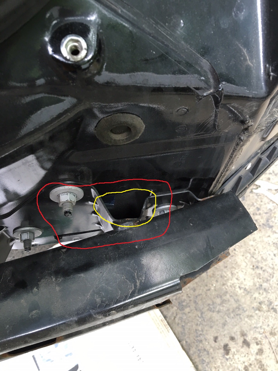

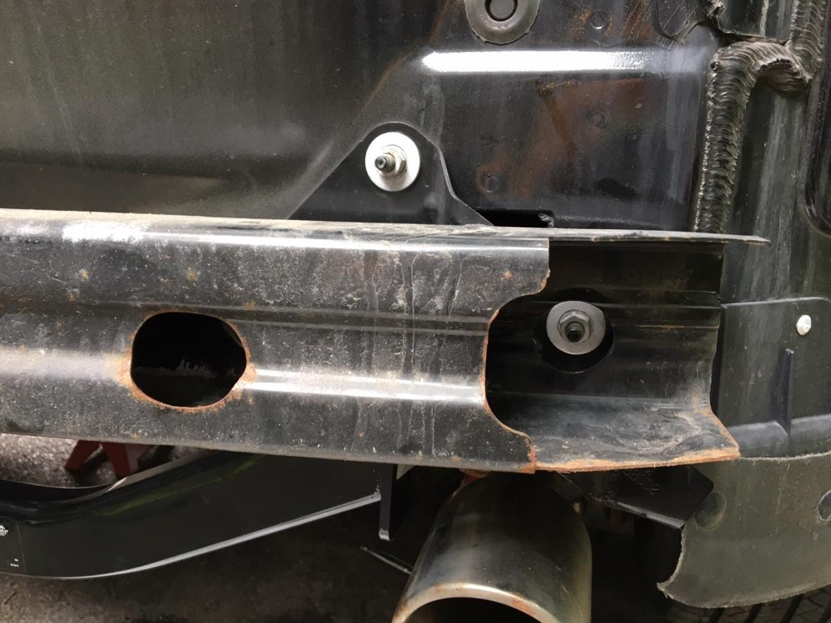

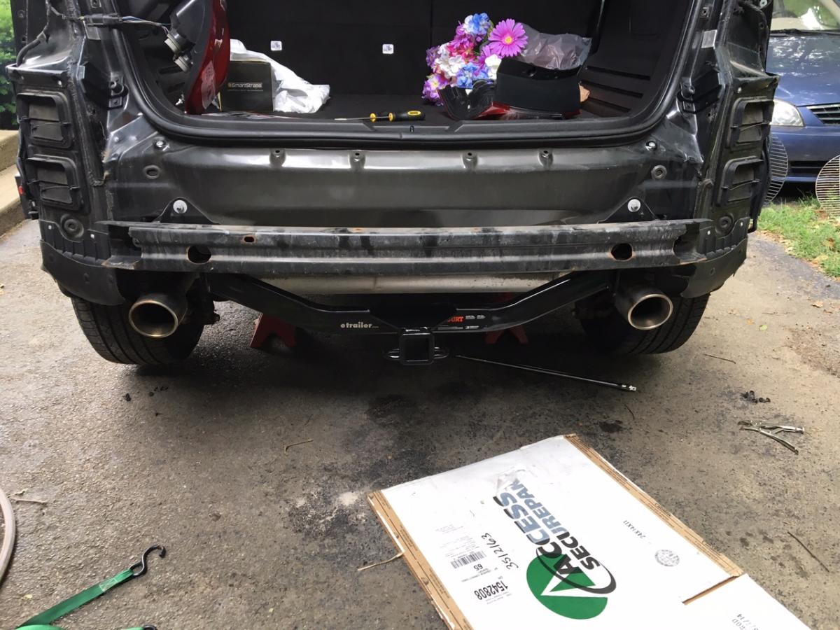

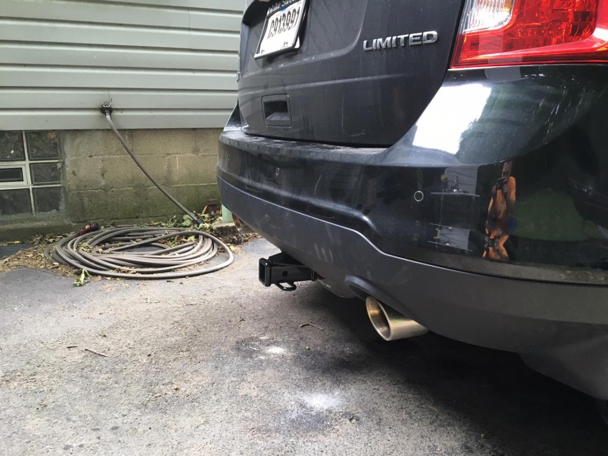

Vanyel1970 Posted June 9, 2016 Author Report Share Posted June 9, 2016 (edited) Hey all Just an update for you all on my 13 Limited Hitch Install. I set out today to install this hitch that I got from etrailer for my Edge. There was a really nice install video for this hitch on their website but I'll tell you when it came time to fish the carriage bolts through the end of the frame rail on my installation they would not fit. I ended up having to remove the taillights, rear bumper cover and rear bumper itself to get the carriage bolts in. Once that was done the hitch went in relatively easy. I will say that removing the bumper cover is a bit of a pain because the little plastic drop screws holding the upper portion strip and do not easily come out. Once removed though installing the bolts is easy and the hitch itself is awkward but doable with help and with a floor jack. In the one picture the RED circle shows how big the end frame hole really is and the YELLOW circle shows how small the passageway is to route the carriage bolts. I just removed the bumper itself to have open access to the inside frame rail. Van Etrailer order information 2013 Ford Edge Curt Trailer Hitch Receiver Class III - 2" Code: C13067 Edited June 9, 2016 by Vanyel1970 Quote Link to comment Share on other sites More sharing options...
akirby Posted June 10, 2016 Report Share Posted June 10, 2016 They didn't fit through the hole in the frame rail? Did you fish the flat piece first by itself, then the bolt? I've done 2 of these on an escape and 2016 MKX and had no problems fishing the carriage bolts with the supplied wire. Quote Link to comment Share on other sites More sharing options...
Vanyel1970 Posted June 10, 2016 Author Report Share Posted June 10, 2016 The frame rail is actually obscured by the bumper and the hole to fish the flat piece and the bolt is rather small and only slightly wider than the flat piece itself. Ill admit that I tried doing them together and maybe that was my mistake. After an hour of NOT getting the pieces to fit and getting them stuck up in there I ran out of patience and just pulled the back end apart. Tedious yes but it made for a MUCH easier install. Quote Link to comment Share on other sites More sharing options...
akirby Posted June 10, 2016 Report Share Posted June 10, 2016 They won't fit together - it's very very tight. Did you use the supplied wires to pull the bolts out? I did have to remove the bumper but that was only two screws and about 90 seconds on the 2016 MKX. Quote Link to comment Share on other sites More sharing options...
