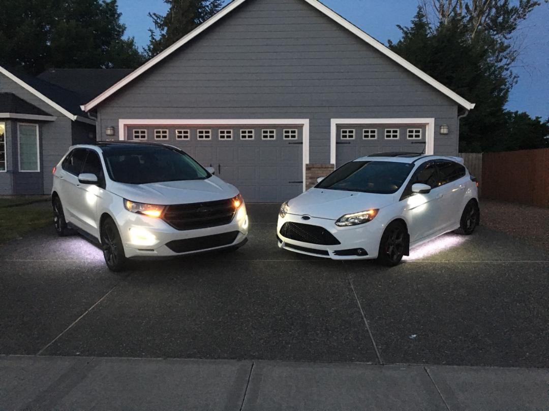

OnTheeEdge Posted May 15, 2016 Author Report Share Posted May 15, 2016 Here is a picture of both cars 1 Quote Link to comment Share on other sites More sharing options...

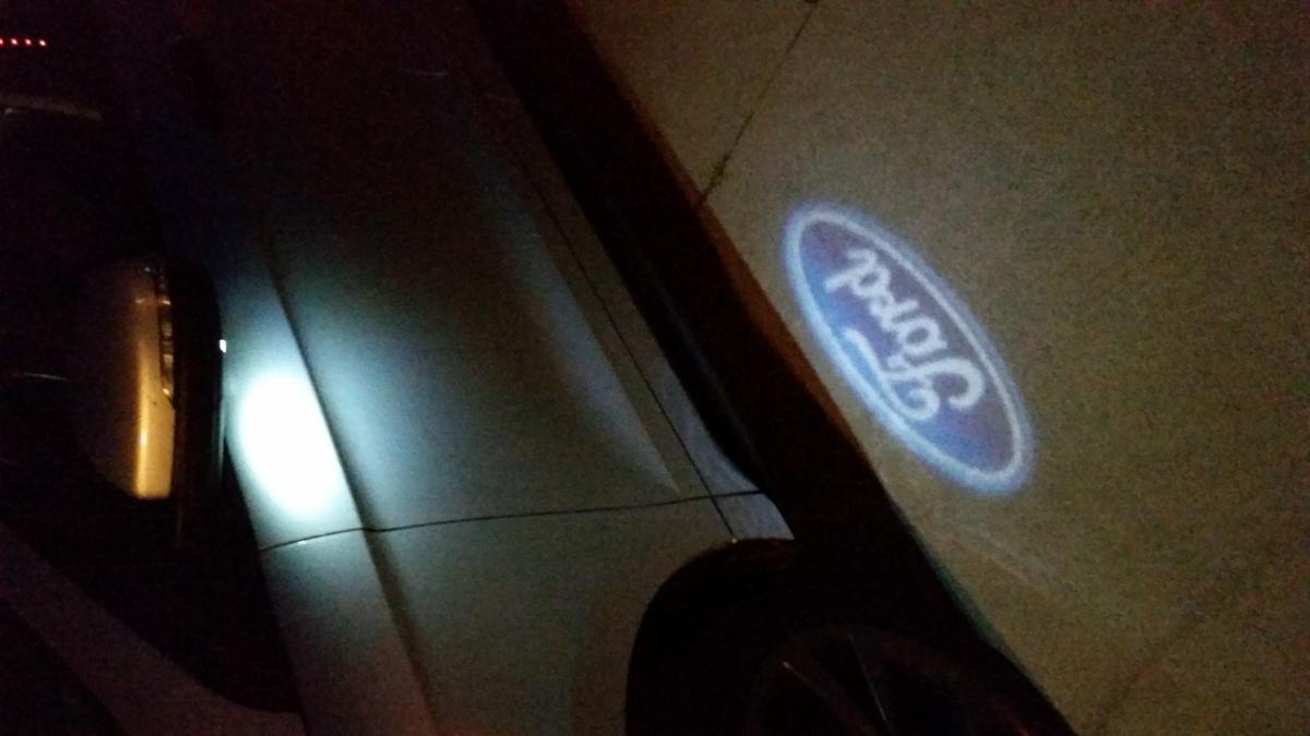

jmr061 Posted August 23, 2016 Report Share Posted August 23, 2016 (edited) Puddle lamps: http://www.ebay.com/itm/2pcs-LED-Rear-Side-Mirror-Door-Ghost-Lights-for-Ford-Edge-Explorer-Mondeo-Taurus-/322088158674 They didn't exactly fit, had to grind the metal housing down (built very well) and ended up gluing them in because they still wouldnt snap in. They look pretty awesome at night, however they are not as bright as OnTheeEdge's puddle lamps. 20160804_212901.jpg Another thing: https://www.amazon.ca/Wireless-Shadow-Welcome-Projector-Emblems/dp/B01CE8DLH4/ref=sr_1_1?s=electronics&ie=UTF8&qid=1470346027&sr=1-1&keywords=Wireless+No+Drill+Type+Led+Laser+Door+Shadow+Light+Welcome+Projector+Light+Led+Car+Door+Logo+Ghost+Shadow+Emblems+2pc+Packthese are slightly less cool but I have them on the back doors. Did you have any issues getting the OEM puddle lights out of the mirror housing? I played with mine a bit today and they wedge themselves after getting them out a bit. Thinking of getting some LED puddles to replace the OEM ones. Edited August 23, 2016 by jmr061 Quote Link to comment Share on other sites More sharing options...
