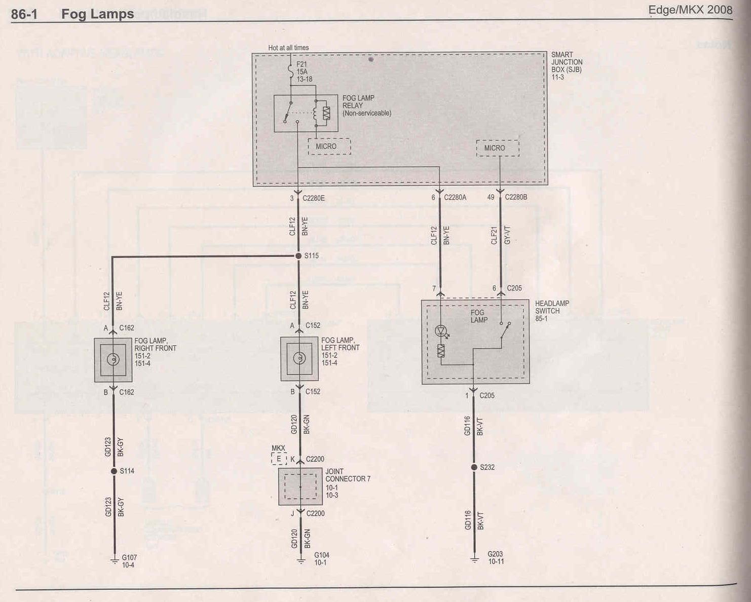

druck52 Posted March 31, 2008 Report Share Posted March 31, 2008 I looked at the wiring diagram for the fog lights and don't see any other modules needed, just a relay in the smart junction box(assuming all the other wiring is in the box for the fog lamps already, otherwise you'll need a new smart junction box). Quote Link to comment Share on other sites More sharing options...
SOMDTBSS Posted March 31, 2008 Report Share Posted March 31, 2008 druck52 said: I looked at the wiring diagram for the fog lights and don't see any other modules needed, just a relay in the smart junction box(assuming all the other wiring is in the box for the fog lamps already, otherwise you'll need a new smart junction box). When you replace the non fog light switch, with the new headlight/fog light switch, you can hear the relay clicking to turn on the fog lights. I could not however find the wires leading out of the Smart Junction Box to run to the fog lights. There is a Tan wire with a yellow stripe on the plug for the head lights switch, that same wire is also going into the SJB, I tapped into that wire, to use as the latching 12 Volt signal wire for the AEM relay harness I installed to use with the new OEM fog lights... I spent a lot of time in the foot well of the Edge attempting to locate the fog light wires and was unsuccessful...... Otherwise, it’s a pain in the ass!! But worth it, next I will probably be adding HID to the fog lights… Quote Link to comment Share on other sites More sharing options...

weasel Posted January 9, 2009 Report Share Posted January 9, 2009 Did you install a fuse in the appropriate location (F21, 15A fuse.) ?? Quote Link to comment Share on other sites More sharing options...
PrinzII Posted January 9, 2009 Author Report Share Posted January 9, 2009 Not yet. Quote Link to comment Share on other sites More sharing options...
weasel Posted January 12, 2009 Report Share Posted January 12, 2009 Here is a scan of the fog light wiring diagram. This should help a bit. Quote Link to comment Share on other sites More sharing options...
PrinzII Posted January 29, 2009 Author Report Share Posted January 29, 2009 Weasel: Thanks for the diagram. Quote Link to comment Share on other sites More sharing options...
weasel Posted January 31, 2009 Report Share Posted January 31, 2009 No problem. Quote Link to comment Share on other sites More sharing options...
