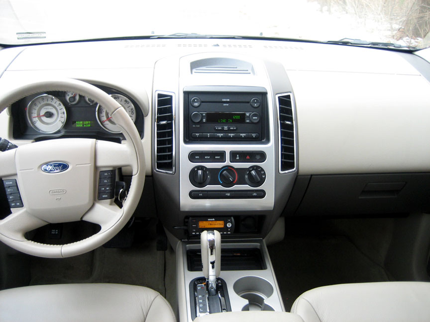

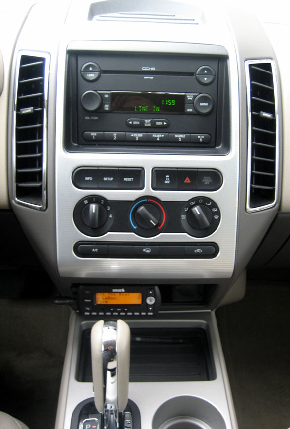

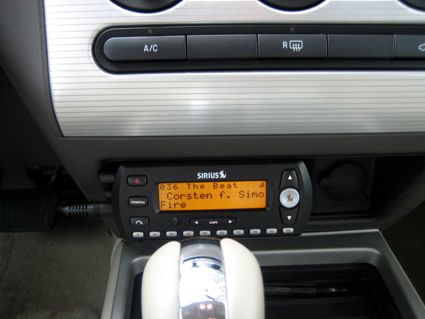

I have installed an aftermarket Sirius tuner to my stock radio. I have a 2007 Edge SEL. The install was very, very easy and it works really well. I've installed the unit just under the stereo and dash console...just to the left of the A/C input. I have the power cord, antenna cord and aux stereo plug all hidden under the shifter console running up to the gap in the center glovebox and into the AUX in and A/C plug inside the glovebox. The whole shifter console cover just snaps off so it really is a breeze to hide the wires.
The sound is tight...and the look is professional. The only problem I'm having is that the power for the Sirius tuner does NOT turn off when the vehicle is turned off. The power outlets are run in a mode which keeps them on at all times...so I have to manually the power off on the Sirius tuner itself each time I get out of the truck. I've forgotten to do this a few times and even after 2 days the tuner was still on and draining power from the battery!!! I'm going to look into having a professional change this so that all outlets get turned off once the key leaves the ignition like in most foreign cars.
Here is a basic picture of my setup. If you want to see more let me know...I can snap off a few more shots to show you the detail. I can also give you more specific instructions for the install if you need them.
