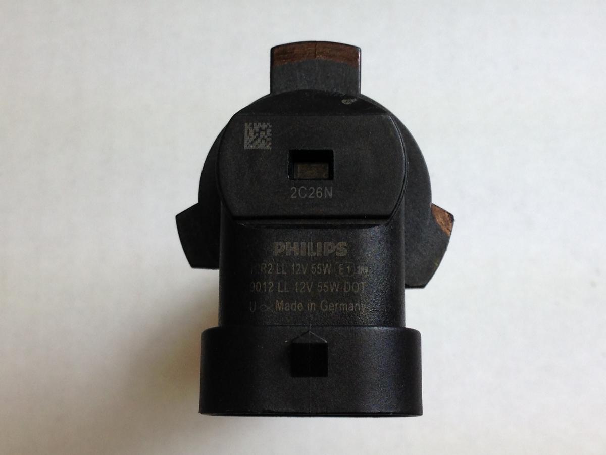

normcloutier Posted April 19, 2016 Report Share Posted April 19, 2016 I have some great pics of the back of the housings with HID installed. Also have a pic of what needs to be trimmed on the tab in order to rotate the lamp. I will post those tomorrow. Quote Link to comment Share on other sites More sharing options...

normcloutier Posted April 19, 2016 Report Share Posted April 19, 2016 Here are some pics of my install. The black sharpie shaded areas shown on the tabs of the OEM bulb are what need to be trimmed in order to be able to rotate the bulb and have it seat properly. If you installed the HID bulbs in the default position, you probably have shadows. Quote Link to comment Share on other sites More sharing options...
Vette10R Posted April 19, 2016 Author Report Share Posted April 19, 2016 So those are 9012 blubs in your pictures and I bought 9006 bulbs, are the tabs the same on the 9006? If they are the same then it looks like from your pictures that I need to trim the top center tab down about an 1/8 inch and notch the right tab so its the same size as the left tab. Does that sound right? Thanks for the pics! Quote Link to comment Share on other sites More sharing options...

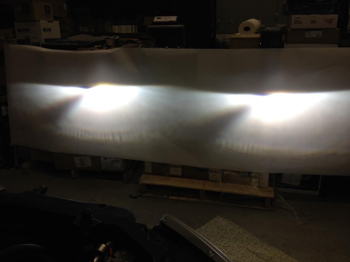

Nick Halstead Posted April 19, 2016 Report Share Posted April 19, 2016 Everything above the black is leaking into oncoming traffic. Also, lighting references should be done 50ft from a wall. Quote Link to comment Share on other sites More sharing options...
candurin Posted April 19, 2016 Report Share Posted April 19, 2016 The stock bulb is an HIR2 bulb, which is a 9012 pattern/size. There are 9012 aftermarket size HID bulbs (two/three years ago there was not, which is why we used 9006 or 9005 bulbs). I (and many others) have used 9006 size kits. Some have been able to "wrench" the 9006 bulbs into the OEM socket with no issues and others have had to modify the top tab to fit. There is a very slight and subtle difference in the 12 o'clock tab on the two bulbs: http://store.candlepower.com/mohirbuba.html http://www.motorfiend.com/mobile/9012-Replacement-HID-Bulbs-30000K-Extreme-Blue/ Quote Link to comment Share on other sites More sharing options...
