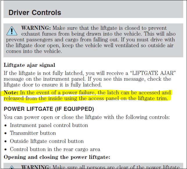

omar302 Posted April 9, 2016 Report Share Posted April 9, 2016 Never thought about it myself, but a very important issue. I also keep my charging cables next to the spare wheel. Just checked the Owners Manual & there seems to be a way, will need to see it in car to confirm. 1 Quote Link to comment Share on other sites More sharing options...

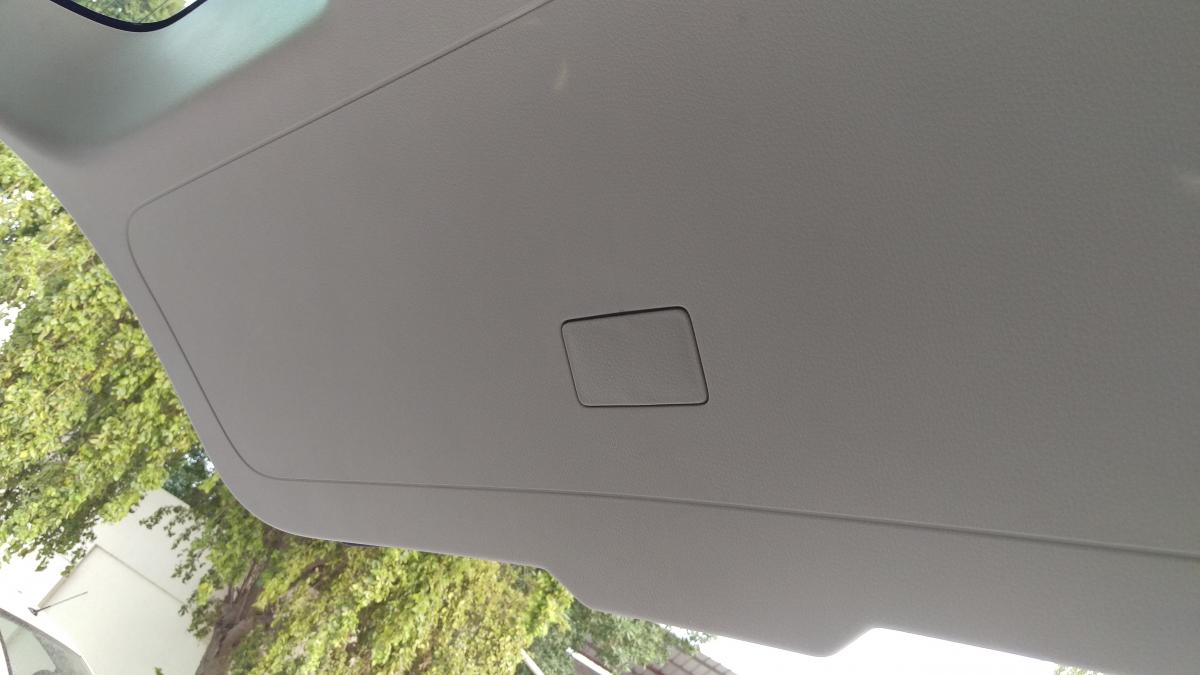

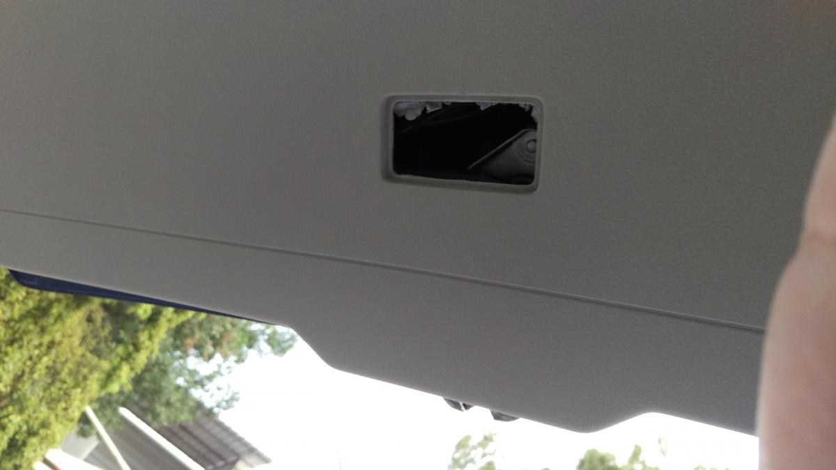

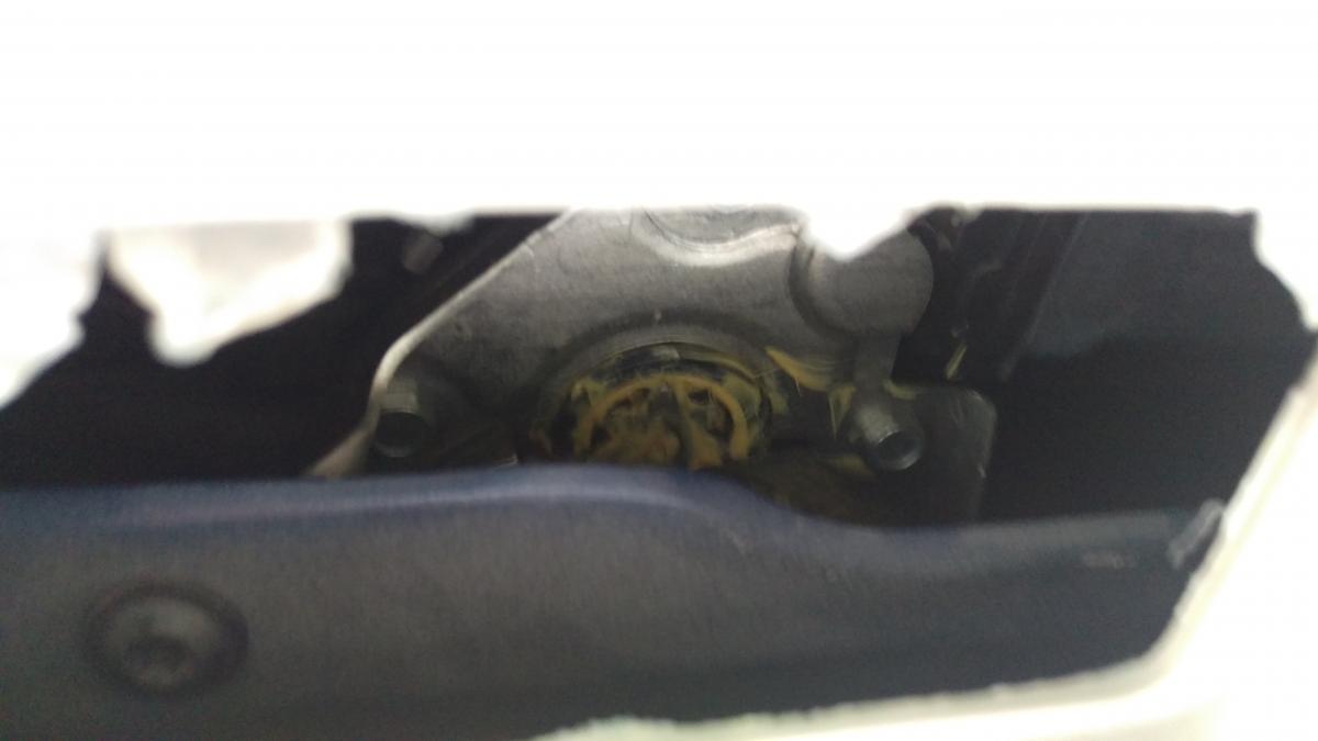

WWWPerfA_ZN0W Posted April 9, 2016 Report Share Posted April 9, 2016 Manual Latch Release for Power Liftgate To manually open the power liftgate, due to power latch failure, remove the latch access cover located on the lower center of the liftgate trim panel. Reach in and down on the right side of the latch and push down on the manual latch release lever. 2012 Edge Power Liftgate Operational Details.pdf 2 Quote Link to comment Share on other sites More sharing options...

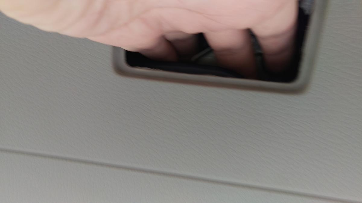

omar302 Posted April 9, 2016 Report Share Posted April 9, 2016 (edited) Checked it out today & took some photos. Just note that its all filled up with grease. Edited April 9, 2016 by omar302 1 Quote Link to comment Share on other sites More sharing options...
