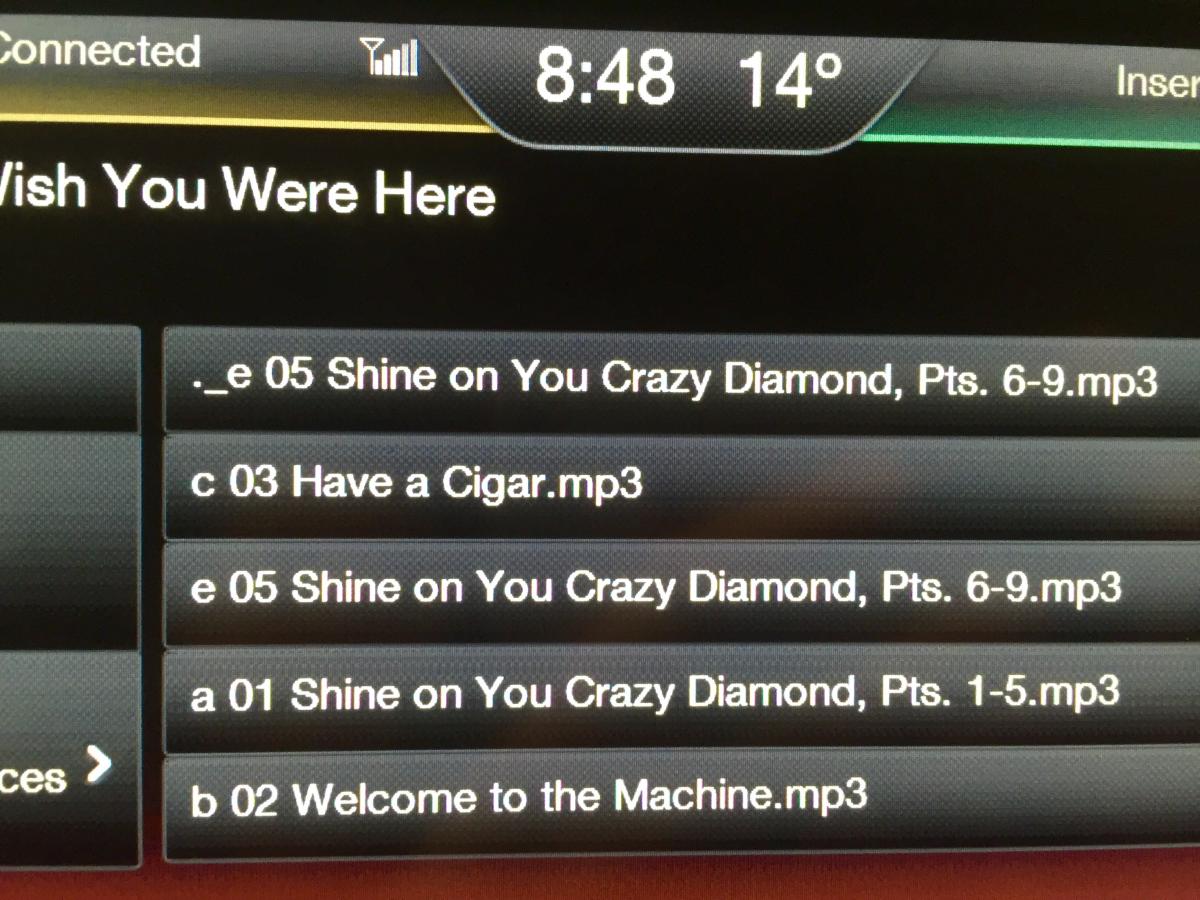

Asi Yacobovitch Posted April 5, 2016 Report Share Posted April 5, 2016 Hey, I've got a USB with hundreds of albums attached to Myford Touch, all mp3's and as far as I can tell, all got a correct tag (using TagEditor on Mac). For some weird reason, all (!) the tracks are in Alphabetic order and not by track number. How can I arrange it to play an album as intended to by played ? Cheers for your help. Quote Link to comment Share on other sites More sharing options...

akirby Posted April 5, 2016 Report Share Posted April 5, 2016 Based on a google search, I think the answer is it uses the ID3 Tag called "Track" to order the songs. If this tag is null or 0, then all bets are off, but it looks like SYNC then alphabetizes the songs according to the "Title" tag. And make sure Shuffle is off. Quote Link to comment Share on other sites More sharing options...
TheWizard Posted April 6, 2016 Report Share Posted April 6, 2016 My experience has been that the system ignores the track field in the MP3 tags. I expect the OP is finding the same thing because it would seem logical that the track number would be the controlling information yet it's not working for him. Creating playlists is a fairly simple process that can be mostly automated using freely available software. I use Playlist Creator 3.6.2 which allows drag-and-drop creation of playlists as well as creating playlists from folders. Quote Link to comment Share on other sites More sharing options...
