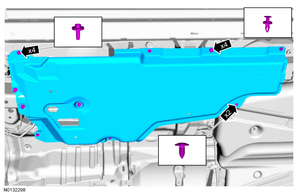

mcali6301 Posted April 5, 2016 Author Report Share Posted April 5, 2016 Thanks for the feedback! Under the car, on the driver's side there is a plastic panel that seems loose. What does this panel cover? And under what category would I find it under on fordparts.com Quote Link to comment Share on other sites More sharing options...
WWWPerfA_ZN0W Posted April 5, 2016 Report Share Posted April 5, 2016 (edited) In the FSM, it is called the Aero Shield, and it is held in place by 4 bolts, 4 trim pins, and 2 push pins. To install, tighten to 10 Nm (89 lb-in). Likely find it in Emissions Components along with the Vapor Canister. Might be these two, but I can't tell 4 sure: FORD OEM Exterior-Air Deflector Left BT4Z7811398B FORD OEM Exterior-Air Deflector Right BT4Z7811398A Edited April 5, 2016 by WWWPerfA_ZN0W 2 Quote Link to comment Share on other sites More sharing options...
mcali6301 Posted April 5, 2016 Author Report Share Posted April 5, 2016 Yup, that's it! Thanks! I'll be inspecting this first since it is loose and making some noise although not sure if it's the noise I'm hearing.. Quote Link to comment Share on other sites More sharing options...

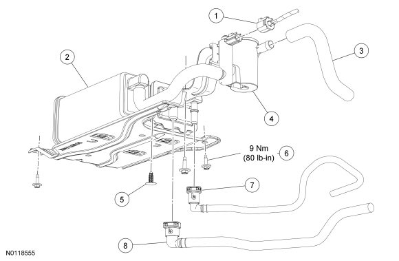

mcali6301 Posted April 22, 2016 Author Report Share Posted April 22, 2016 On 4/5/2016 at 7:10 PM, WWWPerfA_ZN0W said: In the FSM, it is called the Aero Shield, and it is held in place by 4 bolts, 4 trim pins, and 2 push pins. To install, tighten to 10 Nm (89 lb-in). Likely find it in Emissions Components along with the Vapor Canister. Might be these two, but I can't tell 4 sure: FORD OEM Exterior-Air Deflector Left BT4Z7811398B FORD OEM Exterior-Air Deflector Right BT4Z7811398A Is this aero shield covering emmisions components? What exactly is this covering? I'm thinking that something on the other side of this shield is loose. Quote Link to comment Share on other sites More sharing options...
Larry Posted April 23, 2016 Report Share Posted April 23, 2016 Check gas tank shield. The shield on my 13 SEL rattled. I stuck a piece of hard foam rubber between tank and shield. I found the rattle by lying under car a tapping on anything that I thought would move. Larry Quote Link to comment Share on other sites More sharing options...

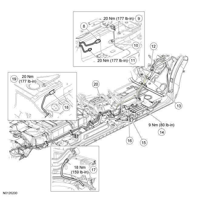

WWWPerfA_ZN0W Posted April 23, 2016 Report Share Posted April 23, 2016 Evaporative Emission CanisterItem Part Number Description 1 — Evaporative Emission (EVAP) canister vent solenoid electrical connector (part of 14A005) 2 9E857 EVAP canister 3 — Fuel vapor tube (part of 9S327) 4 9G676 EVAP canister vent solenoid/dust separator 5 W705681 EVAP canister pin-type retainer 6 W710330 EVAP canister bolt (3 required) 7 — Fuel vapor tube-to- EVAP canister quick connect coupling (part of 9S284) 8 — Fuel vapor tube assembly-to- EVAP canister quick connect coupling (part of 9S284) Fuel Vapor Tube AssemblyItem Part Number Description 1 N811781 Fuel tank strap bolt (4 required) 2 9092 Fuel tank strap (2 required) 3 9002 Fuel tank Item Part Number Description 1 14A464 Fuel Tank Pressure (FTP) sensor electrical connector 2 — Fuel tank fuel vapor tube assembly-to-fuel pump module quick connect coupling (part of 9D667) 3 — Fuel tank tube-to-fuel tank fuel vapor tube quick connect coupling (part of 9002) 4 — Fuel tank fuel vapor tube assembly-to-Evaporative Emission (EVAP) canister fuel vapor tube assembly quick connect coupling (part of 9D667) 5 9D667 Fuel tank fuel vapor tube assembly 6 — EVAP canister fuel vapor tube assembly-to-canister quick connect coupling (part of 9D667) 7 9D667 EVAP canister fuel vapor tube assembly Fuel Lines — 3.5L, 3.7L - Middle Fuel Supply and Evaporative Emission (EVAP) Vapor TubesItem Part Number Description 8 — Middle brake tube-to-front brake tube fitting (part of 9S284) 9 — Front brake tube-to-middle brake tube fitting (part of 9C296) 10 — Front brake tube-to-middle brake tube fitting (part of 9C296) 11 — Middle brake tube-to-front brake tube fitting (part of 9S284) 12 — Front EVAP vapor tube quick connect coupling-to-middle EVAP vapor tube (part of 9J280) 13 — Front fuel supply tube quick connect coupling-to-middle fuel supply tube (part of 9J280) 14 W707137 Bundle retainer clip nut (2 required) 15 — Middle EVAP vapor tube quick connect coupling-to- EVAP canister (part of 9S284) 16 — Middle EVAP vapor tube quick connect coupling-to- EVAP canister (part of 9S284) 17 — Middle brake tube fitting-to-rear brake hose (part of 9S284) 18 — Middle brake tube fitting-to-rear brake tube fitting (part of 9S284) 19 — Rear brake tube fitting-to-middle brake tube fitting (part of 2265) 20 9S284 Middle fuel supply and EVAP vapor tube assembly AERO/EVAP Shields 1 Quote Link to comment Share on other sites More sharing options...
mcali6301 Posted April 25, 2016 Author Report Share Posted April 25, 2016 On 4/23/2016 at 4:54 PM, WWWPerfA_ZN0W said: Evaporative Emission Canister 2012 Ford Edge Evaporative Emission Canister.JPG Item Part Number Description 1 — Evaporative Emission (EVAP) canister vent solenoid electrical connector (part of 14A005) 2 9E857 EVAP canister 3 — Fuel vapor tube (part of 9S327) 4 9G676 EVAP canister vent solenoid/dust separator 5 W705681 EVAP canister pin-type retainer 6 W710330 EVAP canister bolt (3 required) 7 — Fuel vapor tube-to- EVAP canister quick connect coupling (part of 9S284) 8 — Fuel vapor tube assembly-to- EVAP canister quick connect coupling (part of 9S284) Fuel Vapor Tube Assembly 2012 Ford Edge Fuel Vapor Tube Assembly 1.JPG Item Part Number Description 1 N811781 Fuel tank strap bolt (4 required) 2 9092 Fuel tank strap (2 required) 3 9002 Fuel tank 2012 Ford Edge Fuel Vapor Tube Assembly 2.JPG Item Part Number Description 1 14A464 Fuel Tank Pressure (FTP) sensor electrical connector 2 — Fuel tank fuel vapor tube assembly-to-fuel pump module quick connect coupling (part of 9D667) 3 — Fuel tank tube-to-fuel tank fuel vapor tube quick connect coupling (part of 9002) 4 — Fuel tank fuel vapor tube assembly-to-Evaporative Emission (EVAP) canister fuel vapor tube assembly quick connect coupling (part of 9D667) 5 9D667 Fuel tank fuel vapor tube assembly 6 — EVAP canister fuel vapor tube assembly-to-canister quick connect coupling (part of 9D667) 7 9D667 EVAP canister fuel vapor tube assembly Fuel Lines — 3.5L, 3.7L - Middle Fuel Supply and Evaporative Emission (EVAP) Vapor Tubes 2012 Ford Edge 3-5-7L Middle Fuel Supply and Evaporative Emission (EVAP) Vapor Tubes.JPG Item Part Number Description 8 — Middle brake tube-to-front brake tube fitting (part of 9S284) 9 — Front brake tube-to-middle brake tube fitting (part of 9C296) 10 — Front brake tube-to-middle brake tube fitting (part of 9C296) 11 — Middle brake tube-to-front brake tube fitting (part of 9S284) 12 — Front EVAP vapor tube quick connect coupling-to-middle EVAP vapor tube (part of 9J280) 13 — Front fuel supply tube quick connect coupling-to-middle fuel supply tube (part of 9J280) 14 W707137 Bundle retainer clip nut (2 required) 15 — Middle EVAP vapor tube quick connect coupling-to- EVAP canister (part of 9S284) 16 — Middle EVAP vapor tube quick connect coupling-to- EVAP canister (part of 9S284) 17 — Middle brake tube fitting-to-rear brake hose (part of 9S284) 18 — Middle brake tube fitting-to-rear brake tube fitting (part of 9S284) 19 — Rear brake tube fitting-to-middle brake tube fitting (part of 2265) 20 9S284 Middle fuel supply and EVAP vapor tube assembly AERO/EVAP Shields 2012 Ford Edge Aero Shield.JPG 2012 Ford Edge 2.0T EVAP Shield.JPG Thanks!! Unfortunately these components had nothing do with the rattle. Quote Link to comment Share on other sites More sharing options...
