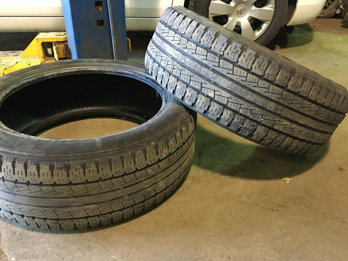

lpgao Posted April 27, 2016 Author Report Share Posted April 27, 2016 Ā The stability system is designed to account for that, it doesn't actually know how much grip can be produced by each tire, it just reacts to what's actually happening. But it is true that mixing tires is never a good idea, it can ruin the steering and handling feel of the vehicle and make it more difficult to control in an emergency. Ā To lpgao - if you're going to put two tires in storage, I'd put the two Pirelli's in storage (or sell them) and put all 4 of the same tires on the vehicle. Also sounds like you have not been rotating them, so make sure you do that every 10K km or so. Keep in mind that even in storage, tires do age. If you keep those things in your basement for 5 years they will not be as good as they are now. Many thanks Waldo for your great information. Ā I never did rotation on my tires as I have my Edge just 2.5 years, and it has total 160k KM. Now I put 4 new Goodyear tires. I attached photo here to show everybody the difference between fron and rear tires. Front one is done, but rear one is still prety good. Quote Link to comment Share on other sites More sharing options...
