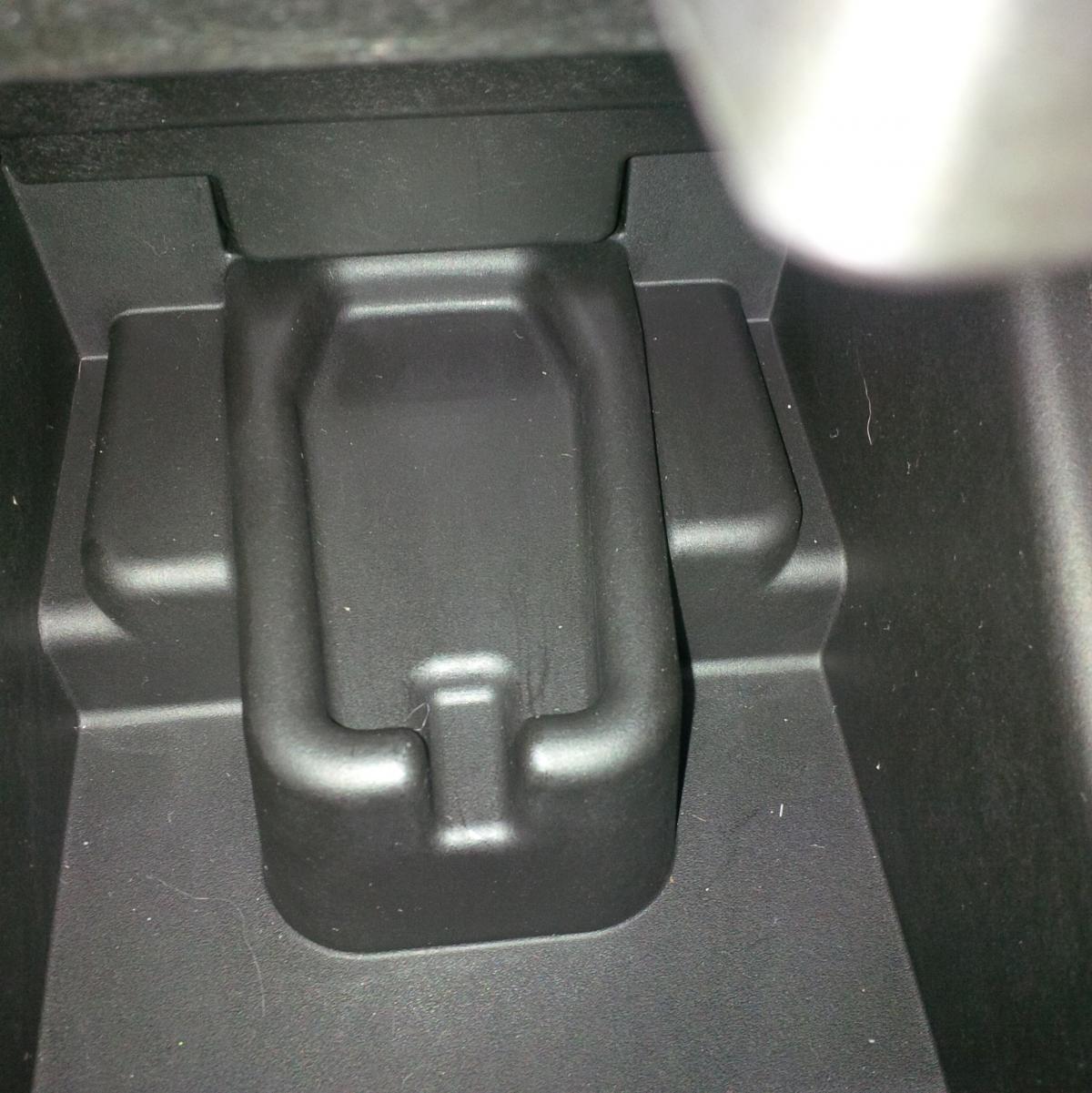

ONEDGE16 Posted March 18, 2016 Report Share Posted March 18, 2016 enigma-2 you are correct, it's on the front inside under the 12V plug. You can feel it with your hand but can't really see it. here's a picture: Quote Link to comment Share on other sites More sharing options...
kevin_ramoutar Posted March 20, 2016 Author Report Share Posted March 20, 2016 I did find this at first. I tried following the steps to program the fob but it hasnt worked. I will give it a try again and see what happens. If not I'll have to go into the dealer and see what's up. Thanks a lot guys! Quote Link to comment Share on other sites More sharing options...

ONEDGE16 Posted March 21, 2016 Report Share Posted March 21, 2016 If you translate the position indicated in the manual to the actual position in the car, vertical to horizontal, I would say the keys on the fob should be facing up. Quote Link to comment Share on other sites More sharing options...
kevin_ramoutar Posted March 22, 2016 Author Report Share Posted March 22, 2016 If you translate the position indicated in the manual to the actual position in the car, vertical to horizontal, I would say the keys on the fob should be facing up. that's correct, the fob is actually facing up not to the back of the car. Quote Link to comment Share on other sites More sharing options...
enigma-2 Posted March 23, 2016 Report Share Posted March 23, 2016 It's a wonderful anyone can figure it out. Here's how it reds "With the buttons facing the rear of your vehicle and the key ring up, place the intelligent access key into the backup slot." Glad you figured it out. Quote Link to comment Share on other sites More sharing options...
AlienLAV Posted May 6, 2016 Report Share Posted May 6, 2016 Used the documented procedure from manual to find the default keyless code by using both fobs. Found that, the correct fob position is "buttons up" and key ring facing the rear - if looking into the image from post #6, the void in the backup slot for the ring is perfectly visible, so that position did work for me. Another thing is that I've put the actual keys into each fob just to have fobs ready for 'manual' operation. (did not try if "buttons down" does work as well ) Quote Link to comment Share on other sites More sharing options...
