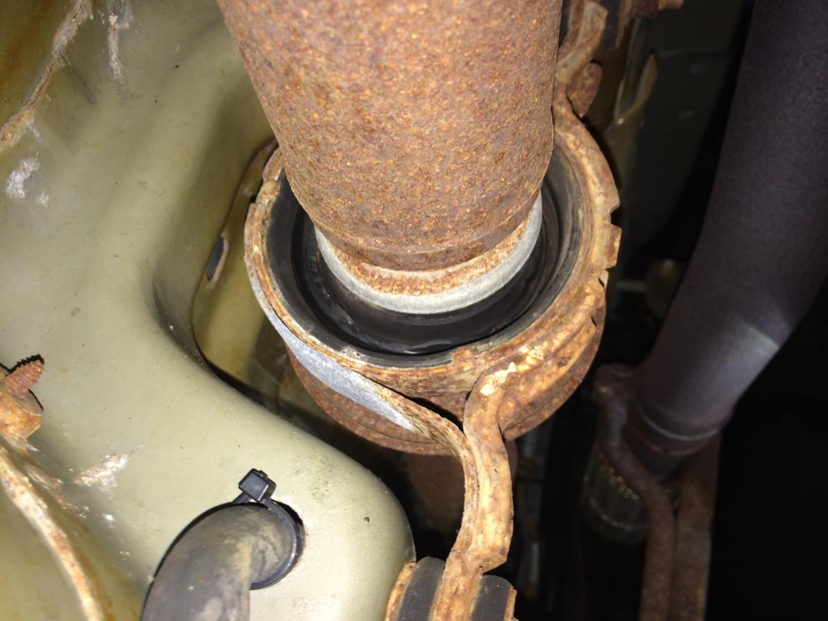

DunePearlEdge Posted February 25, 2016 Report Share Posted February 25, 2016 (edited) I noticed some slight vibration in the drivetrain of my 2007 AWD Edge. Upon closer inspection it looks like the both center driveshaft bearings need replacement - I can see daylight around the black rubber (see the attached picture) and I can wiggle them around with my hand. I assume this isn't normal. Can these bearings be replaced without replacing the entire driveshaft? You can see the two bearings in this fancy drivetrain image: http://pictures.topspeed.com/IMG/crop/200704/2007-ford-edge-17_600x0w.jpg Edited February 25, 2016 by DunePearlEdge Quote Link to comment Share on other sites More sharing options...
WWWPerfA_ZN0W Posted February 25, 2016 Report Share Posted February 25, 2016 (edited) AFAIK, the bearings are not available separately, and the entire driveshaft has to be replaced. EDIT: You can see the replaceable parts shown in the diagram here - http://www.fordparts.com/Commerce/PartDetail.aspx?n=6W4iwebleh9XZ15RsNneJQ%3d%3d&id=344361698&m=2&search=true&year=2007&make=Ford&model=Edge Edited February 25, 2016 by WWWPerfA_ZN0W Quote Link to comment Share on other sites More sharing options...

WWWPerfA_ZN0W Posted February 26, 2016 Report Share Posted February 26, 2016 Jiffy Lube??? Umm ... no. If looking for just the bearings, you will have to make your Edge the guinea pig. Measure the OEM part & find equivalents at, say, NAPA. For a new driveshaft, best to go to a Ford dealer like AutoNation (should be one close to you). Used driveshafts (unknown quality) are available via EBay vendors, should be available at large junkyards like LKQ. Quote Link to comment Share on other sites More sharing options...
DunePearlEdge Posted February 26, 2016 Author Report Share Posted February 26, 2016 Thanks again. I'm going to order the 2 piece/single bearing driveshaft for the 2008+ models from Benny. In the mean time I will remove the shaft so I can operate the car vibration free until the new shaft arrives. Quote Link to comment Share on other sites More sharing options...
