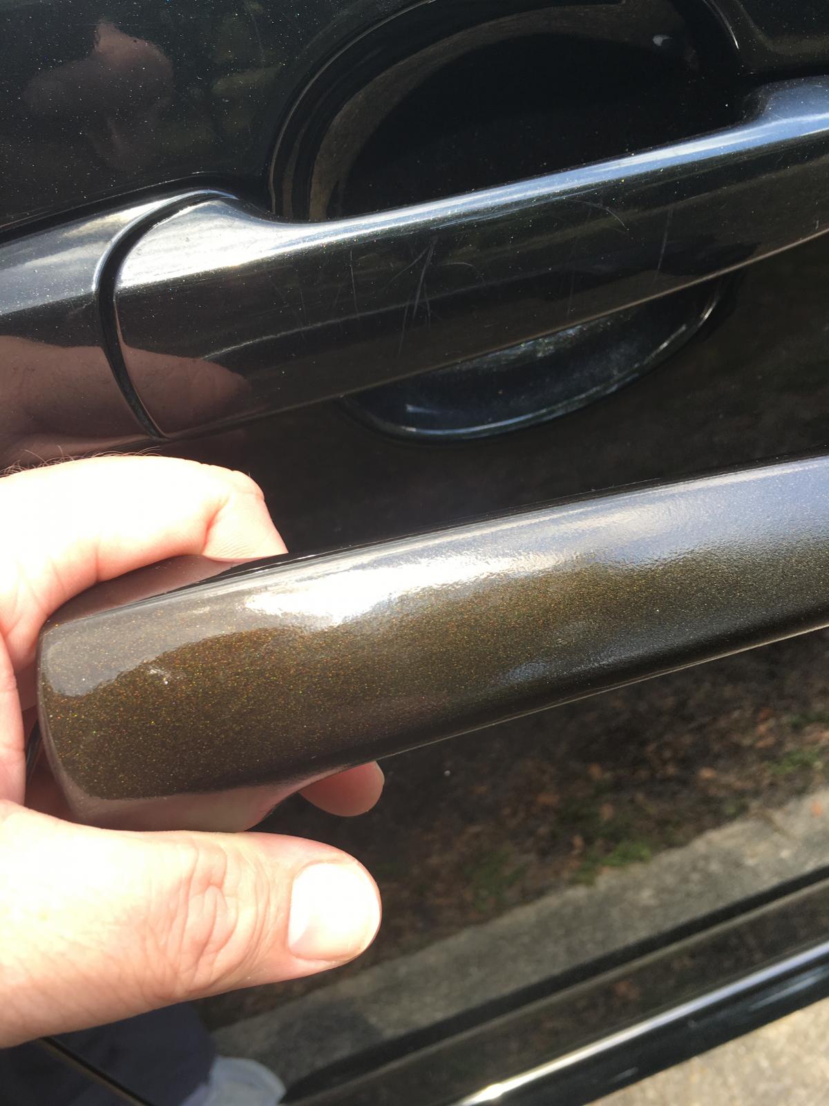

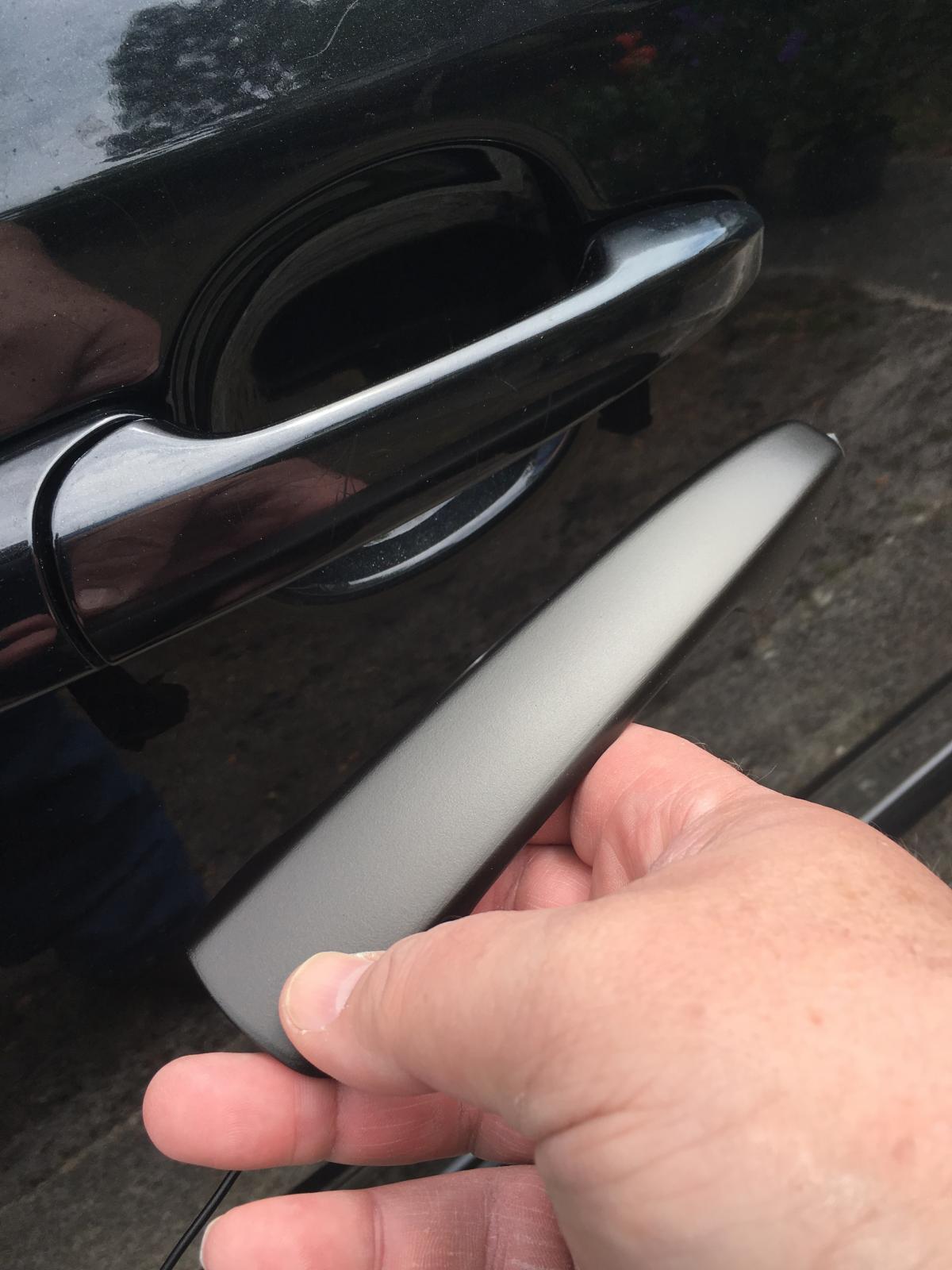

Lifeisabeach Posted May 6, 2016 Author Report Share Posted May 6, 2016 (edited) Ok, update with photos. The base coat, when in the sun next to the car, was more metallic in look than matte. In fact, it's exactly as the paint description is... tuxedo black metallic. But it didn't have that gloss, which is what the clearcoat is for anyway. AutomotiveTouchup's site does say to expect a dull finish before applying the clearcoat, so it was as should be expected. Here's one of the handles with just the base coat. So far, looking good. So my neighbor applied the clearcoat next (3 coats of it). That definitely gave it the high gloss look as expected, and in the shade, it looked perfect. Then I put the handle up to the car, with good lighting on it. Gaaaaaaaaahhhhh! What the freaking freak? It's not supposed to look greenish bronze like that! I emailed AutomotiveTouchup asking what could have gone wrong here... no response. I'm totally disgusted. So I just got a quote from a reputable body shop here to get it done right, along with a hood scratch that needs to be done, and I'm going to have the bumper holes patched and repainted properly instead of settling on the plugs I'm using. There was a bit of scuffing to the bumper from the front plate holder that bugs me, so I just wanna git 'er done and be done with it. Edited May 6, 2016 by Lifeisabeach Quote Link to comment Share on other sites More sharing options...
