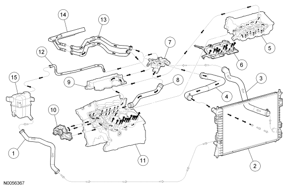

A] an air bubble or a clog somewhere in the system as you have already mentioned. The easiest test for flow is simply to check the temperature of the hoses (radiator and heater core) as the engine warms up with MAX HEAT on.

Coolant Flow Diagram, 3.5L
NOTE: Black arrows indicate hot, white arrows indicate cold.
Item Part Number Description
1 8C633 Lower degas bottle hose
2 8005 Radiator
3 8B273 Lower radiator hose
4 8B274 Upper radiator hose
5 6050 Cylinder head
6 6083 Cylinder head gasket
7 8A586 Thermostat housing
8 9N271 Heater inlet tube
9 9K461 Lower intake manifold
10 8501 Coolant pump
11 6010 Engine block
12 8W005 Upper degas bottle hose
13 18C553 Heater hose assembly
14 18B539 Heater core
15 8A080 Degas bottle
